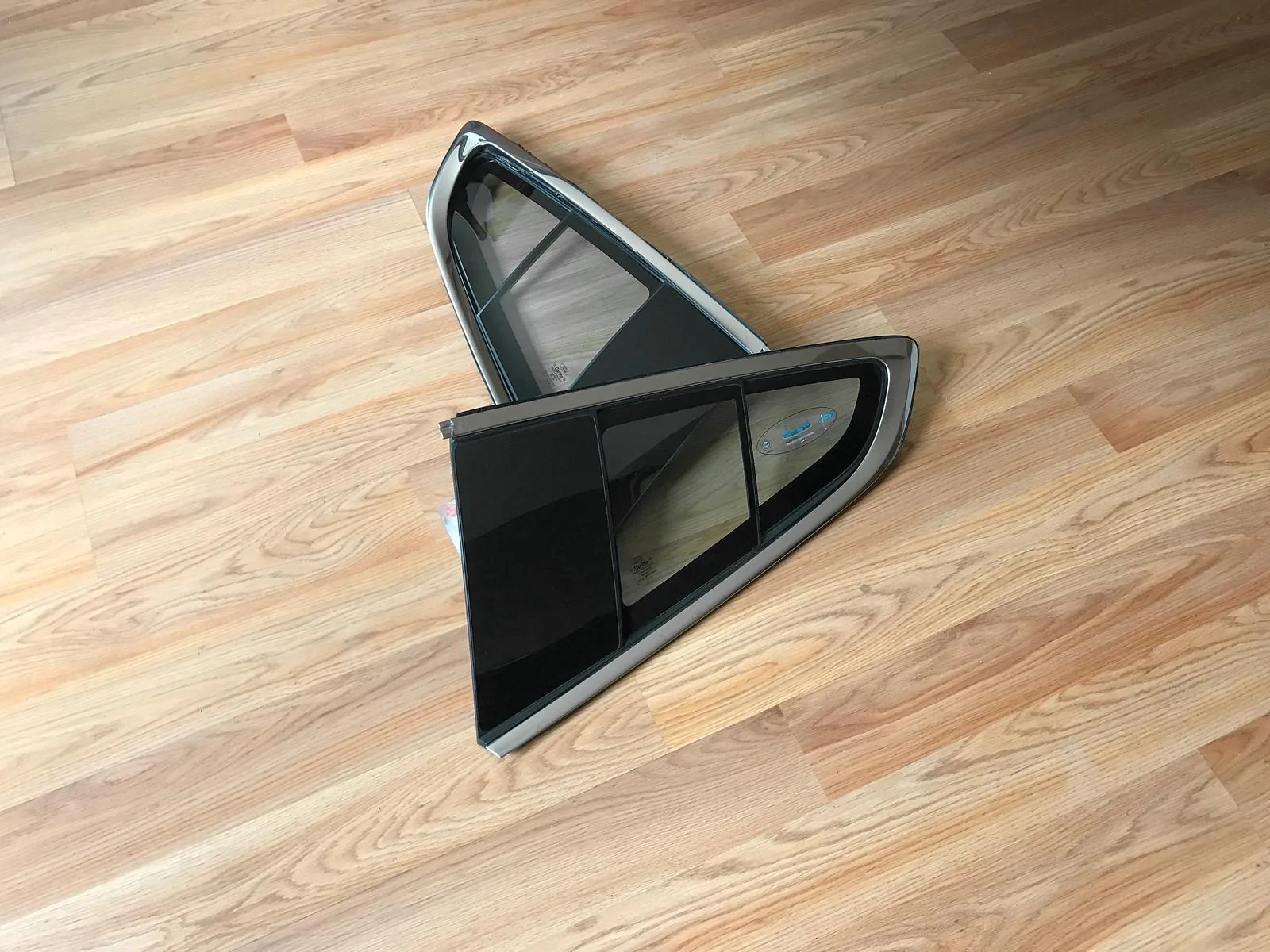

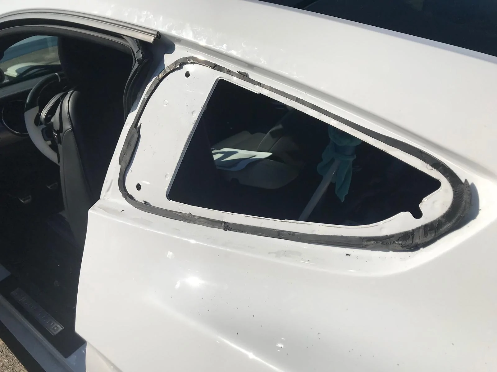

After hunting since pretty much day 1, I finally found LE windows a couple months ago. From what I know, you can't just buy them from Ford. Even if you had a VIN. Pretty sure I was told you need an RO and possibly core returns. Still, I found them anyway. Fast forward to the last couple of days, and I finally took the time to tackle this project.

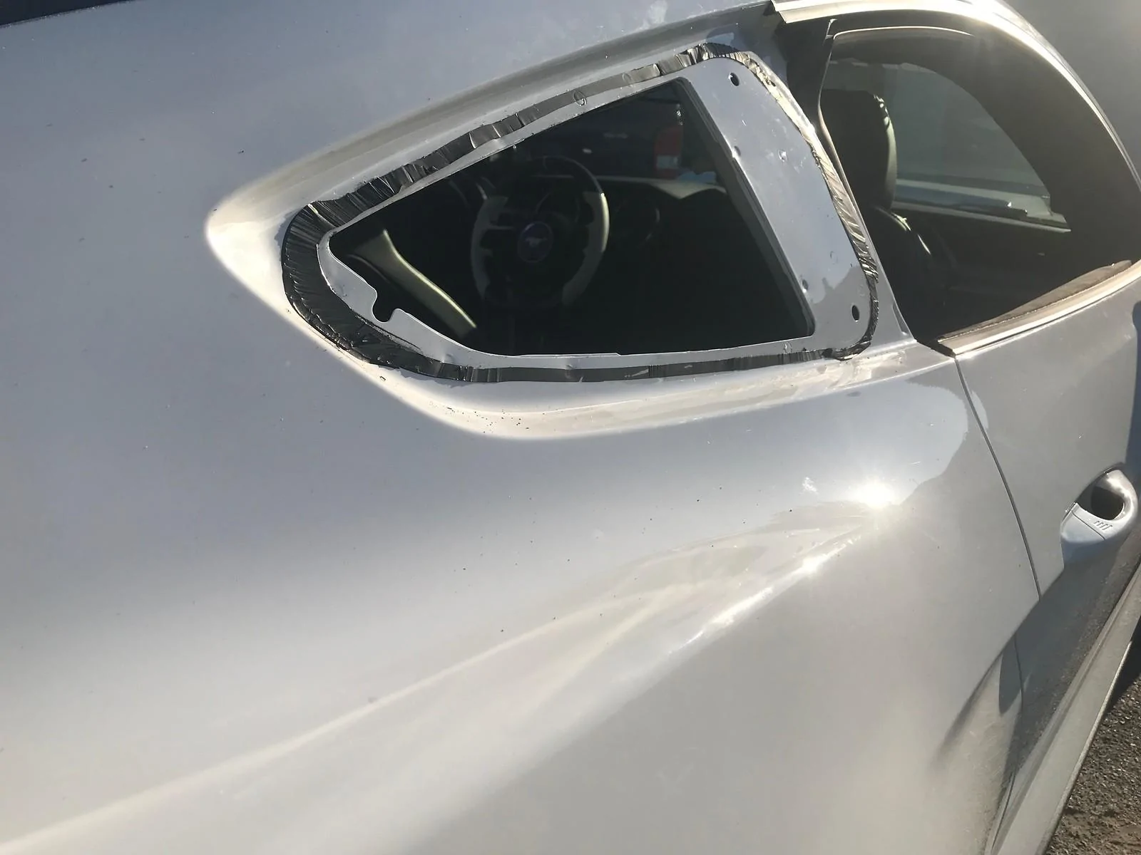

This is definitely not a project for the faint of heart. Obviously the rear section of interior needs to come out so you can gain access to the window. Just used hand tools to remove the window- feel like you have more control with a hand tool over power to make sure you don't scratch the hell out of the pinch weld. Side note- a second pair of hands does make getting the glass out a lot easier.

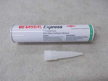

Mitchell suggests Betaseal Express for the job, which has a drive time of 1 hour. However, there's tons of urethanes and some of them are air bag safe in half that time. Once everything is prepped and ready to go, lay down your urethane, press in the windows and viola, it's starting to look like a car again.

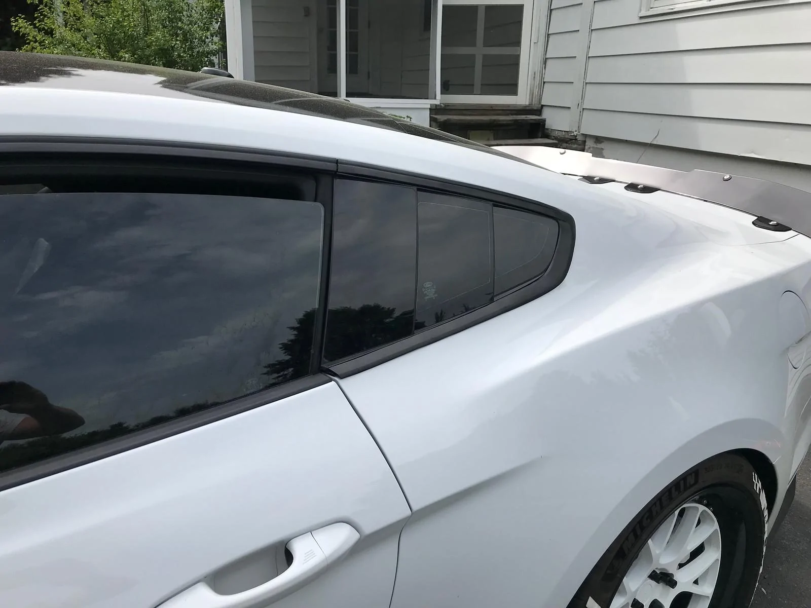

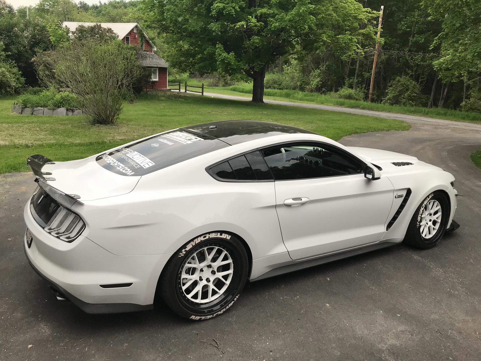

And what they look like in the car, trim-less

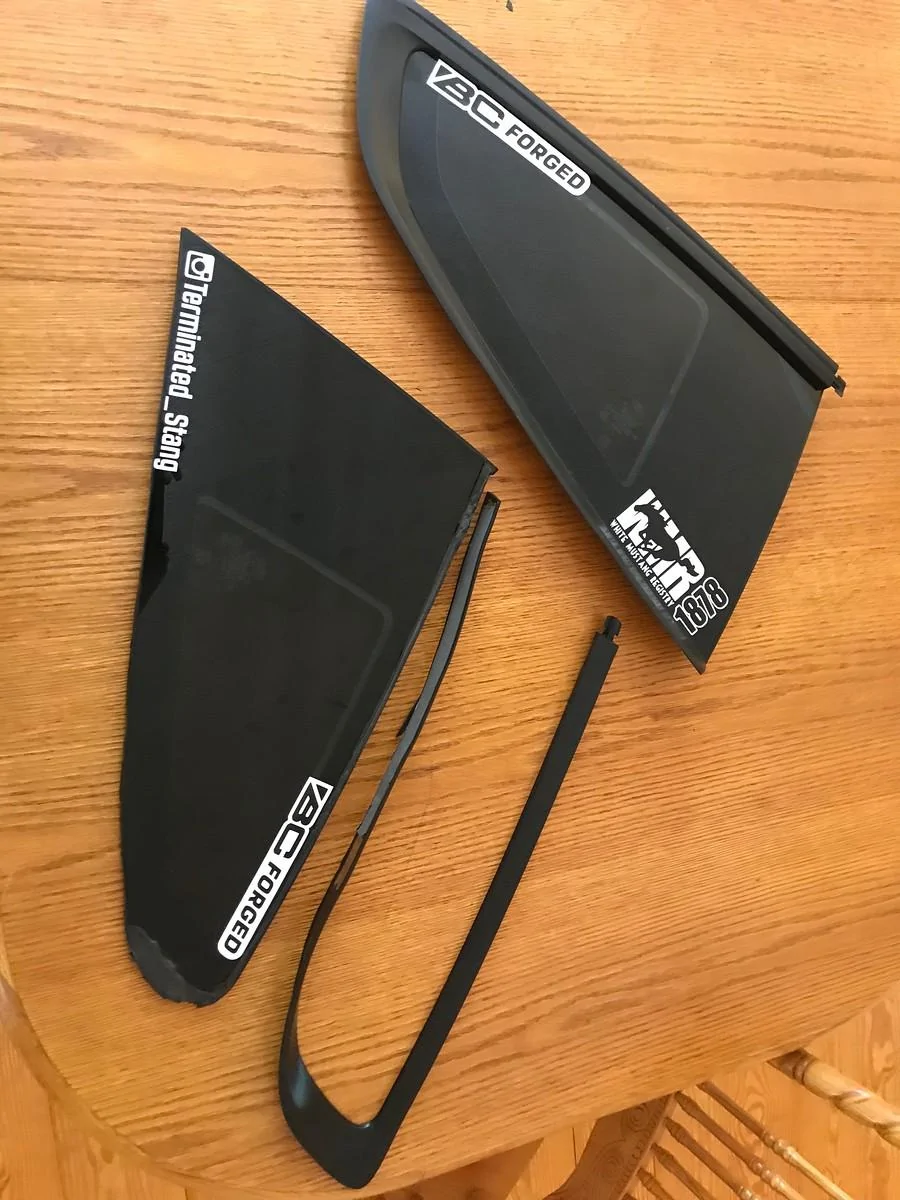

From this point, I decided to get the interior back in, then tackle the trim. Since I no longer needed my OE windows, they were the perfect donors for the trim.

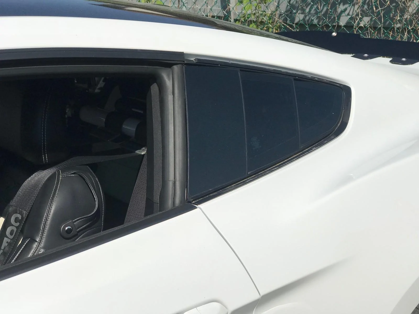

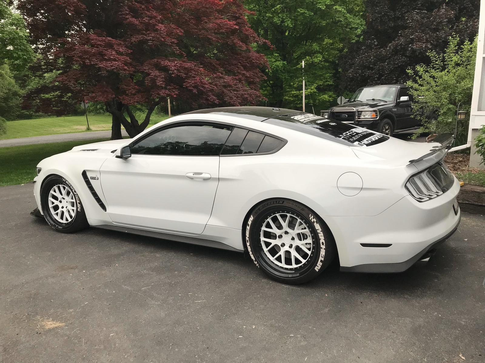

The rubber moulding does not just line up on the LE glass. It took some test fitting and modifying to get it there. However, once it's fitted it does look pretty good. Overall I'm pretty happy with the end result. The trim fits tight against the inner seal on the window- I'm going to mess around with it a bit more though and make it all "one piece", for an even cleaner appearance. It essentially matches the door's 2 piece belt trim.
And, the fruit of my labor...

Did you find them on eBay, LKQ or via a online scrap yard locator?
Did you have to cut the black surround off of your originals? I thought the original surround is molded to the window, one piece, and would not be able to be separated?

Thanks! Yeah, the originals are molded directly to the glass, so it had to be cut and then trimmed for the new windows
Got them from a scrap yard. Totaled out LE

Were the chrome trim pieces bonded to the original glass, or can they be removed and reinstalled? I am getting ready to do the install, but I am painting the chrome trim black to match the car.

The chrome is glued over the rubber gasket that surrounds the glass. You could try to remove the chrome, but most likely it will tear the rubber gasket. If even successfully getting the chrome separated, the rubber will have glue deposits and most likely be deformed after removing it if it did not tear first.
