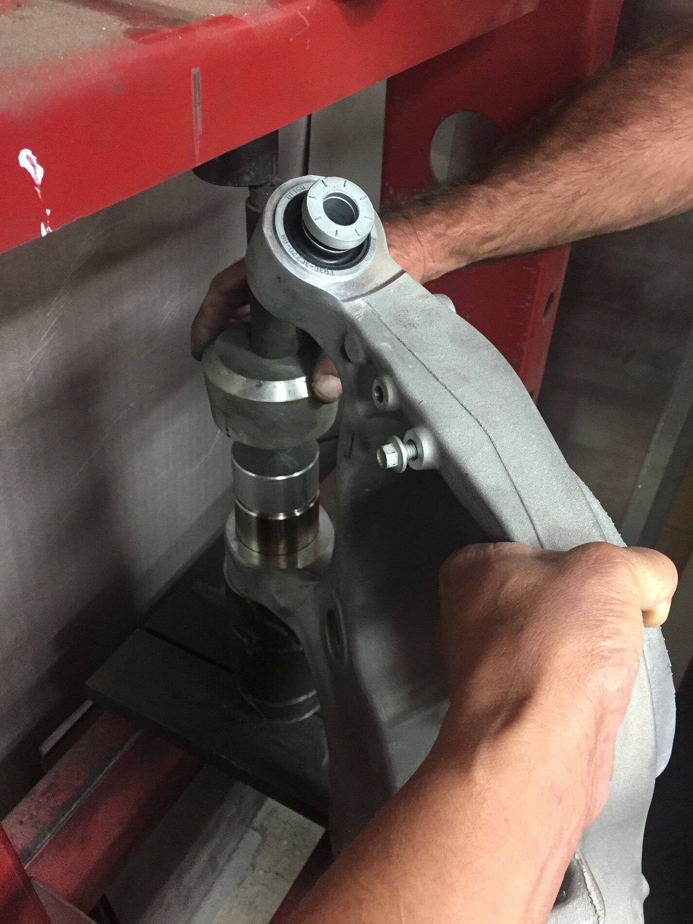

That would certainly be an easier install. When I did my bearings, I used my own shop press and arbor press insert to press out the inner sleeve and bushing from the shell (had to enlist the help of a buddy to finish the job of pressing out the outer shell and pressing in the Steeda bearing with a stronger press). There was still some residual rubber stuck to the wall of the shell, which could have been burned out very easily with a propane torch and then cleaned even further with a small wire wheel before lubing and inserting the new SuperPro bushings. This would of course only work if the SuperPro bushings are the same outer diameter as the factory shell. Definitely something to think about for those going down this road.
