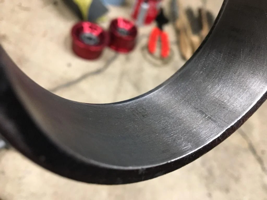

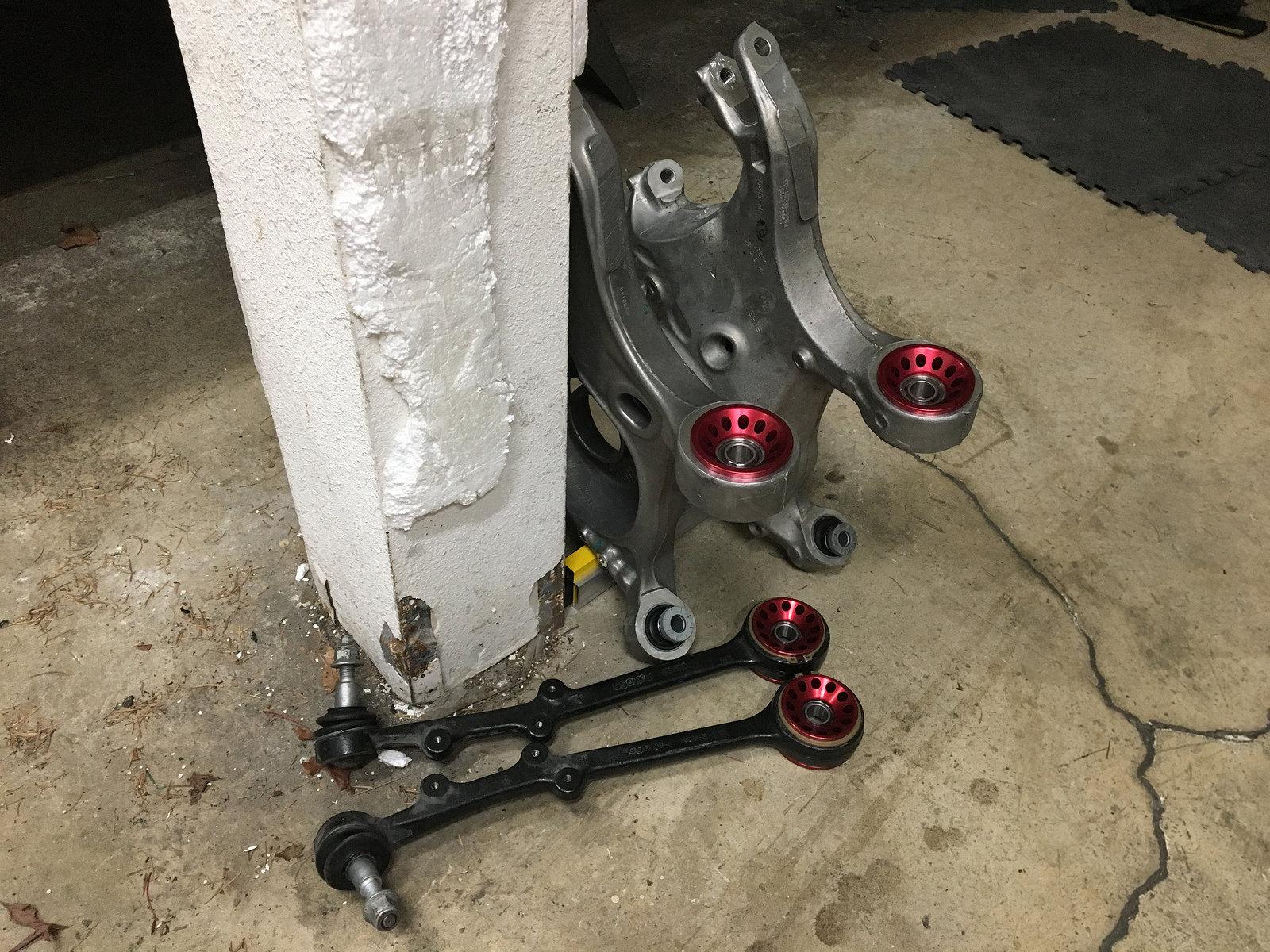

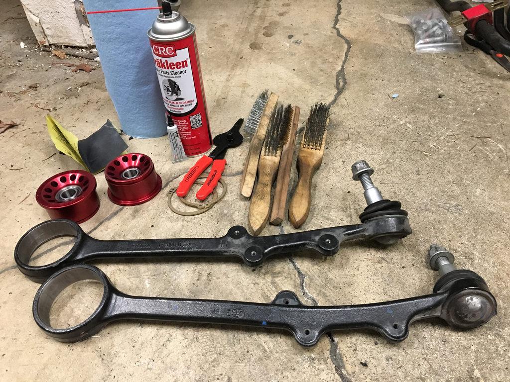

i just picked up the front/rear LCA monoball setup from cortex earlier this week.
first off - pressing those bushings out are a BITCH! i already knew that going in, but now i REALLY know. uggh....
haven't seen anybody post a step-by-step, but filip @ cortex gave me a good set of instructions on the fly to follow (he's hoping to have some up on the site in the near future). since both are slip-fit, you need to use some retaining compound for them to fully seat after about a 24 hour cure. rears were straight forward, but you need to use some elbow grease to get all the paint off the bore on the front LCA. keep at it with a wire brush until you get it all out, use some fine grit sandpaper to finish off, and then hit it with some brakleen. also, ensure you know how to get that snap ring on (and that you have a tool with enough range, these are BIG housings/rings), since the loctite sets pretty quickly (and you don't want to be fumbling with it after it's fully cured).
i'll have feedback in the near future, after i've got everything back on the car and out for my first competition on the new setup next weekend.

tough to isolate any one component (i literally took ALL the rubber out, all at once, among other things). also, i haven't had a chance to truly baseline them in competition (cold and wet today, decided to skip the event), but on the street thus far in synergy with everything else, they've exceeded my expectations. minimal NVH increase with more precise turn-in, and predictable movement both in and out of corners on-throttle (vs. "snappy" response due to suspension binding previously).
