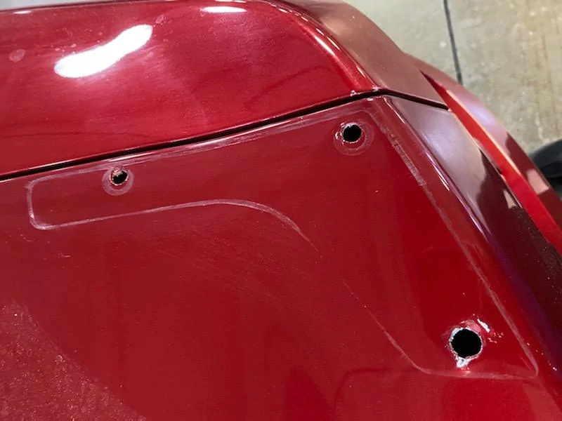

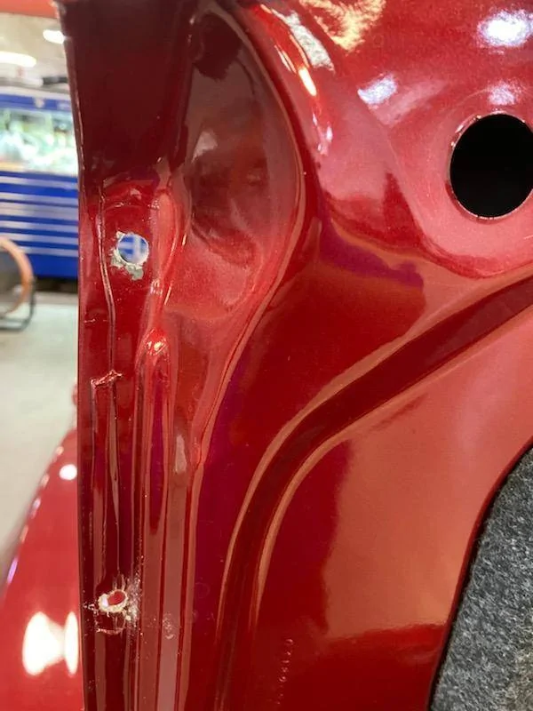

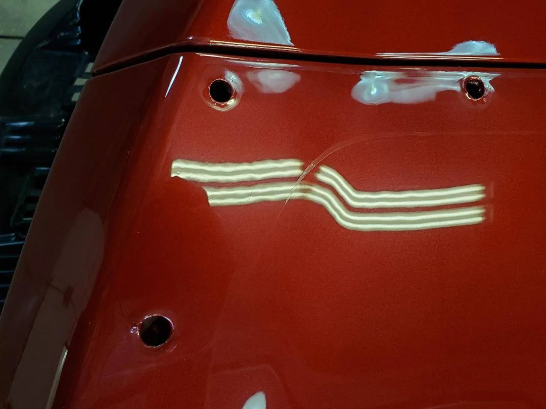

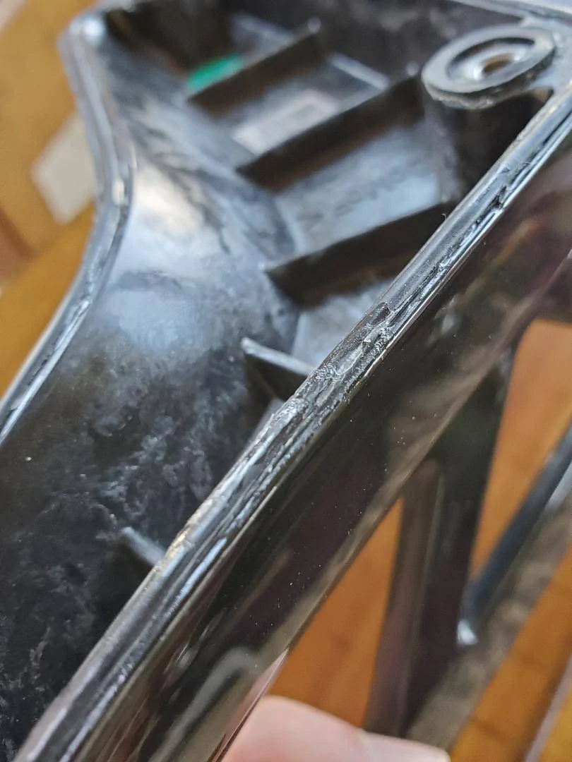

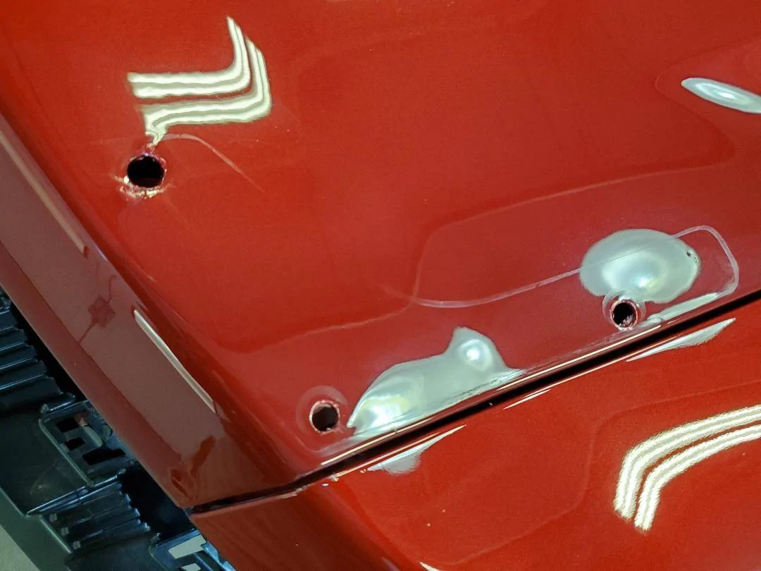

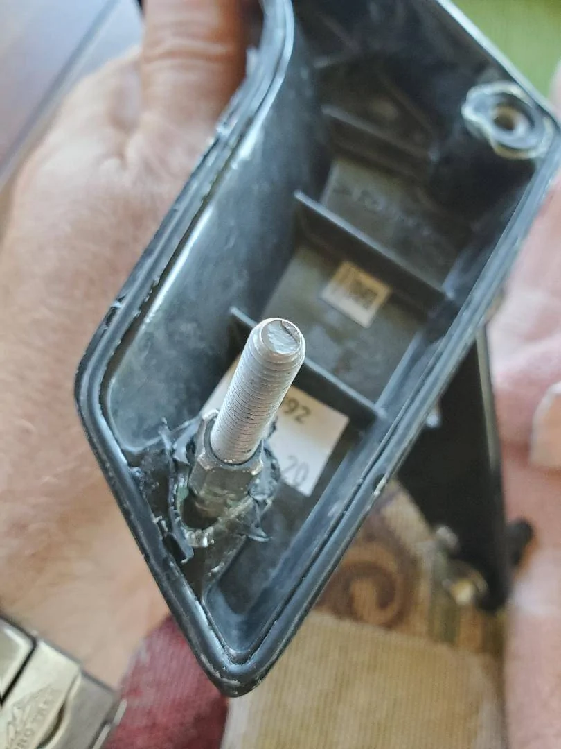

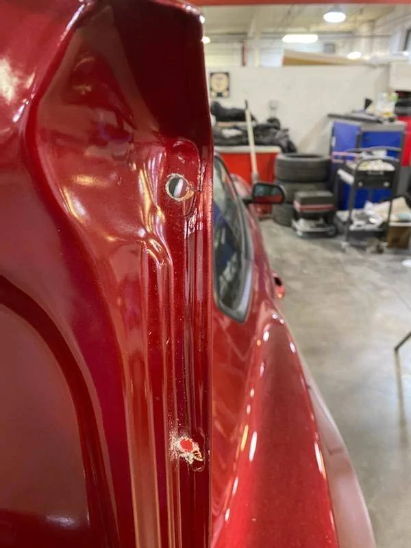

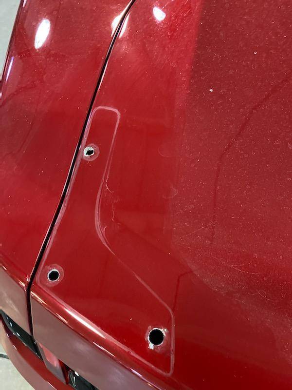

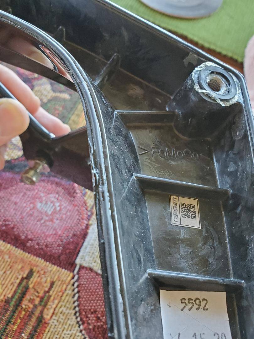

The body shop removed the wing and mounts from the deck lid. They found that the clearcoat was not properly allowed to cure before the wing mounts were installed (thank you Penske, good job!). I received photos of the wing mounts and the corrected deck lid today from the body shop.
They cleaned it up and polished it as best they could. They didn't want to go too far and go through what clear coat was left. I did not want them to repaint the deck lid so as to keep it original as it was delivered from the factory. The holes were treated and should not be a corrosion issue down the road. Its a real shame Penske did what they did. IMHO, they should not do the job, and Ford shouldn't offer the option if it cant be done right.
Attached are photos of the reworked deck lid and the mounts that have what appears to be clear coat stuck to the O ring. furthermore, the rubber washers that are associated with the inboard stud both appear to be damaged. I am seeking warranty replacements. It was discovered that you cannot buy the mounts by themselves through Ford. If you want the GT500 CFTP OEM wing mounts, you have to buy the whole $26,000 kit (wing, mounts, hardware).
So moving forward, the wing mounts and wing will not be installed back onto the car until the entire deck lid has been protected with Xpel so that there will be no more O ring to paint interaction.
Photos of deck lid after wing and mounts removed
Photos of deck lid that was reworked (painted around holes and polished)
