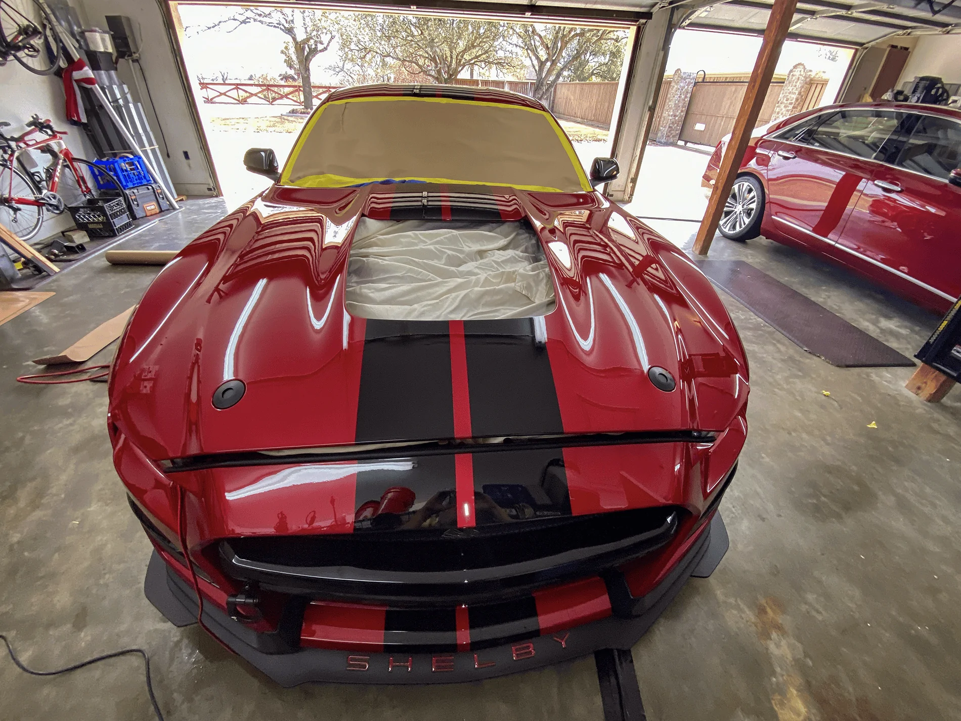

In preparation for paint correction #2 and applying a ceramic coating, I started to mask off my girl yesterday. Pulled the hood vent which will make things much easier but she looks pretty strange without it.

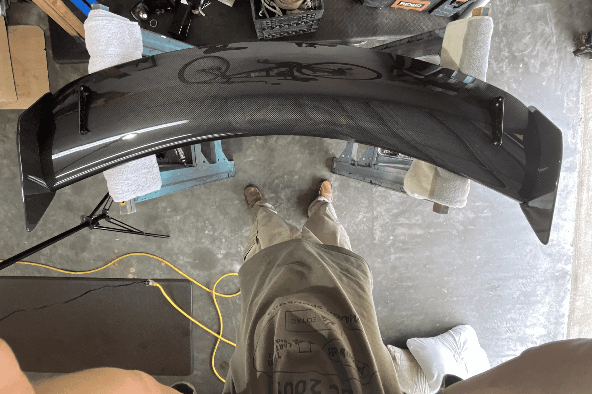

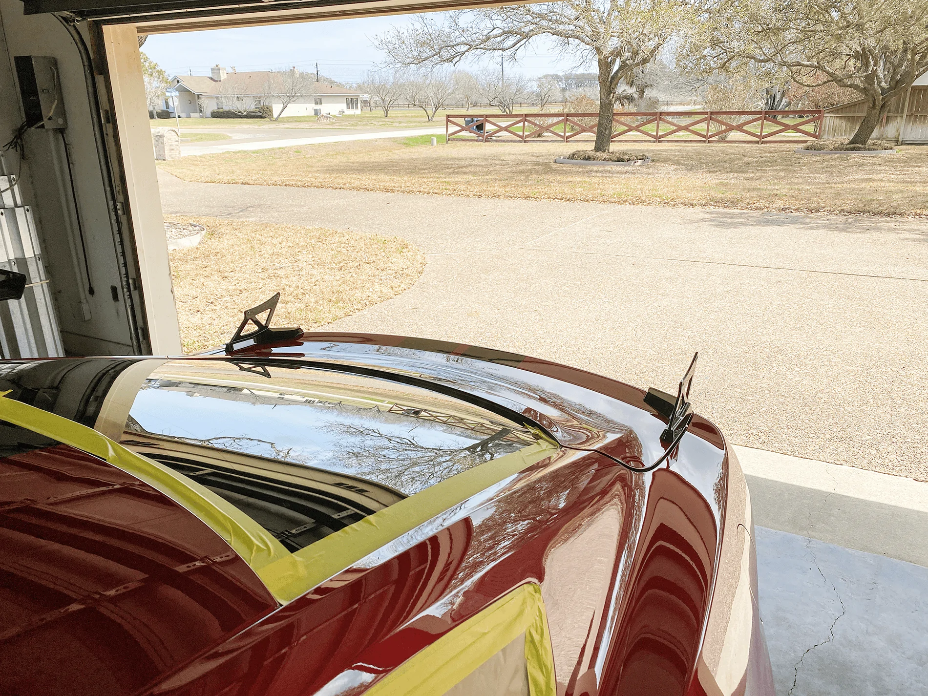

Then, I saw that I would have to remove the wing to get a polisher under it and the whole process was pretty funny. Had pillows on the deck lid, wife at the far end, pulled the last two bolts and off she came. We laughed at the absence of weight! I bet the thing doesn't even tip the scales at two pounds.

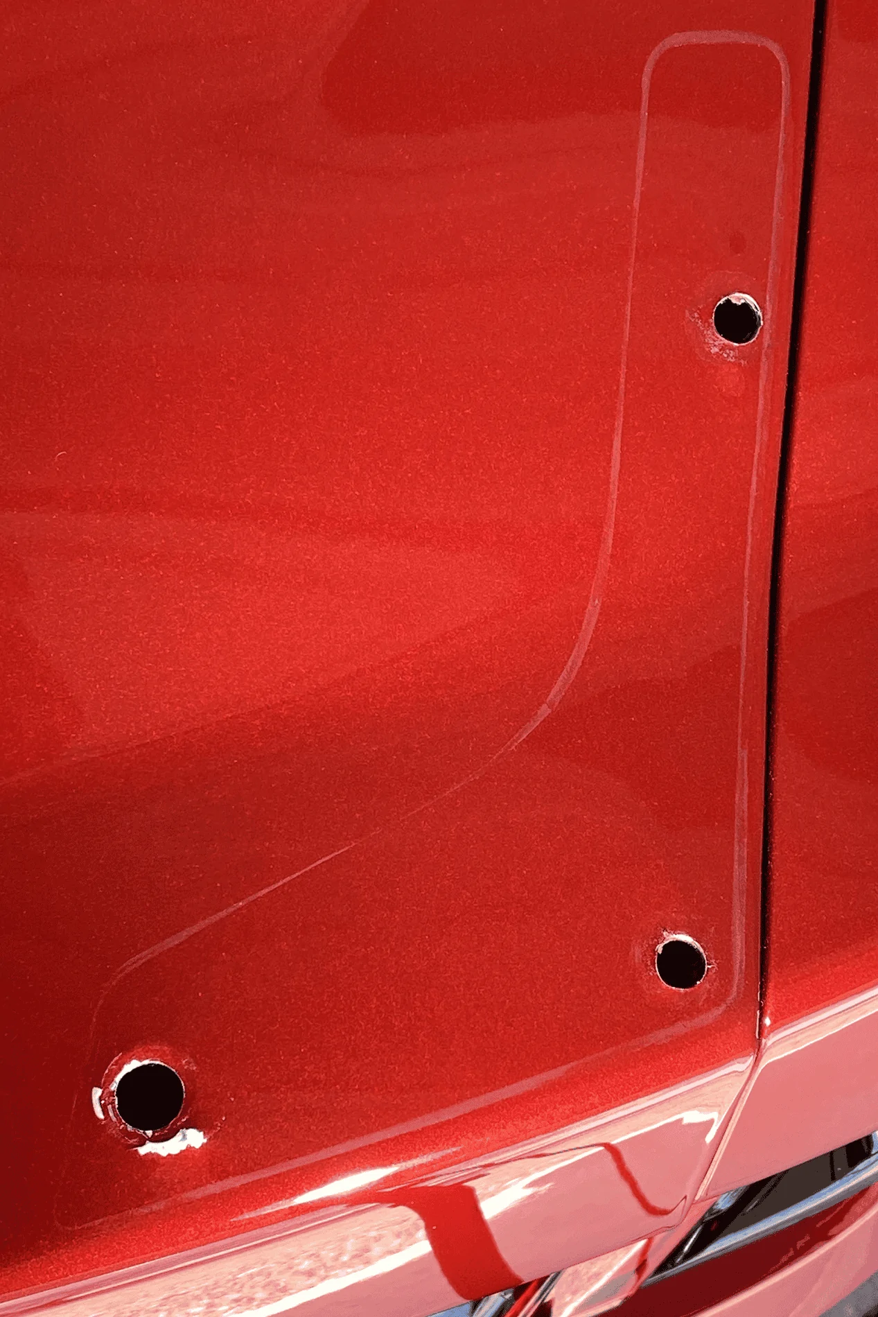

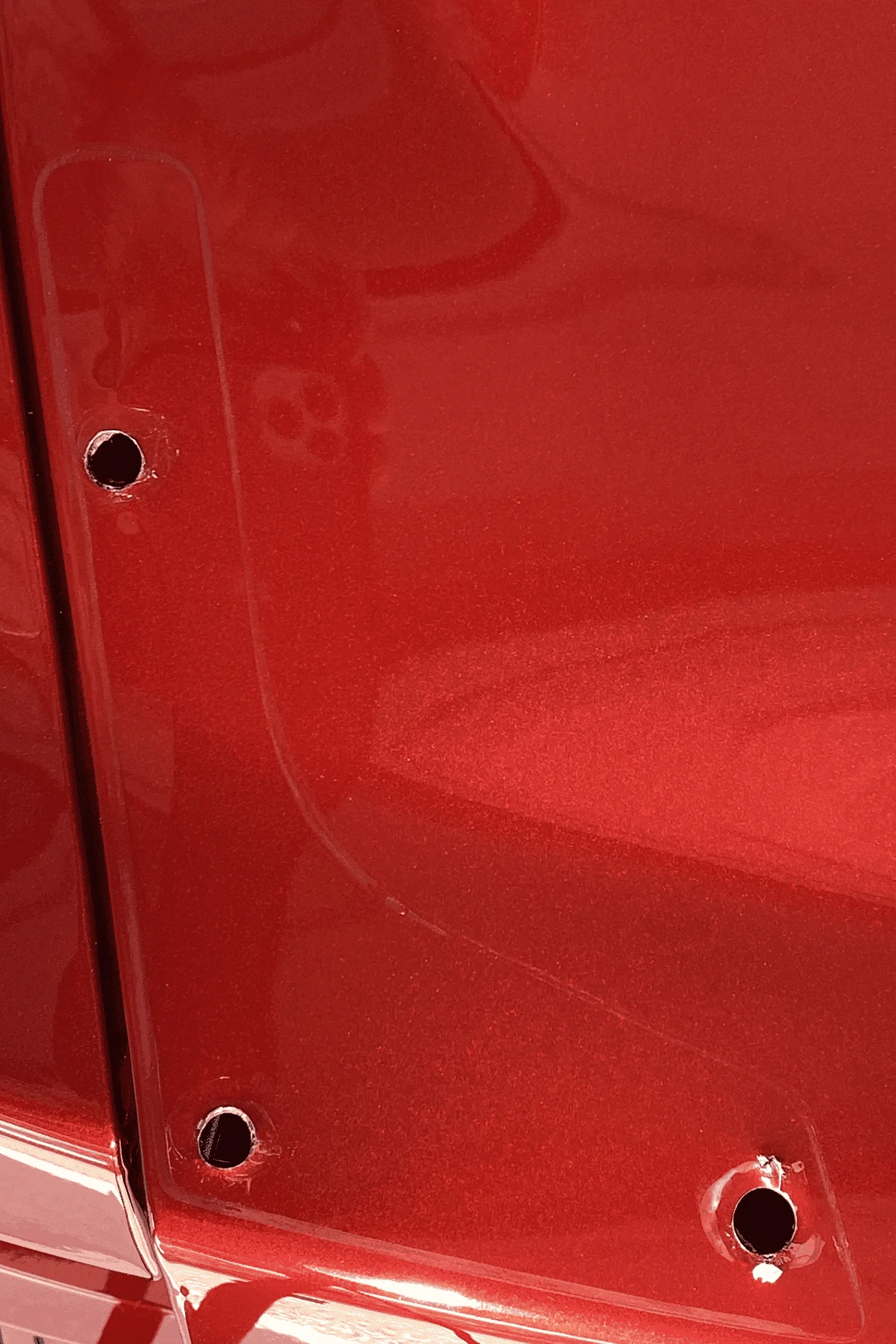

As expected however, the deck lid was ugly.
Tom (@Tomster): I know you had the body shop clean up the holes on yours but I am wondering what the group think is on using a rust inhibitor product? I'm debating whether I should Dremel around the area first then prime and paint or whether to just cover it with an inhibitor and keep it dry? Ideas anyone?

If it was me doing it, I would use an etching primer on exposed steel. If it was all rusty, then I would touch it lightly with sandpaper or dremel and then prime and paint.
I wouldn't go nuts on the paint correction..... Ford paint and clear is pretty thin.

Its professional auto body primer. Etchimg primer is mostly used for aluminum and stainless, but i find it is a very durable primer for most metals. Go to your auto body supply. Im sure you can get a rattle can.

I just finished hitting one side of the deck lid where the brakets attach with a fine pad and M105, it cleaned up considerably and what I thought was rust under paint is just where Ford deformed the holes. It's clean, zero rust so I will just do as you suggested, get some etching primer, give them a coat or two and then some Rapid touch-up should duit. I haven't looked at the condition of the O rings but hopefully, they're in good shape and I'll put some of my magic pool chidt lube on them to keep them pliable.
