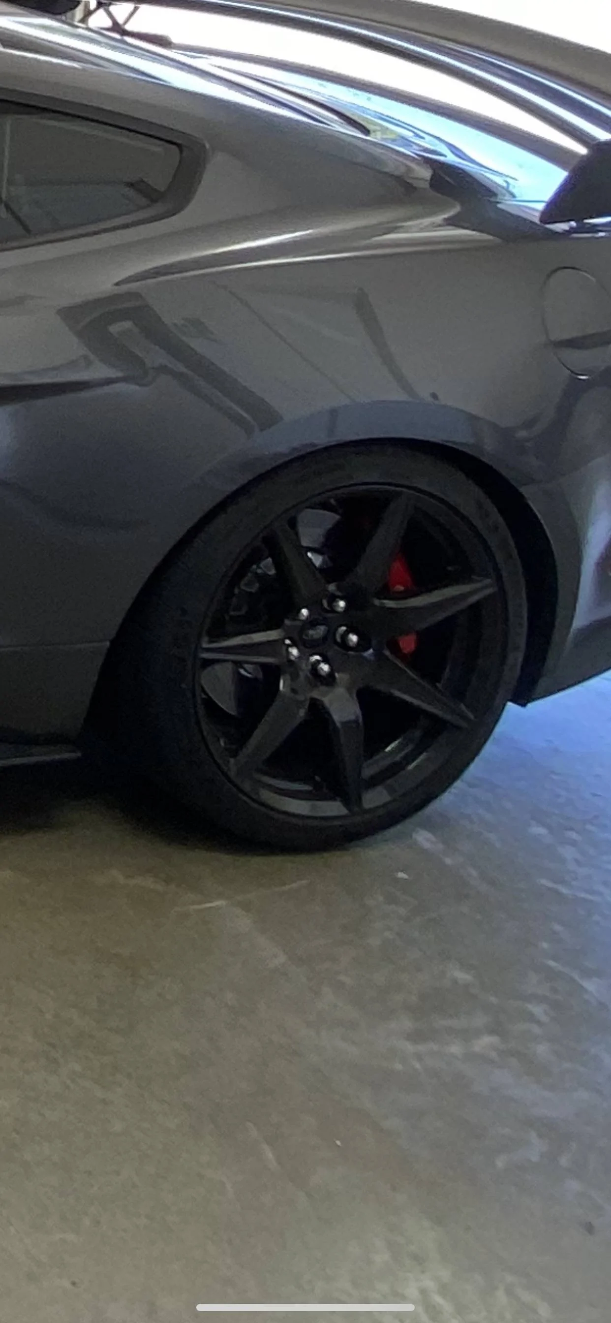

Hi I have a 2021 GT500 CFTP and it maybe my eyes playing tricks on me but it looks as if the car in the rear is leaning towards the driver side a bit. I measured to center or wheel well and it was roughly 1/4”-3/8” low compared to the passenger side. Could it be bad springs? Alignment?

Yes all tire pressure is same. Although camber is pretty steep I don’t think that would affect anything height wise. It just certainly looks like the drivers side wheel gap to fender is much smaller.

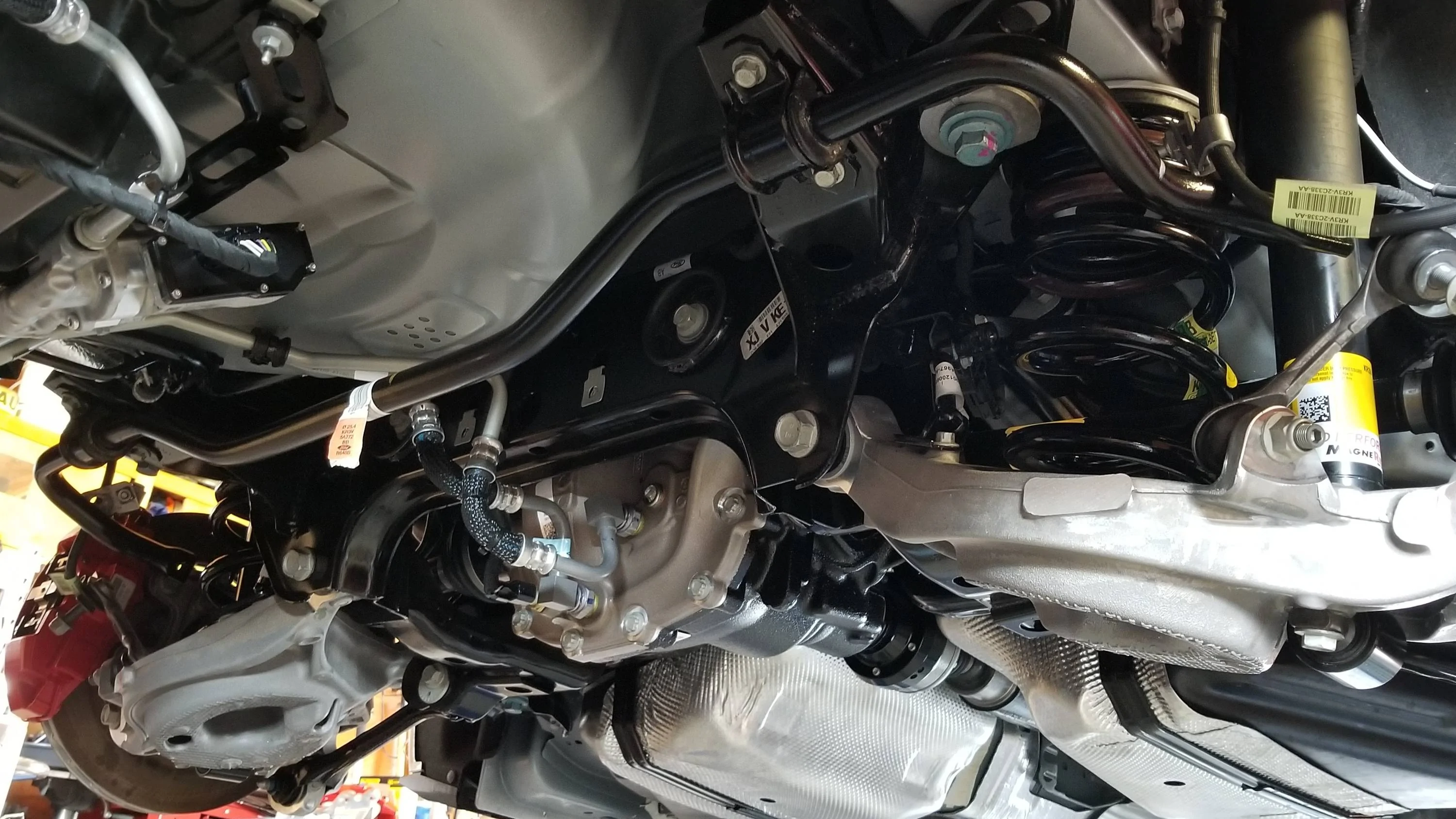

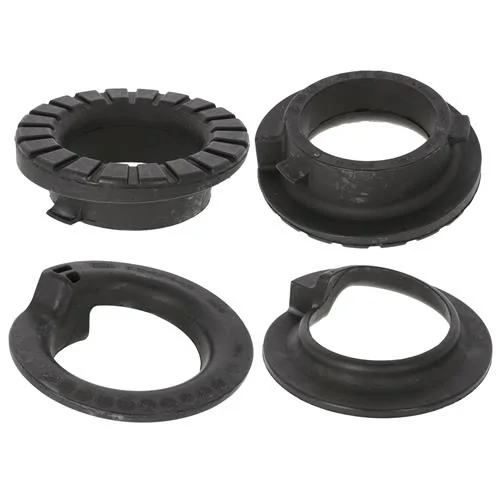

I guess I could see how one side would be higher than it is designed to be if (for example) a rear coil spring wasn't seated properly. If one side was lower than it should be I'd be looking to see if a spring isolator was missing. You can see one at the top of the rear spring here from when I was swapping CFTP springs/rear bar onto my Base car.
Generic S550 isolator example photo...
Another shot where you can see the isolators in place with the wheel off.
