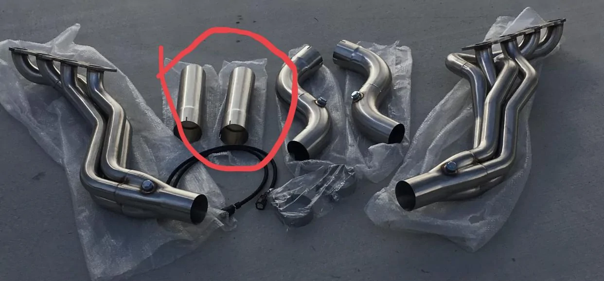

So I have 2m headers installed and went to button up my full corsa sport catback.. there is about a 6-8" gap from the end of the 2m flowtubes (S pipe) to the beginning of the corsa double x..
1. I never saw anything on the forums about this lol..
2. What did you do to fill this gap?
Calling a bunch of companies tomorrow to try and just buy straight 3" flow tubes.

Not familiar with the 2m headers, but I pulled this pic off eBay. Do you have those extensions circled in red?

yeah those go off the end of the header before the S pipe, the gap is then after the S to connect to the mid.
