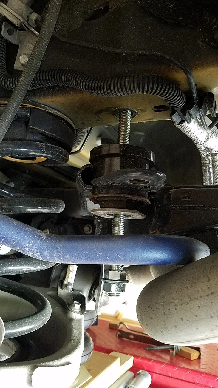

I ordered a set. My IRS assembly needs to come out at least 2 times in the next month. This should prevent stripped threads.

I have a set, install was easy and it's very easy to drop the rear cradle without fear of cross threading!

I made my own by cutting up McMaster all-thread into 10" sections.
They are not high grade steel so I only use them temporarily and then go back to the blue bolts when done.
Total cost is around $50.
Support the cradle with a floor jack, and then remove each blue bolt and replace with the all-thread stud, one corner at a time. Then you can lower the cradle to the level you want, and run up the nuts/washers sets for the final support. Expect to deal with some binding. It may be helpful to use a little oil on the threads.

My subframe is going to be lowered down considerably to do the front diff bushings. I'm considering @GTP's method and use some 250mm long 14mm x2 threaded 304 stainless rod I found online. Thread in and remove when done. I'll probably never lower the IRS again unless something else breaks. I'm getting to the point where I'm satisfied with the IRS now and also completely fed up working on it.

304 isn't strong enough to use as actual studs, but using them as guides like GTP is a good idea.

Yeah, I realize 304 is not an equivalent for hardened steel bolts. Stainless so they don't rust sitting on the shelf between uses.
