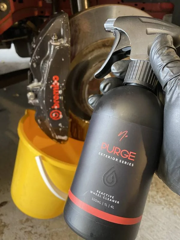

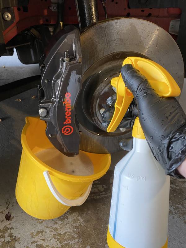

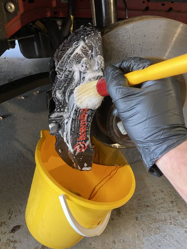

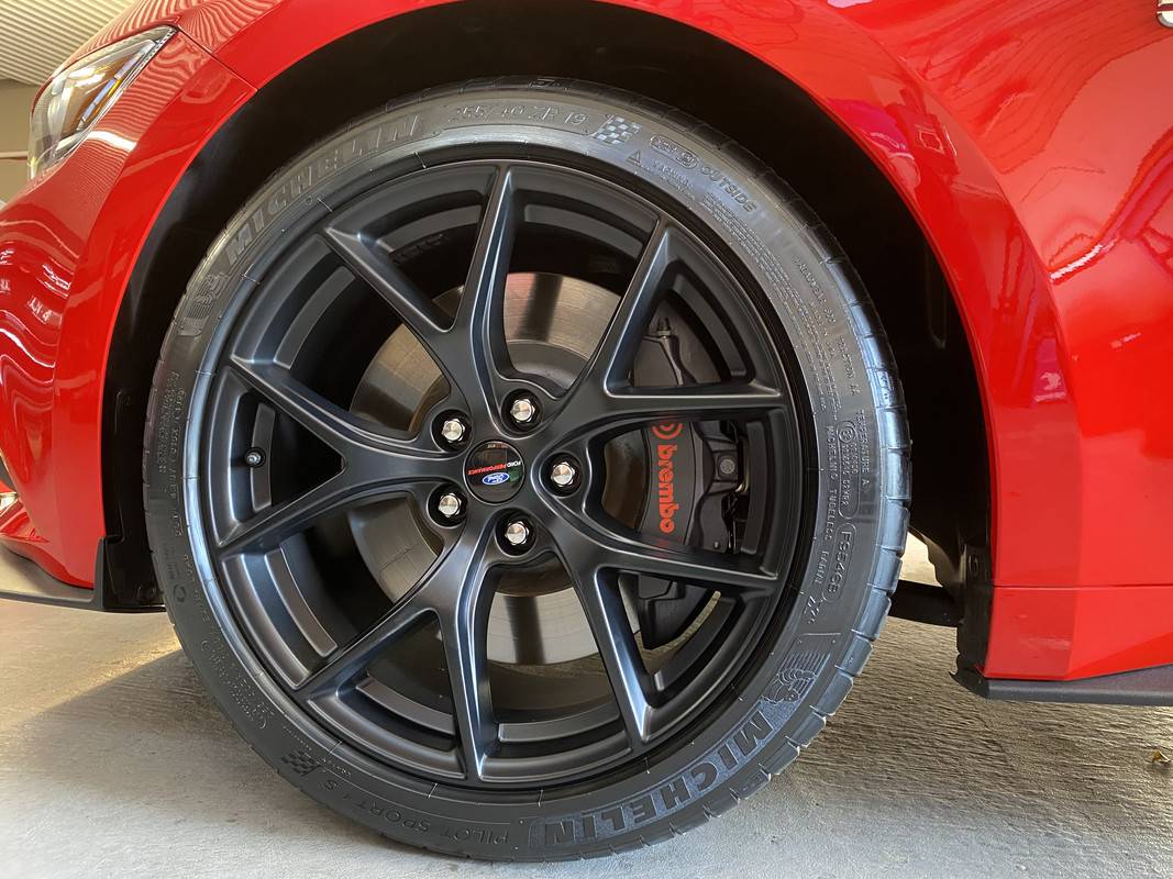

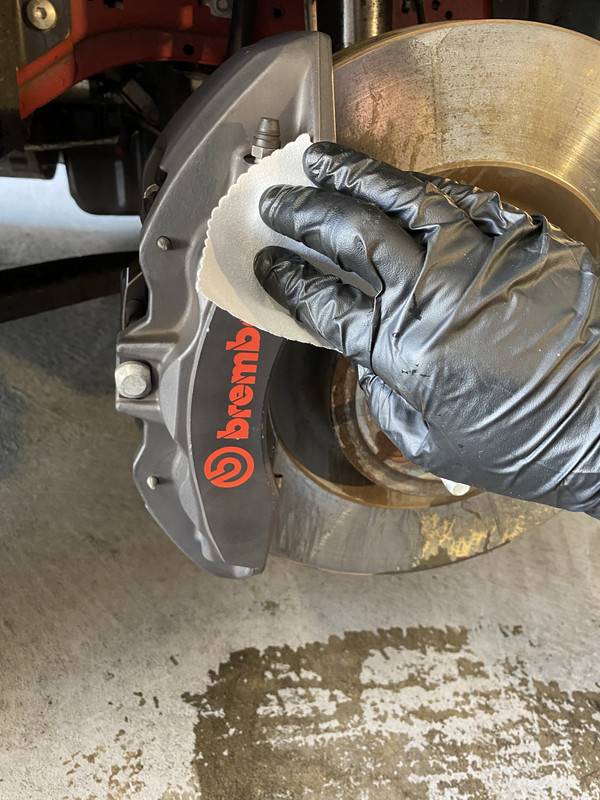

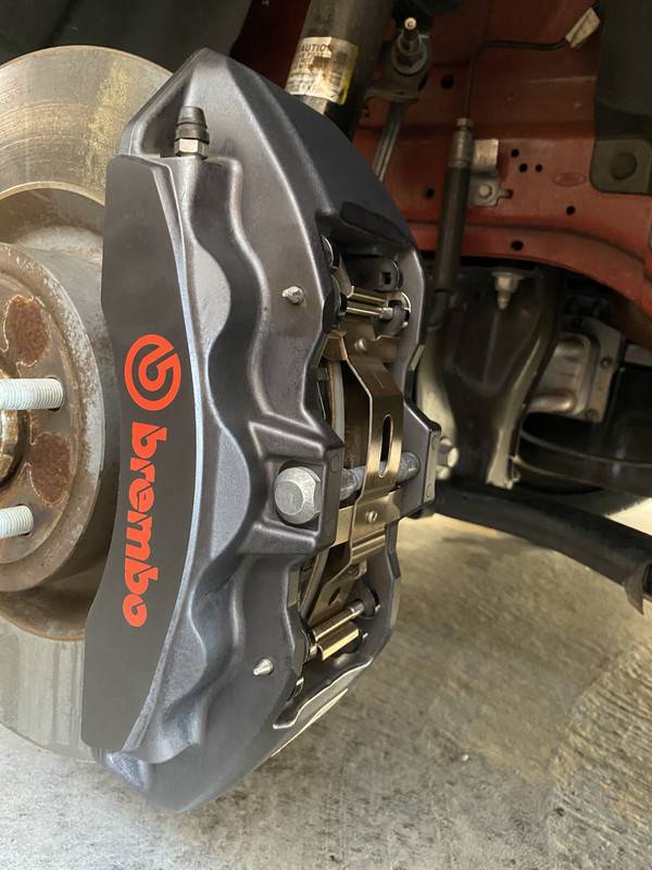

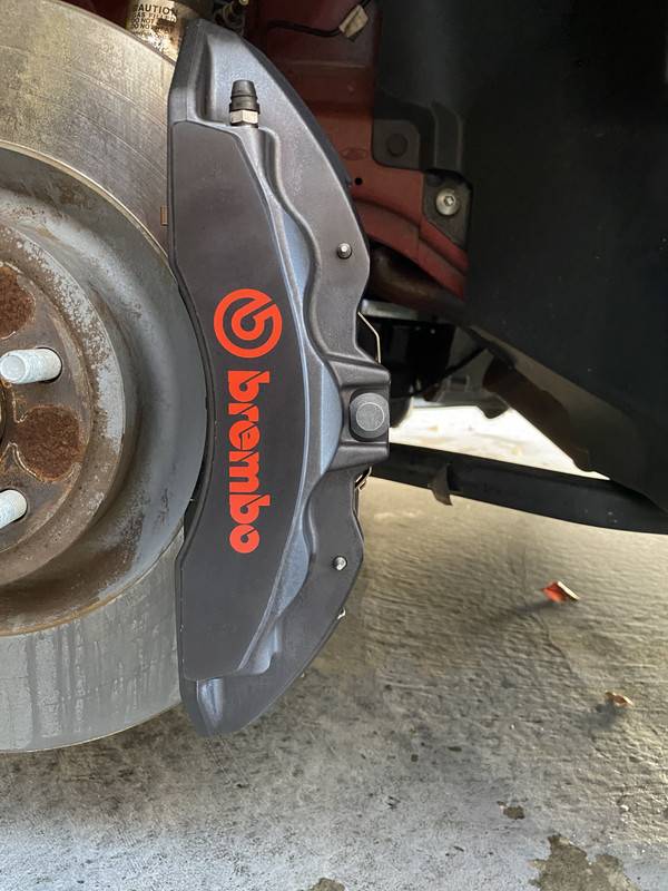

There are a couple of ways to address this.

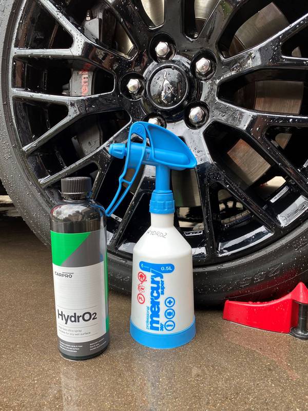

The simplest method would be to use a spray and rinse type product such as Gyeon Wet Coat, CarPro Hydr02 or 303 Touch-less Sealant. The beauty of this method is that you don't even have to remove the wheels. In terms of application, wash the wheel and calipers as normal, preferably using a iron removing wheel cleaner such as CarPro IronX or P&S Iron Buster. Rinse very well then while the wheel is still wet, apply a few sprays on the wheel face, barrel and caliper. Rinse again and you are done. These products will last around 4 or 5 months.

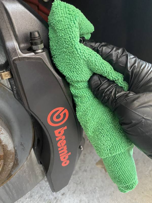

If you intend on taking the wheels off anyway, then you may as well use a ceramic coating. Make sure to choose a coating suitable for higher temps such as CarPro DLUX or Gyeon Rim, these will provide 12 - 24 months of protection.

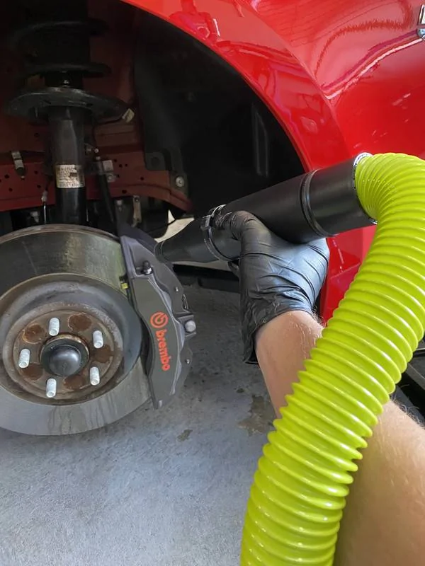

The prep process will be the similar, decontaminate with an iron remover, rinse well, dry the calipers with a blower or compressed air and then wipe over the areas to be treated with an IPA solution such as CarPro Eraser or GTECHNIQ Panel Wipe.
Decon -
Drying -
Eraser -
Coating -
End result -
With painted calipers, the end result would be more noticeable compared to the OEM grey finish my car has.
