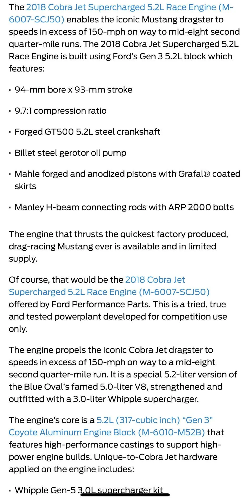

Found it, here are the 2018 CJ drag engine specs and part numbers.
