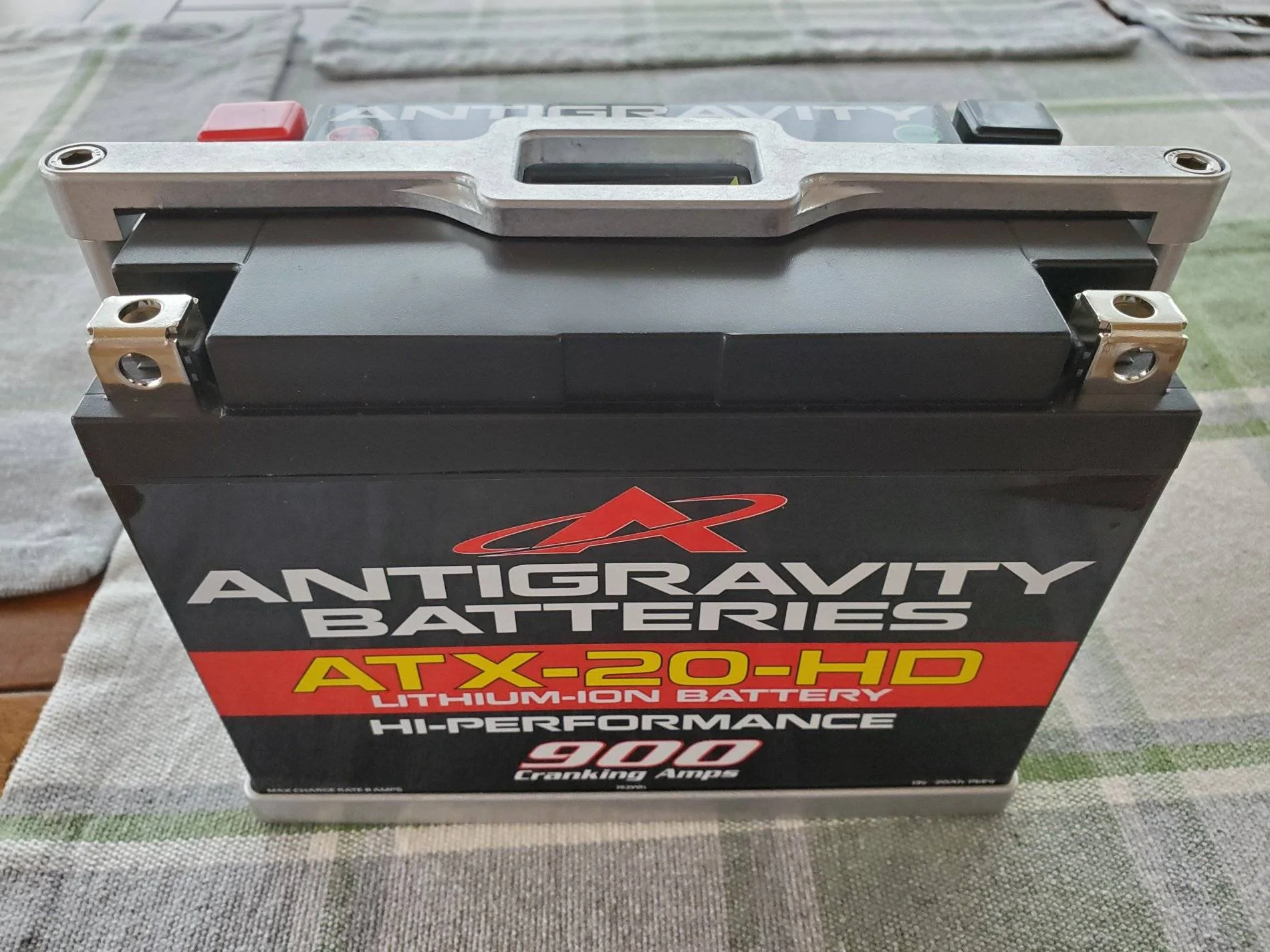

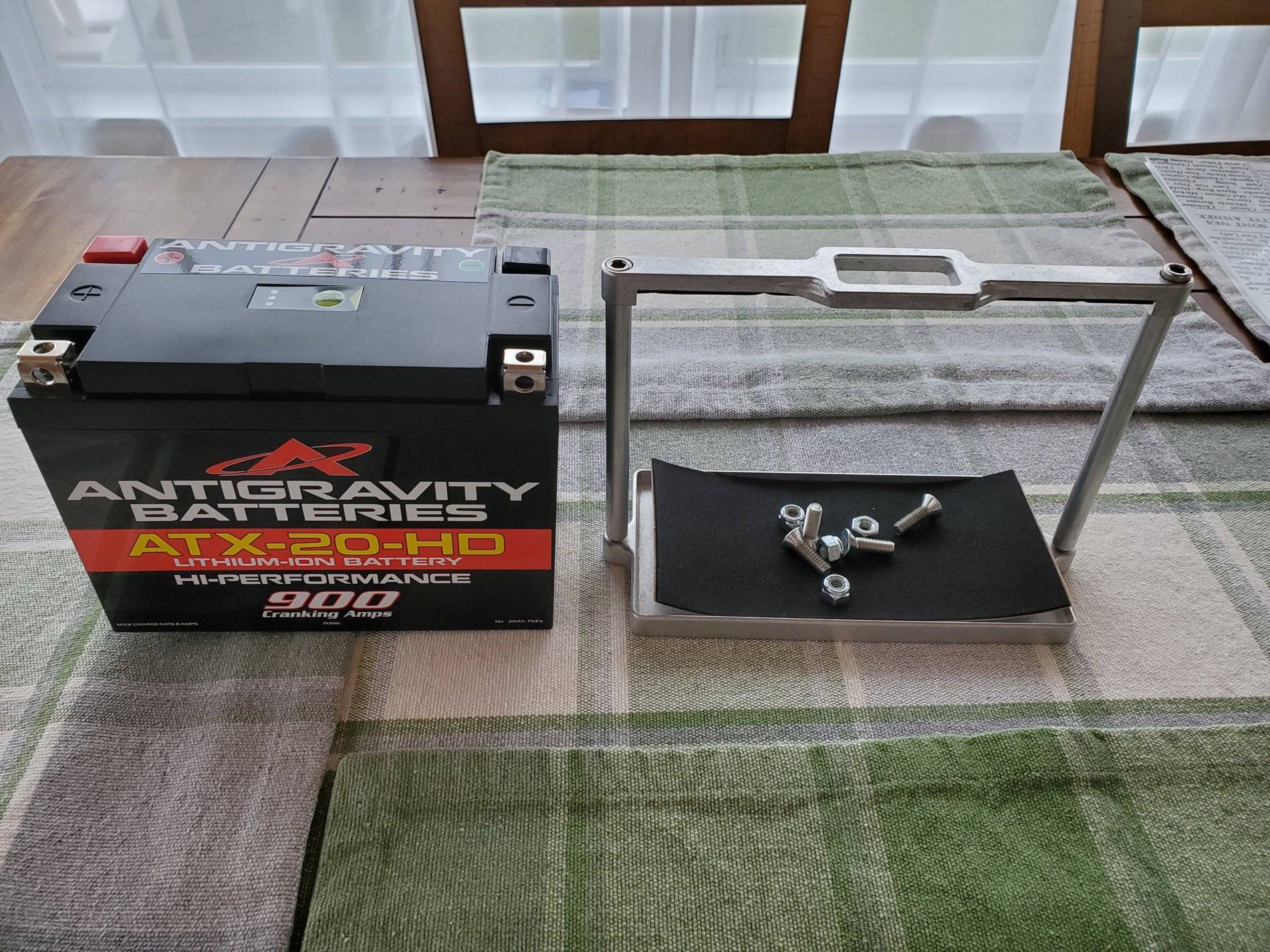

I just wanted to thank Scott, Chad, and Arlene for sending the ATX-20-HD mount for evaluation. I just got home from Europe last night and I plan to install the battery and tray sometime today.
My initial impressions are that the mount is solid. It is lightweight aluminum that appears to be stout, yet lightweight. What would be the point of a lightweight battery without a corresponding lightweight mount?
I am very excited to install this package and provide meaningful feedback pertaining to the product, the install, and the potential weight savings.
If this system works out, it would be the biggest no brainer (bang for the buck) for any track enthusiast who is trying to take weight off his car.

Thanks for showing the Battery Tray Tom, sorry for the delays.
A couple things for those interested. The trays are expected to get to us by next week. We will have them for the ATX20 and ATX30 case sizes. Tom please let us know how the install goes, and what improvements you suggest... we know this particular tray will require attaching to the Tray by bolts and are looking at other mounting options for more of a stock fit as well.. but that might create a more bulky tray. Anyways we are always open to suggestion.

I would be happy to share my simple yet effective solution. When I remove the tray for return to you, I will highlight the modification that I accomplished. Are the production mounts exactly the same?
