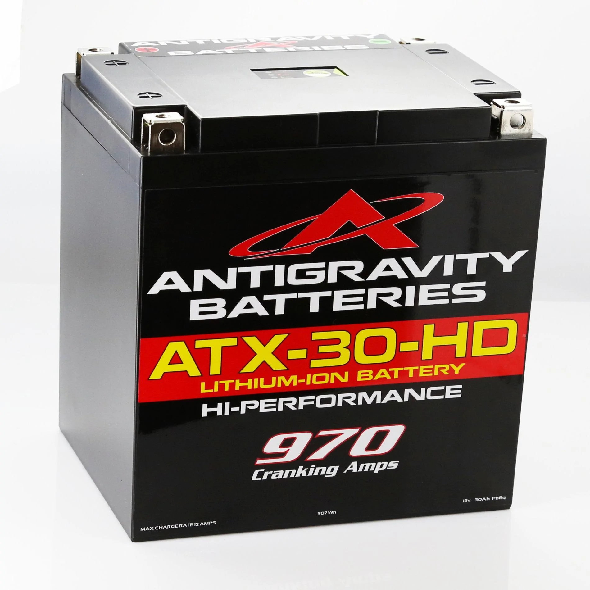

Well actually NO.... the best batteries we make are the OEM RE-START Automotive Batteries... those batteries have more Amp Hours, and they have Wireless Built in Jump Starting and and OEM fitment.... But we only have the H5 size.. which fits a Mustange but is 5/8" TALLER than the OEM/Stock 96r size of the mustang. See a few posts above... someone put that battery in their Mustang... just a bit taller than stock. You cant ask them about it and if being a little Taller is an issue.
Now the the ATX30HD has 24Ah which is the same Battery Pack inside as the OEM RE-START Battery... but the differences are.
1- It does not have the RE-START feature, though it DOES have a full BMS to protect from Over-Discharge and damage. So it has all the protections and such, less the wiresless jump starting feature.
2- It is NOT and OEM fitment. OEM fitment means it would have the ability to drop into the Mustangs box and use the same mounting hardware. It does not have the exact drop in fit size... you have to make a hold down for it. I think people were showing some of these earlier in the thread.
3-It does not come with the Automotive style Terminals, you have to buy the SAE Automotive adapters that that bolt onto the ATX30 Terminals to make it have the Auto style Terminals...
4- But the ATX30HD is lighter, has as much power and is more compact than the H5 RE-START MOdel and costs less.

Thanks. The Australian dealer does have your RS-30 available on their ebay site. Is this a good fit for the 2018 Mustang or withstanding the height factor should I be asking them to import your H5.

The height is too much on the RS-30... Demonic tested that unit.. just not a good fit for the Mustang he said the height was just TOO HIGH..... Best to do H5 or ATX30HDs. The guys from Carlisle wrote to me.. but we have Labor day weekend so I just answered some questions for them, but would see what they wanted for their next order this coming Tuesday.

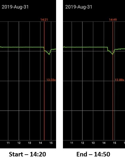

Just be mindful of running ACC too long — say over 15-20 minutes.
I haven't tested myself exactly what run time is in ACC mode (engine off) but I am wondering if I should do that. I'll get back to everyone and see.
Ran the test. Actually did better than I thought and very much acceptable for DD scenarios IMHO. Very impressive.
Test Parameters (Somewhat worst case scenario) with a stock 2018 GT350R:
1. Parking Lights on
2. HIDs off (High draw, and most people don't sit with headlights on even in normal scenarios)
3. Stereo playing "pop" music at a louder than normal volume
Result
~30 minutes to go from an indicated 98% charge to 79%.
You can see above that voltage drops once under load (~13.03v) without the engine running. It drops steadily to 12.88v over 30 minutes. The battery tracker app records this as 98% and 79% charge levels.
I then immediately start the car at 14:51 for ~20 seconds. No issues and fired right up without any straining.
Interestingly, the resting voltage jumped back up 13.15v directly afterwards or 85% charge level. Either:
1. The app was very conservative and there was still some run time left
2. The battery charged up a bit (not too surprising, lithium batteries charge MUCH quicker than Pb)
Conclusion
So honestly... 30 min is MORE than enough ACC run time for me personally even in a DD. This isn't even factoring that 80% is still MORE than plenty to start the car AND there might have been some run time left on the table as the battery wasn't actually 80%.
