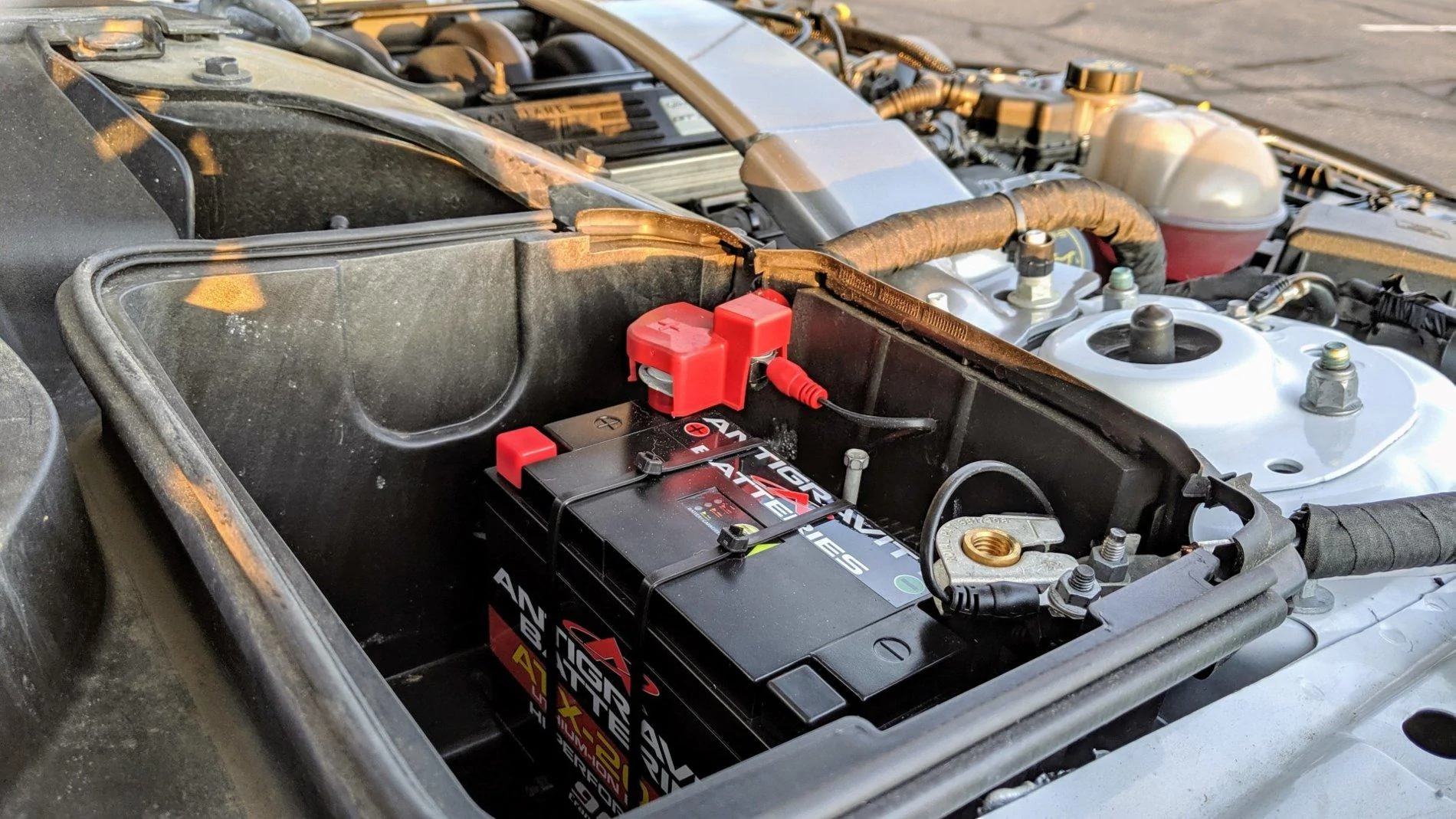

Received the Antigravity battery, and finally got around to installing it to see how it fits. Here are photos of the installed OEM battery, installed Antigravity battery top, and installed Antigravity battery with the shield on. As we all know the AG battery is a little taller. You can see where the shield is raised up a little bit. The hood appears to close well but I can't tell how much extra pressure (if any) is on the battery shield from the hood.
Hey Cooks thanks for Posting that up.... those pictures help to understand the clearances for me.
Can you by chance measure you exact height of the stock battery? So I can verify the exact height difference between ours and the stock battery for future reference for us. Then we can tell potential Customers is this will not rub, and work for sure.
Also, we had some race cars with tight fits on other batteries and we used to check the clearances with Plumbers Putty, or Play Dough to see how much room was left of clearance. We would just put a little ball next to the points I though were close to rubbing and close the hood or box and see how thin the putty is squished.... I just wouldn't want you to mar the paint on you underside of hood. If you find it won't work or rubs just let us know and we'll take it back and fully refund no problem.
