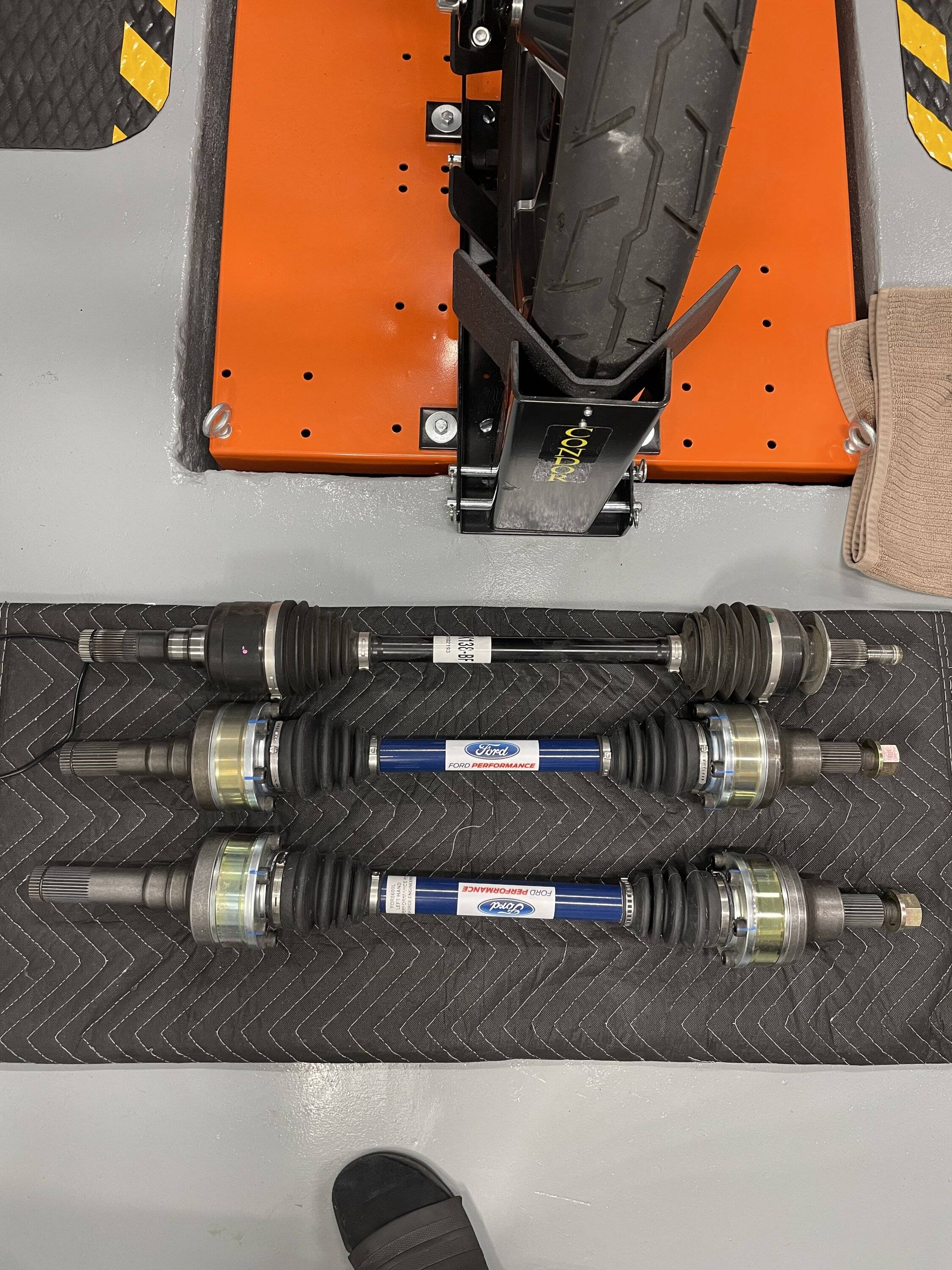

Axle snapped clean
While that sucks, a half shaft is much easier to deal with than removing a driveshaft and tranny. Were you on factory tires and experiencing excessive wheel hop when this happened?

Glad to hear that the MT82 held up to rough treatment with no problem. Good luck with the axle replacement. Are you going to a stronger axle?

Ford Performance half shafts are very beefy and can handle some pretty good abuse. I’ve tested mine several times with 7K+ rpm launches off the 2-step on 305/45/17 Mickey Thompson ET Street R radials.
nope. this thing is now sitting next to my evo which has it's engine torn apart. gonna get a stock, have too much going on at the moment. just paid a dealer 2K for that slave cylinder job (happened 12 hours from home), and got a trip to japan coming up. $2000 axles gonna have to wait if ever.

It seems like you have a solid platform everywhere else and are set up to make great power. Good half shafts would just be icing on the cake if and when you ever decide to install some.
