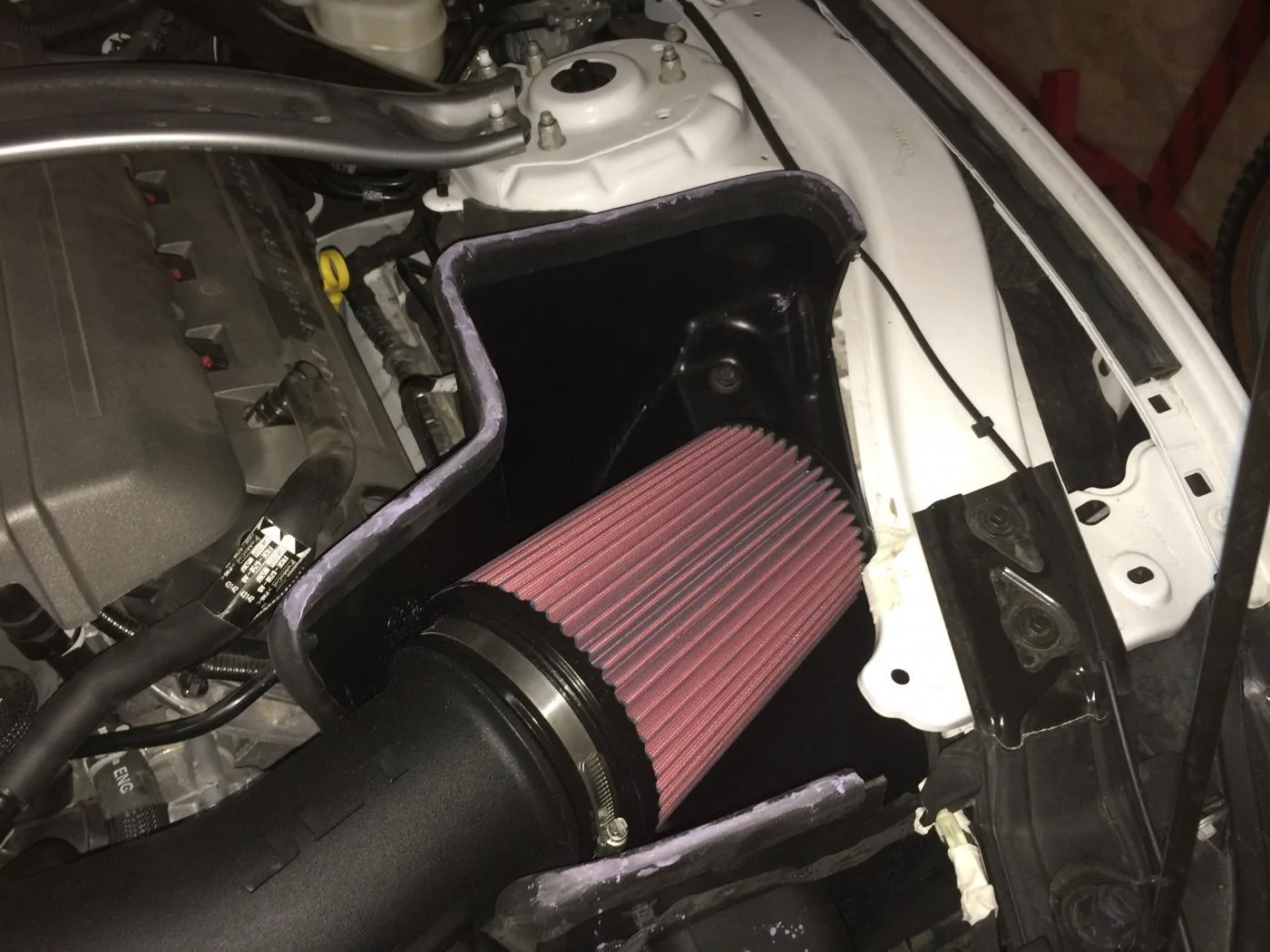

That's the whole problem - the box comes up several inches short of the hood and doesn't seal at all so it's just pulling the air from the engine bay; the source of least resistance.
http://www.mustang6g.com/forums/showpost.php?p=608298&postcount=99
Saw this in your build thread, you removed the hood liner completely? With that the heat shield longer sealing out most of the air as there will be a gap.
So yes your IAT's would be higher, while any info is good info it'd be nice of you to include that in your reasoning.
IAT's will be higher with the JLT intakes yes, as we use a open style heat shield that isn't sealed like the stock box. With the stock box you're limited on filter surface area and are only getting fed air from the factory duct. It's one of those, the pro's outweigh the cons.

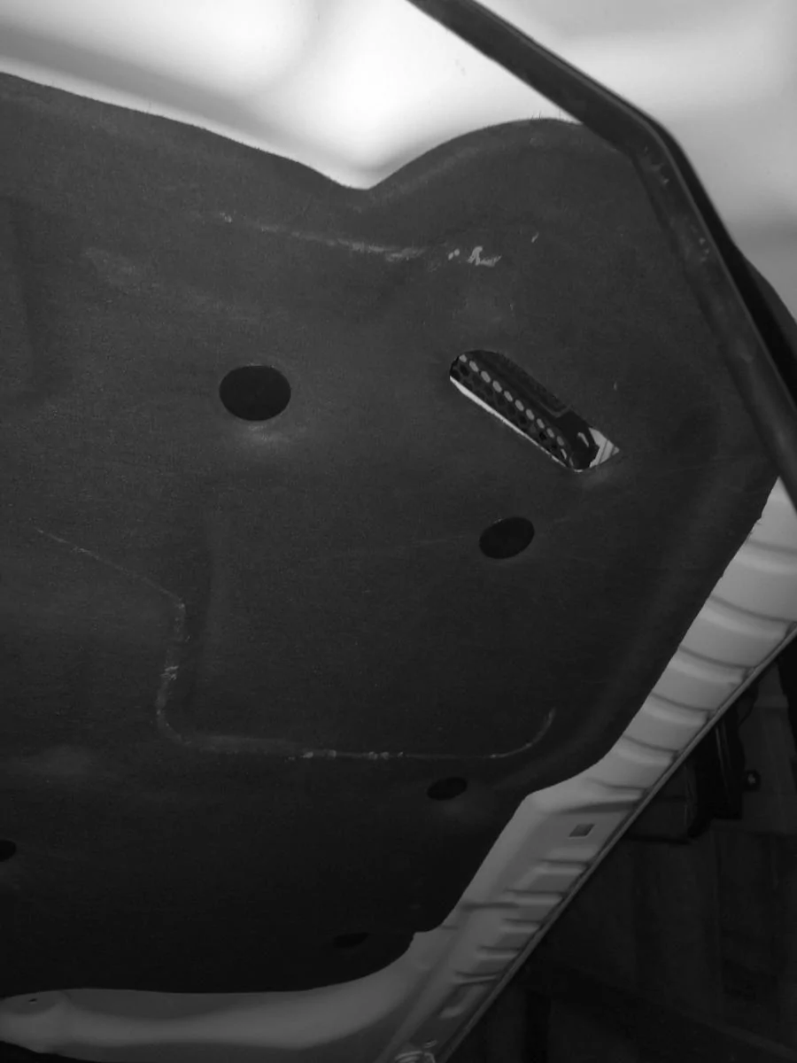

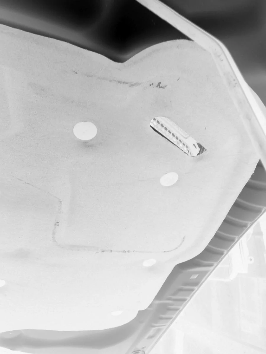

1) Because I saw the same issue with the liner on as it didn't seal then either.
How did you test/confirm whether it was sealing or not?
I don't ever get ambient temps anywhere near 90+, but the last few posts here about the jlt sealing or not sealing against the liner made me curious.
I definitely saw indents in the hood liner, but wanted see how well it was actually sealing. How does one tell for sure? Simple, chalk.
Of course there are spots where there is no rubber, but where ever there is rubber, it looks like it completely seals to me.
I inverted the color one of the hood images to better show the chalk marks?
Nice move foghat.
Jay@JLTPerformance
Oct 6, 2014
147
77
Chesapeake
2015 Ford Mustang
Thanks and that liner is pretty thick, so you can expect 1/2"-1" gap without the liner = heat to the filter.
We have tested this over and over every year. 2011 5.0, Crown Vic, 2013 5.0, 2015 5.0 2003 Expedition and ALL will see 3-4 degrees above ambient @ 55+ and 8-14 @ 30.
