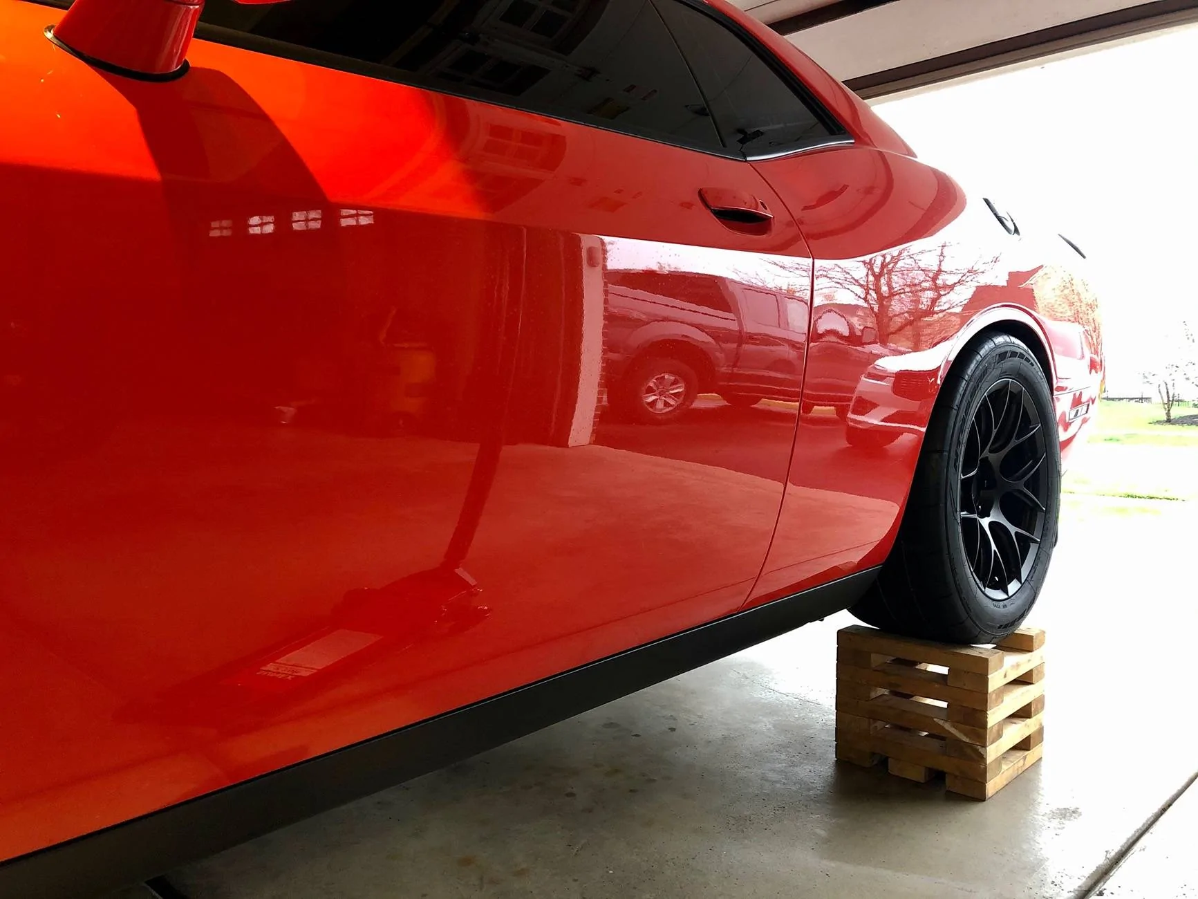

Old picture of mine, but you get the idea!

That looks about the same as mine when I put it on jack stands. If you’re uncomfortable you might try making some wheel cribs
