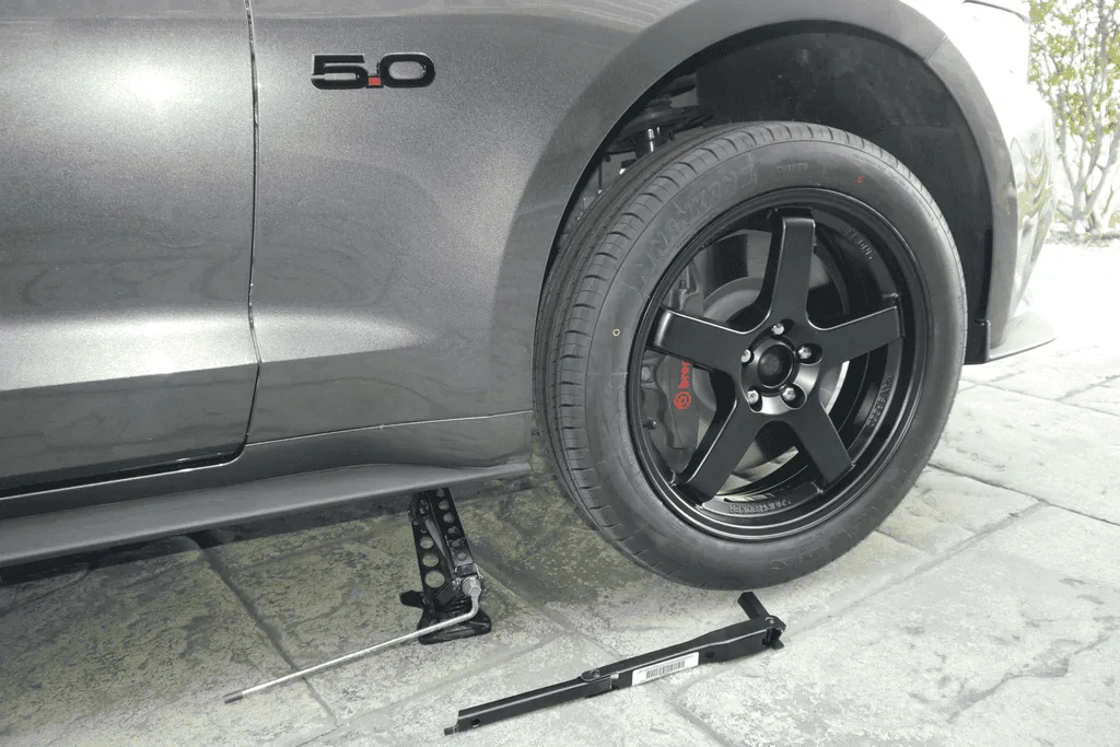

I use this in my PP1.
If you have a Torsen diff?
Don't run a different overall diameter wheel and tire on the rear at all.
https://www.automotiveauthorityllc....-2015-2017-ford-mustang-gt-with-brembo-brakes

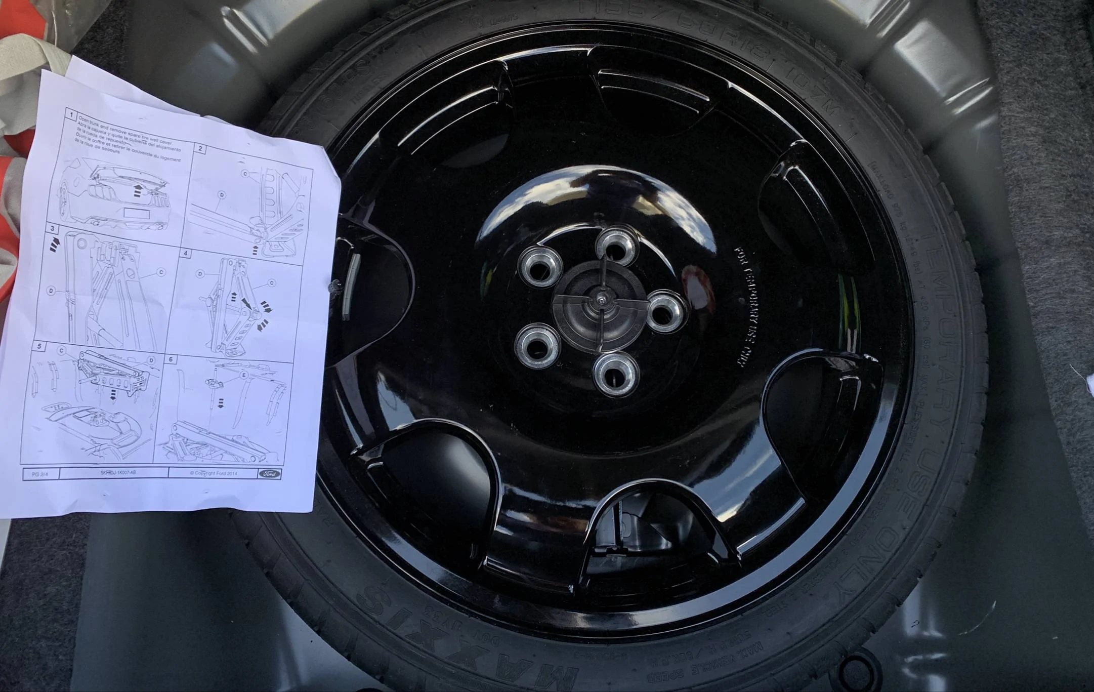

https://www.oemford.parts/oem-parts/ford-spare-tire-kit-mini-fr3z1k007c?c=Zz13aGVlbHMmcz13aGVlbHMmbD0zJm49Q2F0ZWdvcnkgUGFnZSZhPWZvcmQmbz1tdXN0YW5nJnk9MjAxNyZ0PWd0JmU9NS0wbC12OC1nYXM=
Fortify your Mustang V6- I4 and GT coupe or convertible with this kit thats sized just right for stay-put storage in the covered trunk well. 18 x 5.0 aluminum wheel - includes tire and valve stem. Scissor jack. Wrench attached to jack during storage. Retainer bracket with bolt and washer. Easy to install. no drilling required.
This is what I bought as well.
(Mine originally came with oem air compressor, instead of the spare).
I also bought those amazon puck adaptors for my garage jack.
