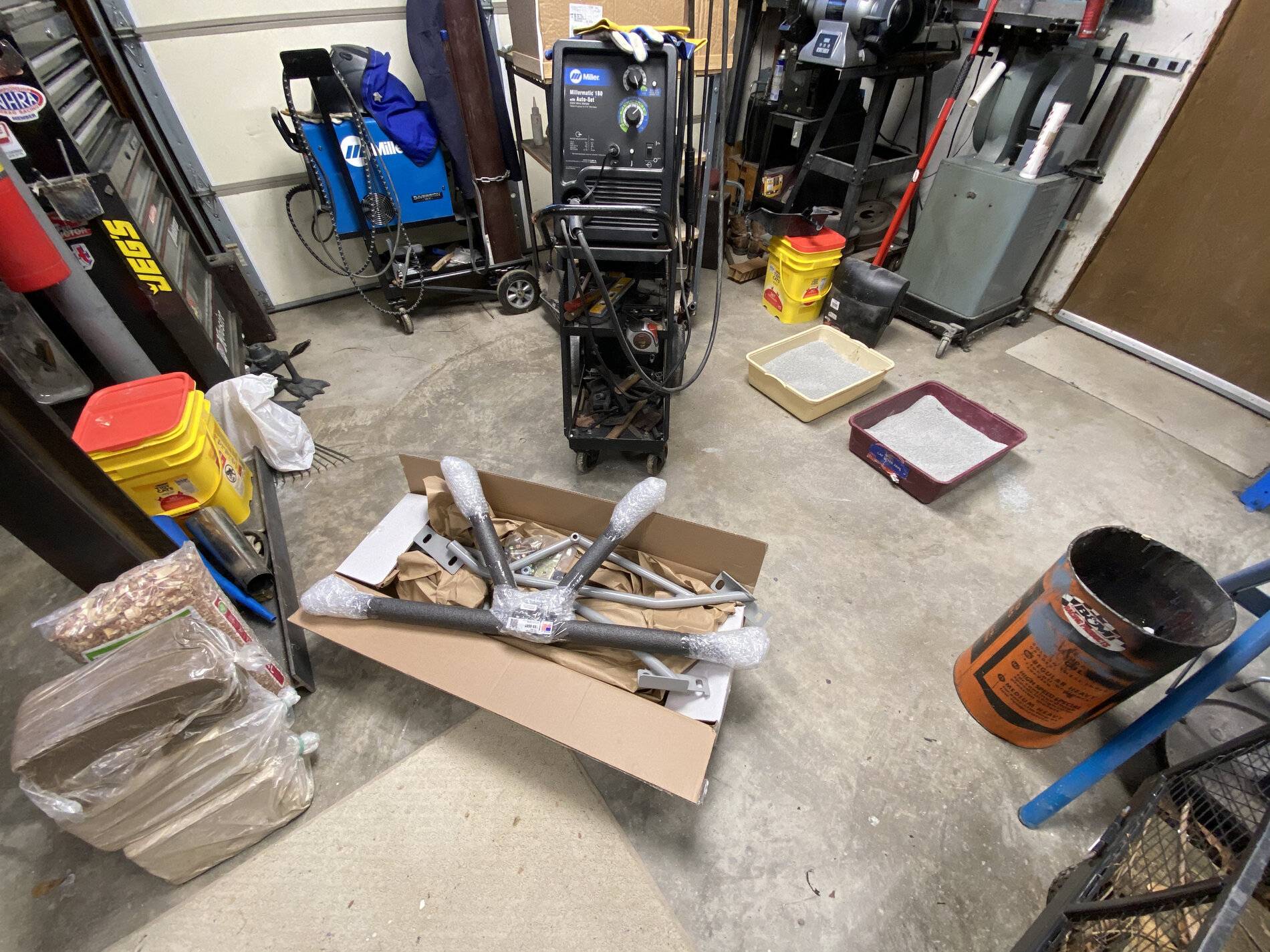

These can be installed without having an alignment, However the rear subframe is advertised for the coupe, Steeda can help with that.
Coupe Rear IRS Subframe Support Braces (2015-2021)
Extreme G-Trac K-Member Brace (2015-2021)
Next oil change I'll slip these on. Look to be powder coated, very nice, quaility welds well done.
