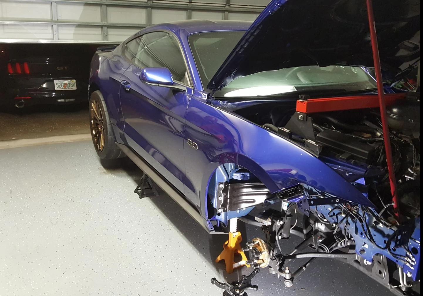

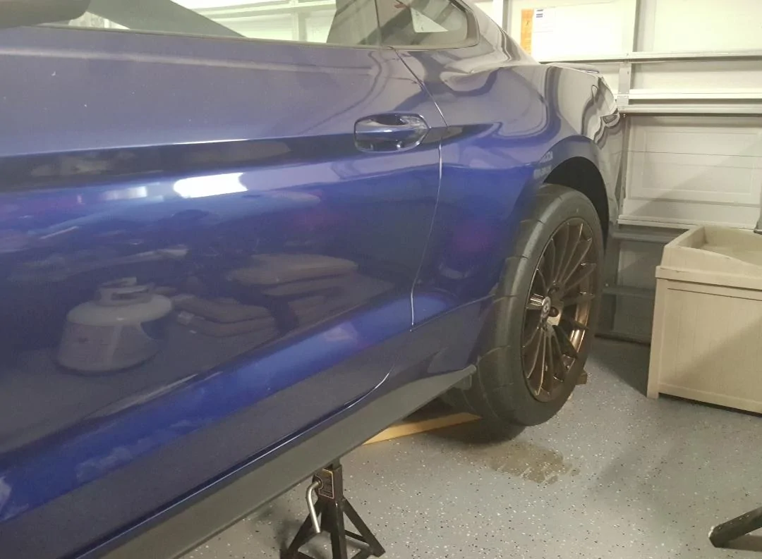

I don't know about you guys, but I'm putting those CJR002s to work tonight. ;)
I love what I do. (And our parts) :headbang:

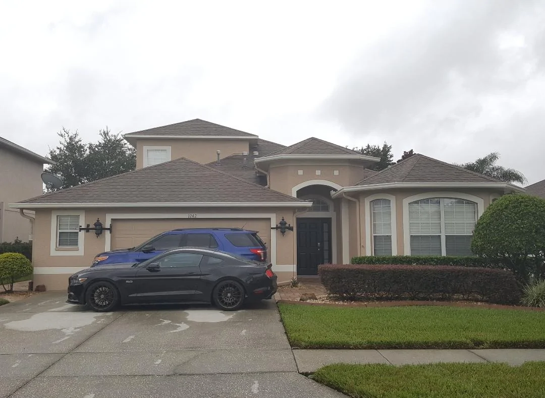

CJR002s providing structural support for my wife's explorer and my garage door while another set of CJR002s kept ole Blu elevated in case flooding during Hurricane Irma. :doh:

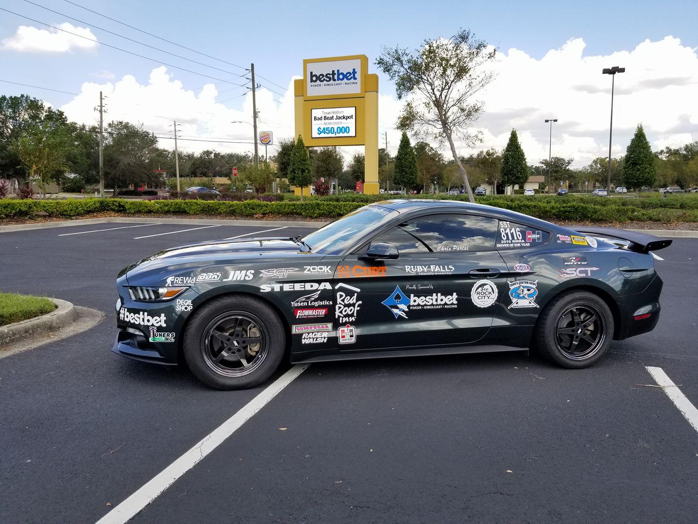

Chris Parisi, multi-time champion & 2016 NMRA Driver of the Year has been very happy with them!
We wanted to wish Chris, best of luck at Bowling Green this weekend!
