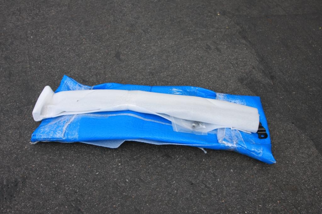

I just received mu strut brace kit from Levittown Ford Super Center. Ford must have heard our complaints about packaging since mine was well padded. Hope to get it installed soon.

I got a refund from mine since it was damaged due to not being wrapped . Since they showed them out of stock with no ETA I was given a refund and placed an order with Latemodel Restoration and they checked that it was wrapped well and sent it right out I must say excellent customer service and I got it next day
