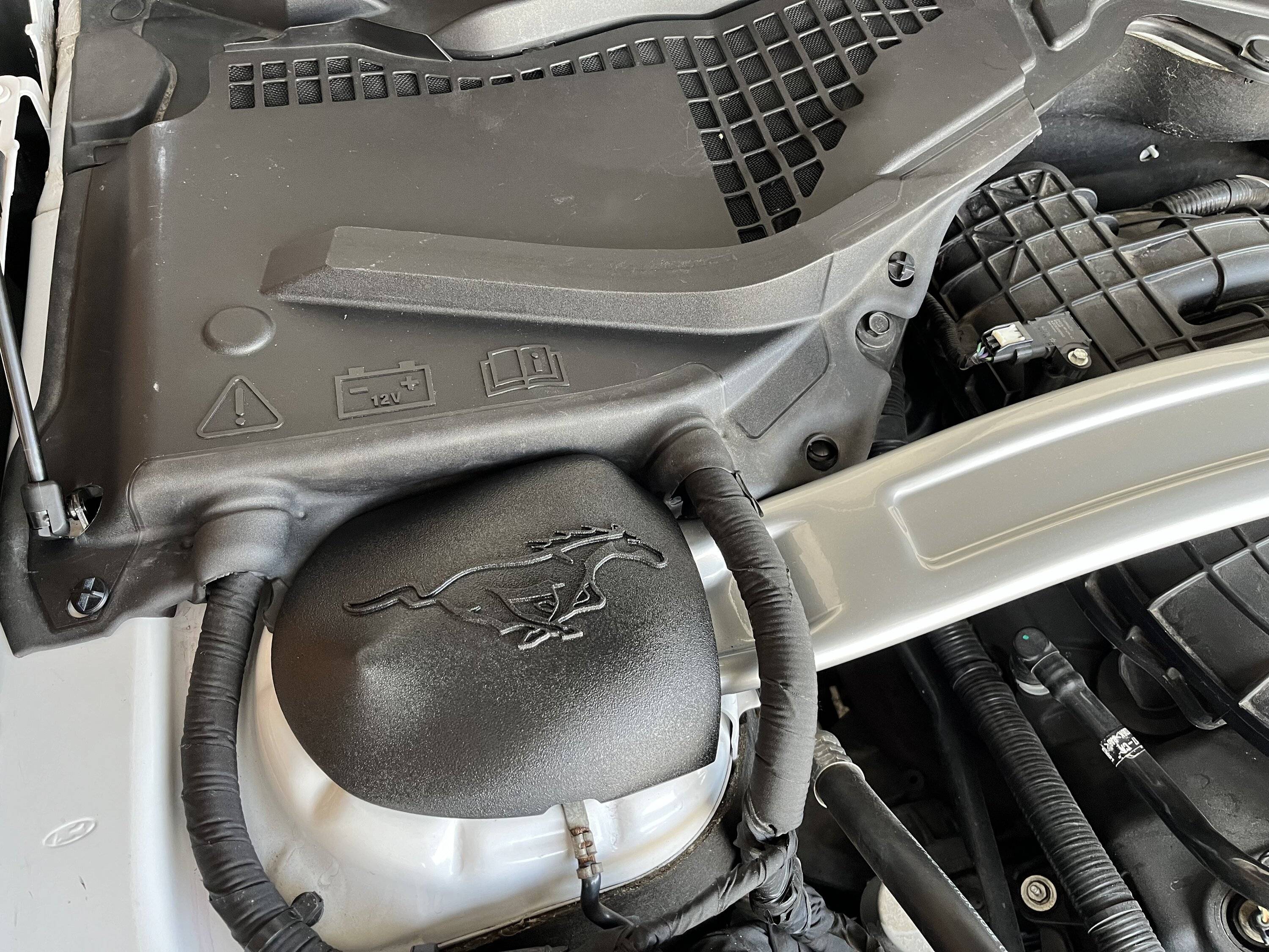

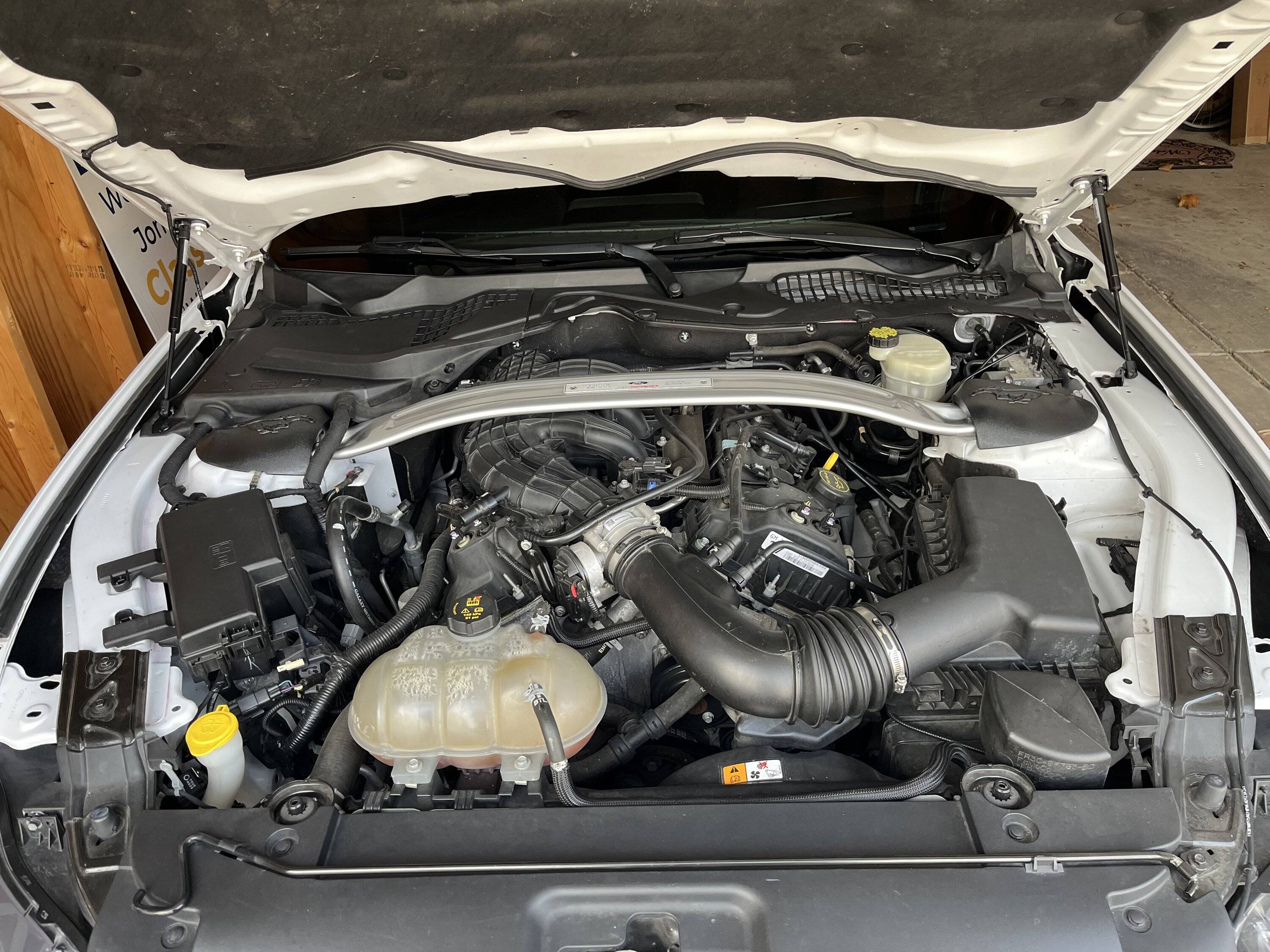

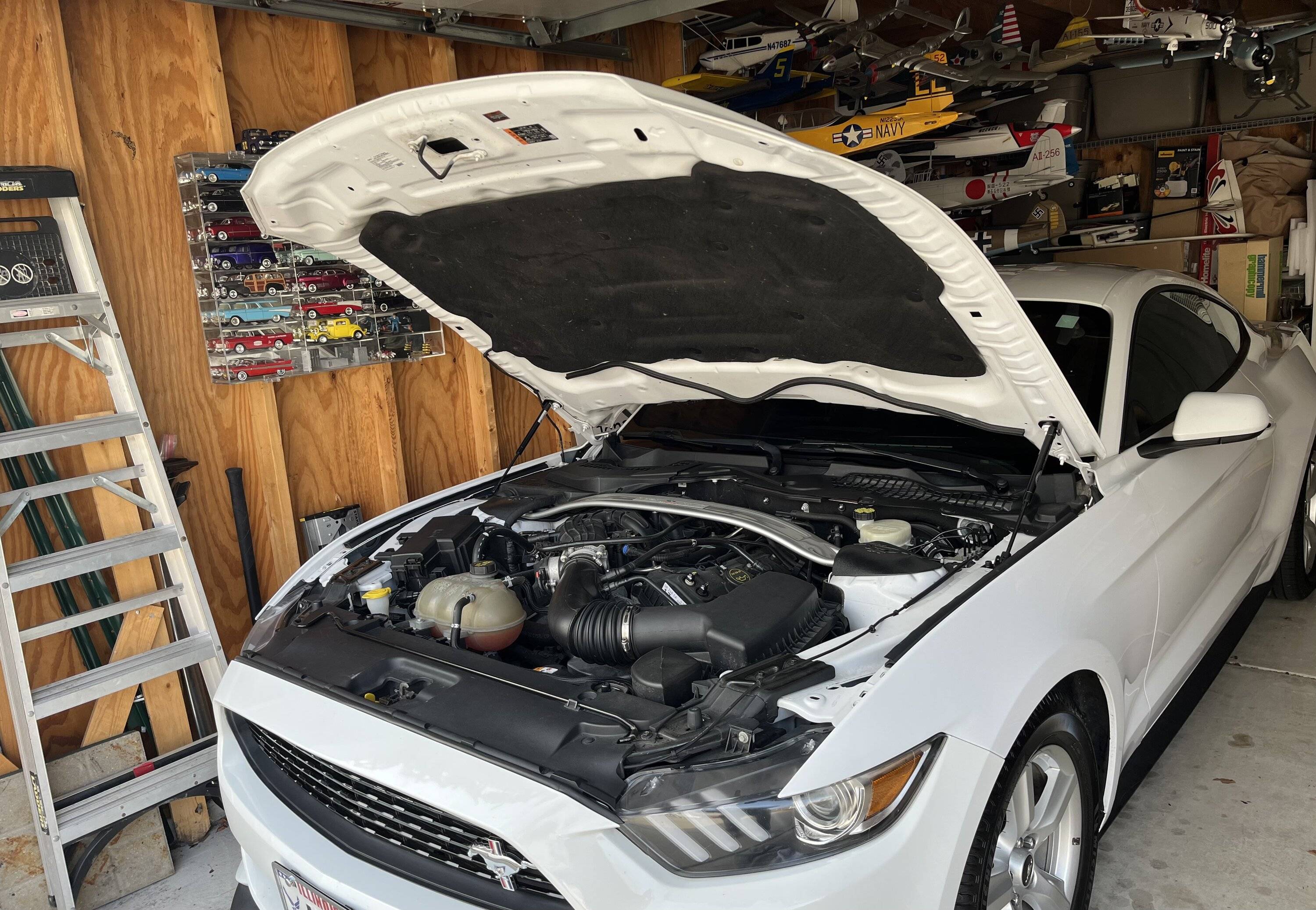

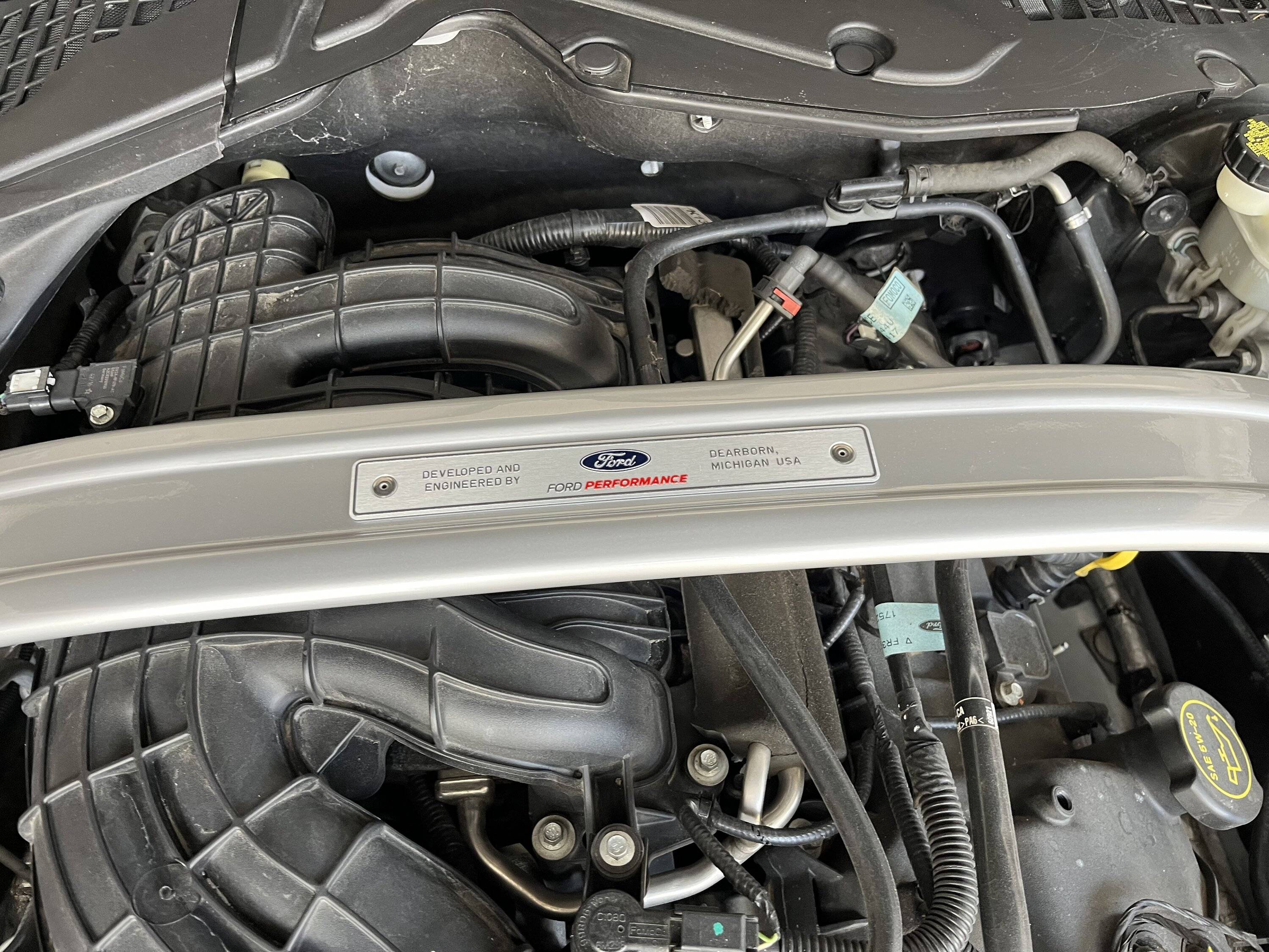

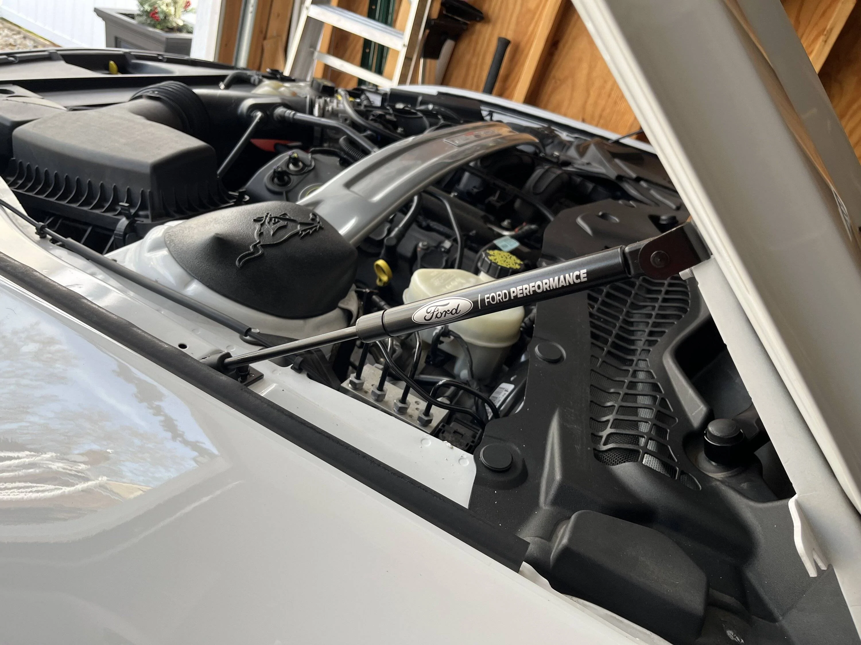

Installed a Ford Performance strut tower brace, strut tower covers and installed Ford hood struts.
