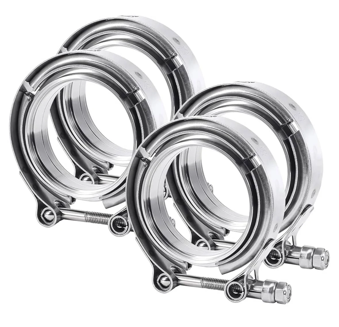

So I hooked up the blower to my shop vac and I noticed that the exhaust was leaking where the header flange clamps were located. I must have hit something on the road and it bent the bolt and it was leaking. I checked the opposite one and it even had a slight leak. I tried tightening them more and the one snapped and the other one wouldn’t quit leaking. When I installed them, the company said I wasn’t supposed to use anything between the header flange and connecting flange…I’m thinking I may need something to make them seal. Looks like I’m buying a few clamps and possibly a gasket. Below is what came with the headers:

Those are pretty good "V-band" style clamps. They usually work very well. My 7.3 Powerstroke uses them on the turbo and they hold very well.

i’m going to use some copper RTV sealant on them with some new clamps and see what happens
