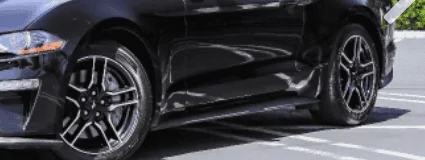

The shiny spokes are now powder coated, and black nuts? This car was murdered. :wink:

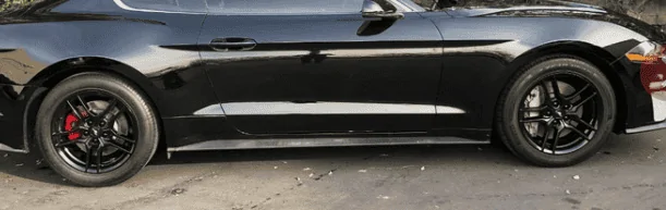

I mean what a butcher job. From the quick things that I notice:
Wrong tailpipes, wrong brakes (no Brembos on this and even the rotors look way smaller), wrong wheels, wrong stitching (it's not green despite the listing info), wrong seat style altogether, wrong shifter, wrong cluster, wrong steering wheel buttons (or entirely wrong steering wheel looks like, we have a Pony button instead of the "M").
If you get blind spot, you get navigation as that's one of the only three options for the Bullitt, so few steering wheel buttons missing actually. And if you get blind spot (i.e. electronics package), you get a sub with the B&O system which clearly has been stripped as you can see the bolts in the trunk still.
No strut tower brace.
Am I missing anything? I mean, for what it is, a decently equipped Mustang, it's not horrible. I know the market is crazy right now. But it's so far removed from a Mustang with so many questionable stripped/removed/replaced parts that it's truly either a massive factory mess-up, or a theft recovery.

It's been pieced together as documented early on in this thread with all the variances whether it was from an accident, or theft - or who knows what. Any Dealership can claim "clean CarFax" - sure if nothing was ever reported...
Put it this way, a person who buys a Bullitt isn't going to remove the Bullitt specific items and put GT or lower base model parts on the car...
and
They certainly aren't going to remove the rear seats from a convertible and put them into a coupe.... or remove the specific Bullitt front bucket seats and put in those from a GT.... LMFAO.
I'd suggest whoever is close to that car, go take some pics of the other nuances.
The B-pillar VCL is "sharpied" for a reason... they don't come like that from Ford and there's no reason for a Owner to do it.
For nearly a $50k ask - steer clear. This is a $30k Bullitt all day long - with another $5k+ needed to bring it back to true Bullitt specs. Well.... that's if the Bullitt engine and PCM wasn't also swapped out... LMAO...
What are the chances that the Magneride suspension is still in tact... ?
