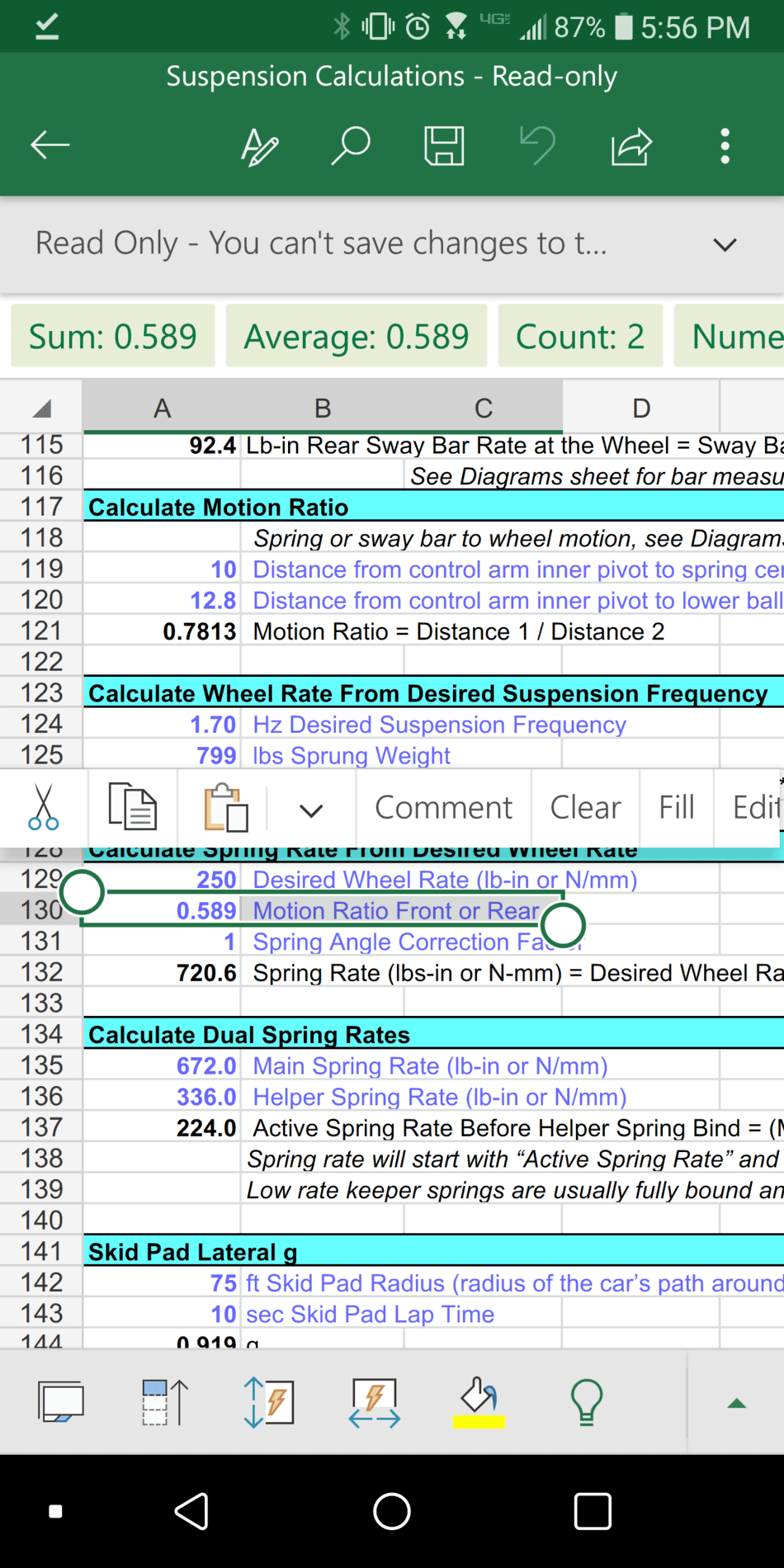

While I haven't tried the SP083 / FP Track damper combination yet, some food for thought (my next upgrade):
GT350R Track Pack Spring Rates: 240 lbs-in Front, 920 lbs-in Rear, F/R Ratio is 0.261
SP083 Spring Rates: 250 lbs-in Front, 980 lbs-in Rear, F/R Ratio is 0.255
Darn those are close! FP Track Dampers ARE GT350 valving. Pairs ideally with Steeda Bump Steer and Roll Center Correction Kit and either their spherical Tension Link bearings OR their Higher Durometer Tension Link Bushings (which i'm running now). Steeda's extended height ball stud lateral links are set to correct geometry for a 7/8" drop in ride height which is EXACTLY what the ride height drop of the SP083's and Steeda's Comp DR springs.
RC and Bump kit works well with stock PP struts an SP080's that I'm running now. Handling wise, I wouldn't lower my car without corrected geometry unless going to a much stiffer spring, but even then your still sacrificing geometry which optimizes tire contact patch. Case in point, the Ford Performance Track Suspension kit does NOT offer corrected geometry, but did you know GM offers a 1LE suspension Pacakge for 1SS owners? Guess what, they have extended ball stud lateral links in their package! Geometry matters as much as CG, ride frequency or any other aspect.

Avoid stiff rear bars, you'll end up with chronic over steer. Also the front roll couple has very little change between spring rates from BMR, so if you decide to try a softer spring setup first with stock struts (or want a little softer ride) and get the front to rear roll couple balance tuned in, stepping up to the SP083's will likely not require any more or less front bar.
Stock PP GT Front Roll Couple: 55.3%. Note that most track cars run around 60% front roll couple. Some a little more, some a little less depending on many other factors. Auto X is more extreme at 70~75% front roll couple (too much push for track)
Front Roll Couple SP080 / PP Strut / BMR 35mm Front Bar / PP 22mm Stock Rear Bar:
Soft BMR Bar Setting: 57.7%
Medium BMR Bar Setting: 59.4%
Stiff BMR Bar Setting: 60.9%
Front Roll Couple SP083 / FP Track Strut / BMR 35mm Front Bar / PP 22mm Stock Rear Bar:
Soft BMR Bar Setting: 57.3%
Medium BMR Bar Setting: 58.6%
Stiff BMR Bar Setting: 59.9%
As you can see, it's very close. See the attached excel sheet.
Nice sheet. Where'd you get this number?
The logic behind the spreadsheet is here. Very detailed:
https://robrobinette.com/Suspension_Spreadsheet.htm
@TheLion70x77
Thanks for sharing this spreadsheet and for populating so much Mustang-specific data into it. Team player award for sure. Did you enter actual Mustang data for the bumpstop rates or were these numbers from another car? How did you calculate damping forces into your posted numbers (i.e. PP vs track pack)?
Entering only prominent data from my car, I'm sitting at a 58.03 (dampers not included)
@TheLion70x77
I'm more than familiar with all the formulae and content in the spreadsheet. I was asking about a specific number (the motion ratio of 0.589, which doesn't exist on the S550).
Roadway 5.0
Strassejager
Dec 19, 2016
57
1,477
1,782
New York - USA
2016GT PP 6MT
I'm not saying you aren't familiar. The link I provided shows that much of the data on the OP's spreadsheet is for a Miata.

No, the data for the bump stops is a case of "I have no clue", so I left it. I didn't care about roll resistance on the bump stops has I haven't gotten the car to lean that much. If anyone has them, please share. I'm running the Ford Performance shortened versions for their lowering kits.
TheLion70x77
Apr 11, 2019
170
107
US
2016 Mustang GT Performance Package
BTW the spring rates data etc. at the bottom I did not enter the mustang data. It's not part of the roll couple calculations or ride frequency calculations. It's just there to calculation that specific aspect as a stand alone variable. So it doesn't affect my roll couple calculations. Bar rates are from BMR, I called them.
Stock PP front bar is 295 lbs rate, rear PP bar is 123 lbs rate. All of the calculations on the upper half are mustang numbers including sprung and unsprung masses and spring rates and bar rates.
