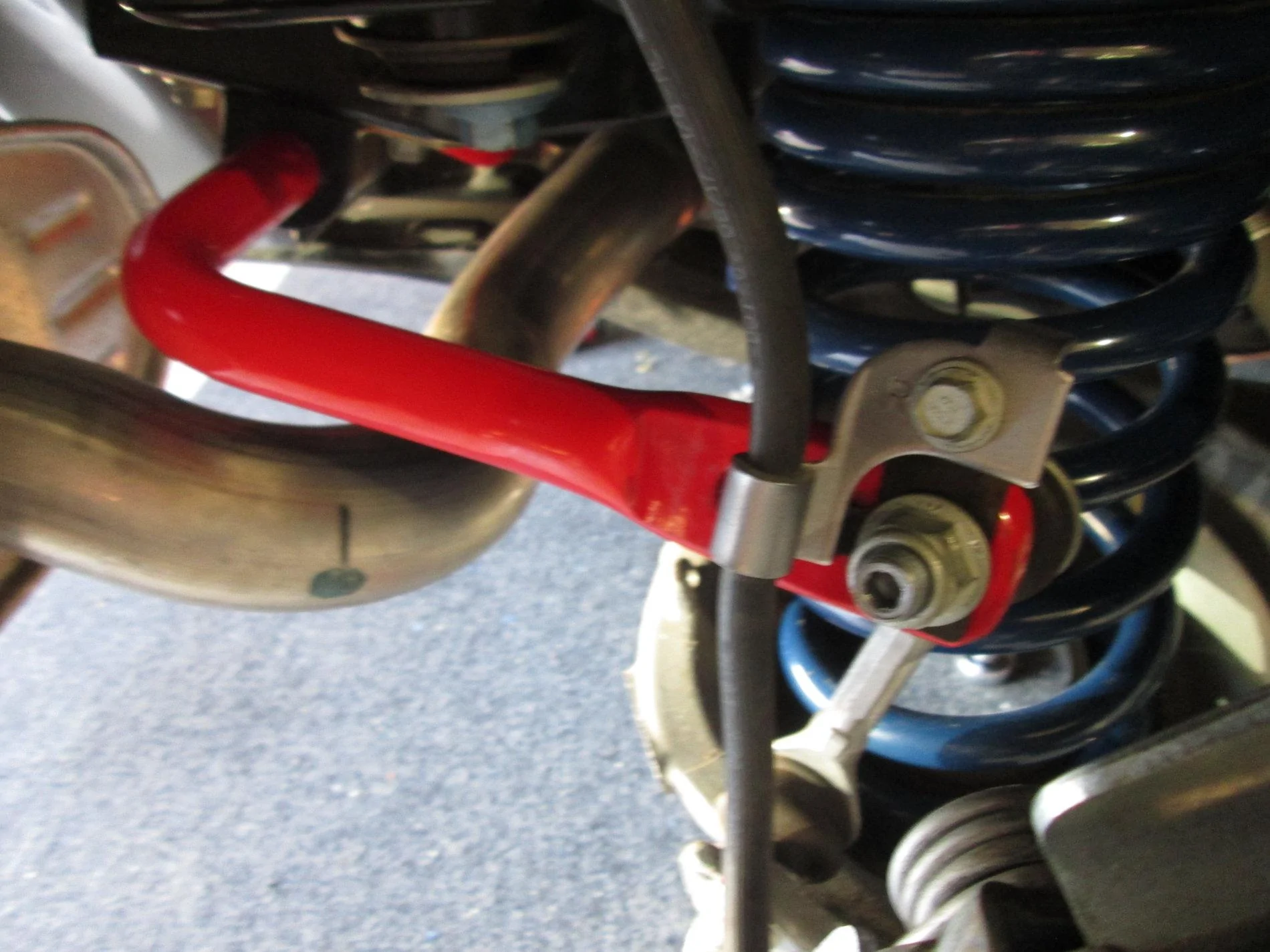

I have the Ford Competition Track shocks and struts kit with BMR performance springs and swaybars. Car handles so much better than stock and with the whipple kit the car doesnt squat on its ass like it did when stock. I have nothing negative to say about any of these mods other than the front swaybar is a bitch to install. LOL
