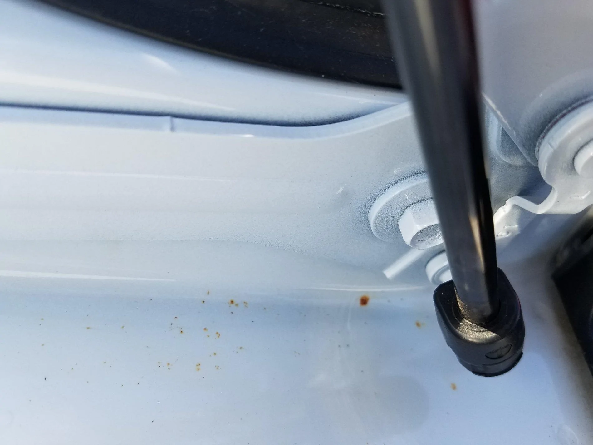

So I was loading some goodies into the trunk of my car today when lo and behold, what do I see? What appears to be surface rust spots along my trunk sides.
One side is worse than the other. If it isn't rust, it is PERSISTENT because I hit it with every solvent known to man and enough elbow grease to need a second person to come help. Now yes, I know Mustangs are famous for rusting around the trunk seals. But a NEW one? At 1,200 miles?
Has anyone else developed this yet? Am I wrong on my diagnosis? Is it worth a dealer trip?

Looks like rust, but looks like maybe from an outside source. Near any steel plants, manufacturing etc..
Apply some type of naval jelly on it every few days for a week or so. It should clear it up if its topical. Is that trunk strut leaking any fluid?

Try 0000 steel wool with a little WD40, buff lightly.

If it were me.....I'd take a piece of cut-up buffing pad (I cut up an orange Lake Country for use on stuff like this), and go after it with some compound. If it doesn't come off, it's not topical. Ford will need to sand & re-spray before it goes deeper.

Thanks for the replies guys.
I will see what I can do with some of your suggestions. Also, no, the strut does not appear to be leaking any fluid that I can tell.
I'll keep an eye on it. I know it's a small issue but I'd like to address it while it is still limited in scope. Will update once I get some free time to try a few things with it.

That looks like rust from some metal left over from mounting something, did you have to drill for a spoiler on the trunk,If so you will need to compound that area and remove the rust particles that were hot from drilling and attacked the paint.

That is not rust from the underlying metal, it is iron particles that have embedded into the clear coat, and are now rusting.
A clay bar should pull those particles out of the paint and you will no longer have this problem. Solvent, and/or buffing compound will not pull the particles out of the paint. A clay bar w/lubricant will. The car, more-than-likely, picked up the iron particles during transportation and/or while sitting on a dealer lot.
In short, this is nothing to get too upset over and it's relatively easy to fix. I wouldn't bother with taking it to a dealership for a warranty claim as they may make the problem worse with an incorrect attempt to fix it.

I get this on white painted cars only. Both our Si and Kia Forte have small brown spots in the paint. if you scrub really hard with a microfibre towel and soapy water it does come off. Just a royal pain in the a$$

It's just a product with phosphoric acid as its base ingredient. Phosphoric acid is used in many off-the-shelf rust removers, but I'd avoid using any on your paint. Hit it with a clay bar, and follow up with a paint sealant or wax. If it remains after that, you might need to resort to a chemical designed specifically for automotive applications; something from Adam's Polishes, Chemical Guys, etc.
