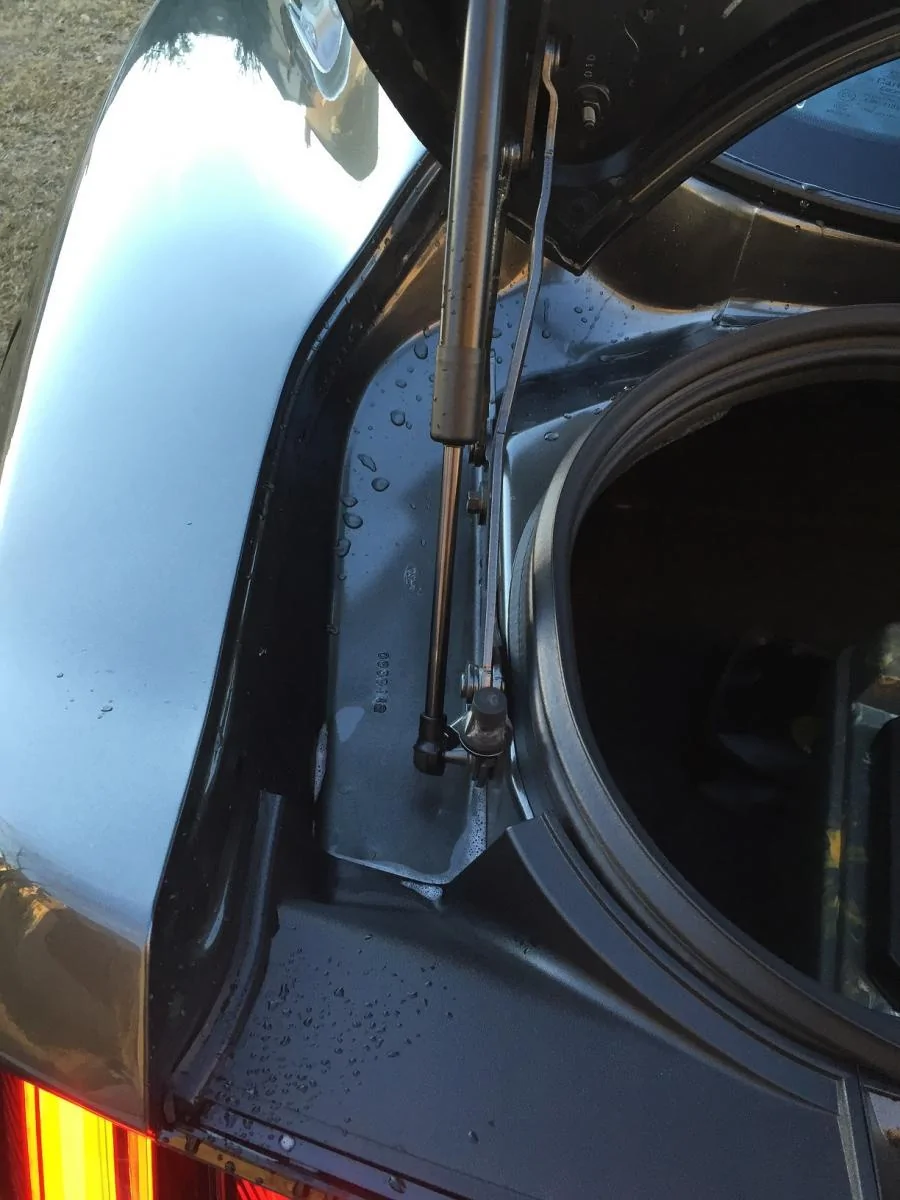

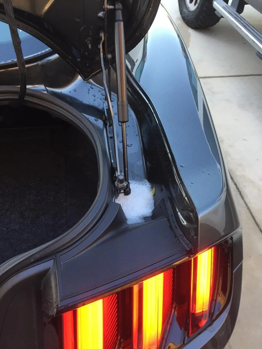

It isn't the same as door jams with drops of water here and there. I have the ring a MF cloth out twice trying to get all the water out of there. It's not just droplets here and there. It is literally a pool of water. When I wash it tomorrow I will take pics with a tape measure, but it has to be a good 3/4 -1 inch of water that just sits there. I get it, water is clear and hard to tell from the pictures, but it does pool.

On the right side taillight, does it fit tighter against the body than the left? That might be why water pools there. On my car it's supposed to run behind the taillight and out underneath it behind the bumper cover. The wires go through a sealed grommet behind the taillight. Pull your taillight away and see if this is where your water is supposed to go. Maybe dremel out a small groove in the edge of the taillight at the touch point where it meets the body. Make sure the trunk lid will cover it when closed. You shouldn't even be able to notice it if done right. You should be able to see the problem when you pull the taillight away. Just a suggestion.

Any vehicle, with a trunk or hatch, regardless of manufacturer will exhibit the same water accumulation in the "gutters" after heavy rain or washes... The water will drain out as designed. Usually when I wash my vehicles, I ALWAYS dry all of the door jambs, trunk gutters and also the front inner fenders (hood open). In fact, if you open your hood after a wash, you should also see the same type of water "pooling" (as you say) occurring on the tops of the inner fenders.
Now if you are getting water pooling INSIDE of the trunk, that is another issue entirely of concern...
