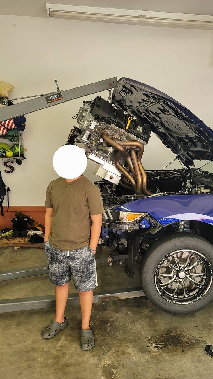

Pull it from the top with or without the trans. You can leave headers on. If you leave trans in the car, simply leave a jack under the trans or use a strap. There are holes in the rockers to insert hooks from strap.

This. If its just the motor especially with an auto Ive found it easier to unbolt the trans and just pull the motor from the top.
It's pretty straight forward. Unbolt hood, take off the radiator fans, take off cooling system, disconnect harness from engine, unbolt from engine mounts, take off exhaust past headers, replace manifold with lift plate, unbolt trans, unbolt ac compressor, pull engine out

Leave the hood on even.

Save a bit of time and potential damage to hood by removing and storing somewhere. Unclip hood strut if equipped, have someone push up on hood while getting engine into bay. The hood can almost go straight up and down, well beyond the angle of struts.
