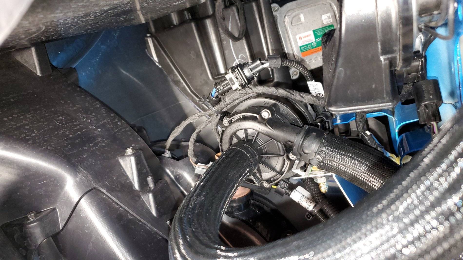

Well I got the Updated VMP pump on this Morning. Was able to access everything from just removing the lower air dam/panel. Was very easy actually but did have to modify the wrap bracket they give you. Flow does look stronger watching the Degas tank. Have not driven it yet.

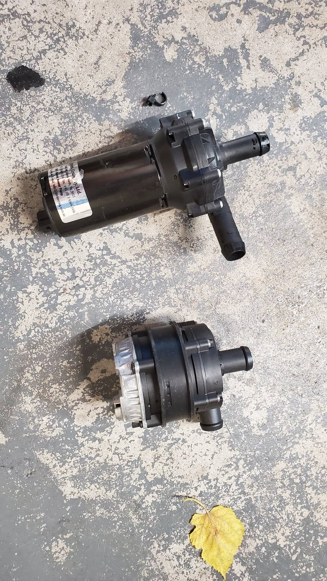

of the 2 pumps picture which one is te vmp and which is oem?
The short "VMP" one looks like the same as 2018+ Roush pump. Probably the same Bosch unit.
Yep, same one I got also. My issue ended up being a bad relay and not the pump.

That's cool that the 18+ already has the upgraded pump.
It did seem to help.
One thing for sure is that I have to fill the Degas tank almost to the top, otherwise, it seems to be able to suck air into the system.
