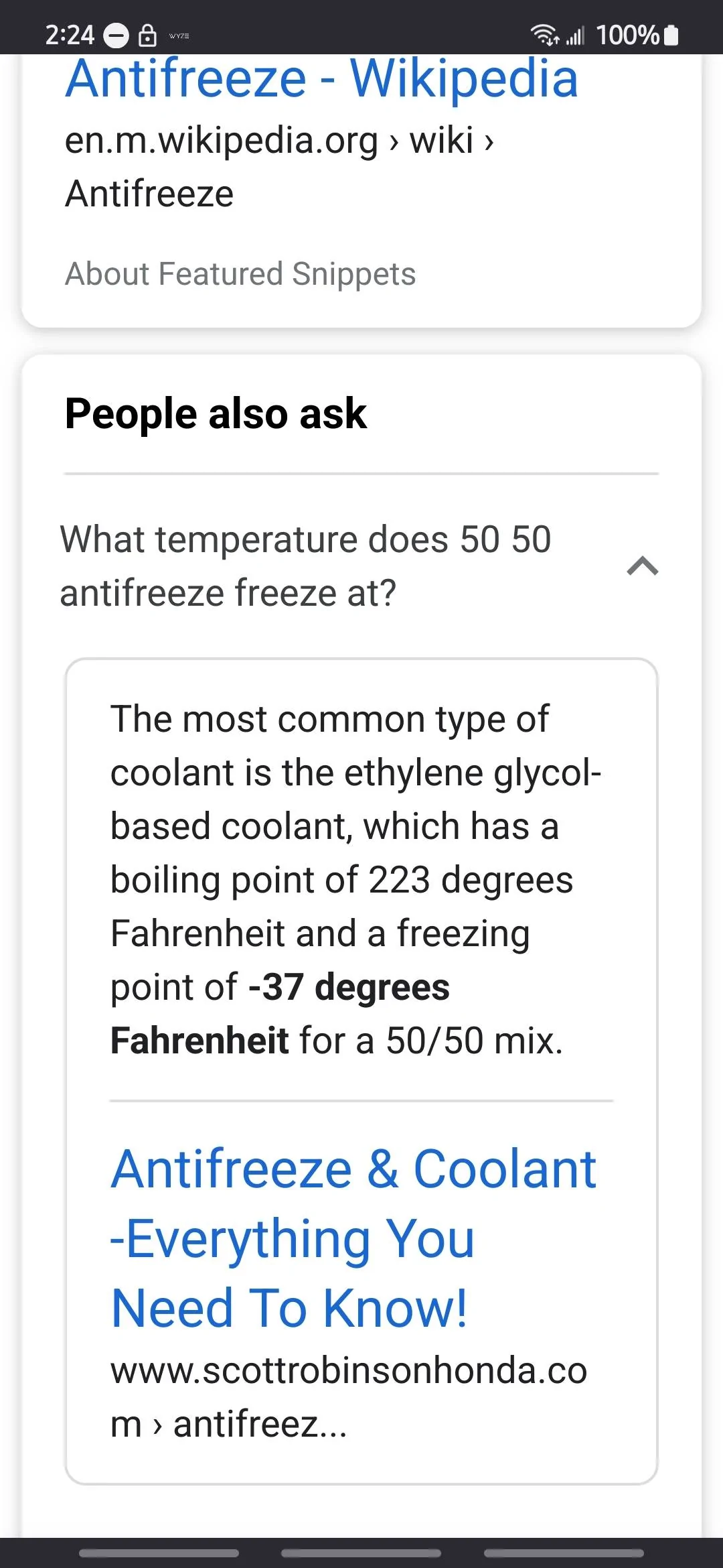

EFI
May 19, 2015
65
5,287
4,734
Masshole central
5.Br0
Does it get to -35*F on a regular basis inside that garage? Cuz that's the freezing point of such a mixture.

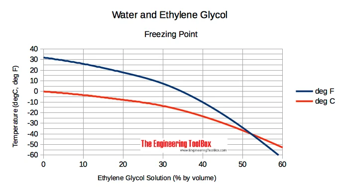

Angrey
Jun 21, 2020
104
2,794
2,984
Coral Gables
2016 GT350
As you can see, even a 40% mixture will get you down to around -10F. If it were me, and there was ANY chance of seeing deep cold (like MN) I'd rock 50/50 in the winter.
In the warmer months, a 50/50 mixture will reduce the thermal transfer of about 17% down to 13% (20C-80C). So it's a tradeoff between boiling point elevation and reduction in ability to move heat through the system. I'd recommend swapping to a Summer mixture if you flog the car hard and can afford swapping it out each year.
The boiling point elevation is important, but pure water doesn't boil until about 231F under 1.45 bar (the pressurized radiator cap). Most guys in hot climates simply run water with a bottle of water wetter.
