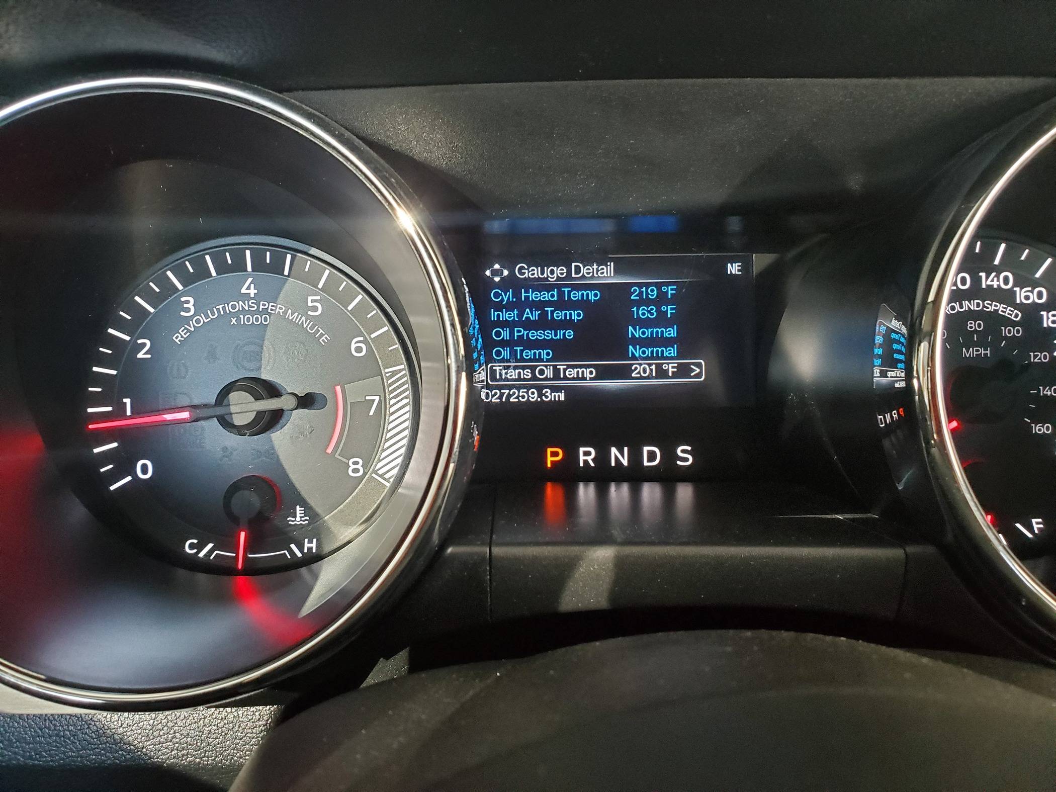

But ran into stop and go traffic. Like down to 5 -15 for around a half hour.Kept my eye on gauges car was at approx 205 - 209F. Good stuff, its about 70*F Ambient.
But when I parked in my driveway temp gauge read 219F.
Fan not on. But coolant temps seem normal. He said Whipple sets fan settings at 190 then 223. (Pic) What would cause this and is this normal for those fan settings?
I've never ever saw my gauge past 209 before.
If aiming for 212F OP Temp what would be a good second temp setting?
And my reason for posting is this car safe to cruise around in till tuners shop opens again??

I wouldn't worry about it. Big heat pump sitting on the engine idling without airflow coming through the RAD.
Exactly this. Look at your IATs in the pic. 160. Surprised your head temp isnt 350 degrees. Lol 160 is crazy this time of the year.

I'm sitting at a stop light and watching the temps climb. From 206 up to 217 just sitting at a light.
I've never seen this before and it's not even 70 degrees out.
Whipple sets the second fan at 223 that seems high to me. I guess if 212 is operating temps I'll get him to lower the second fan a bit. Do you know what a good temp would be to set the second one at?
Thx
Can you verify the low speed is running at all before it hits 223? I feel like it should be.
Also the IAT is really high, but idk where it's measured on the Whipple setup. If it's pre heat exchanger it doesn't matter that much.

I didn't notice the IAT. You need to check the heat exchanger system to ensure it's free from all voids and what not. You shouldn't be seeing those high of IAT2, especially if you're bypass is working properly. Check that the bypass is properly working and check the intercooler system to ensure it's burped.

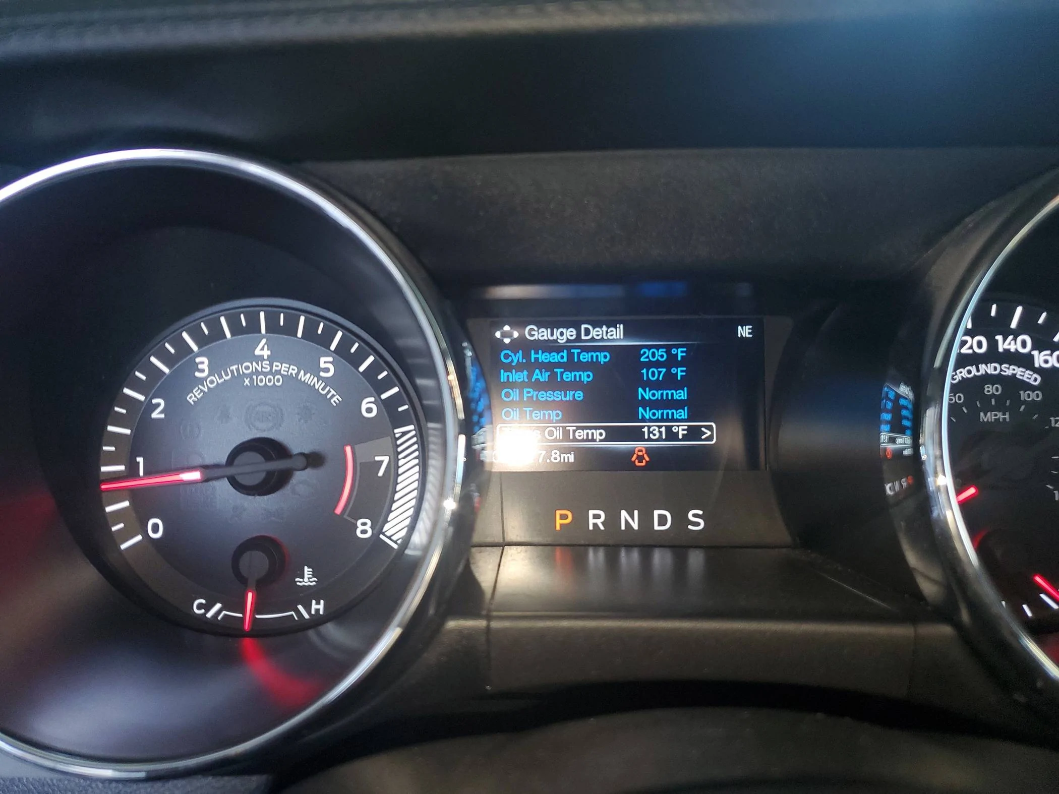

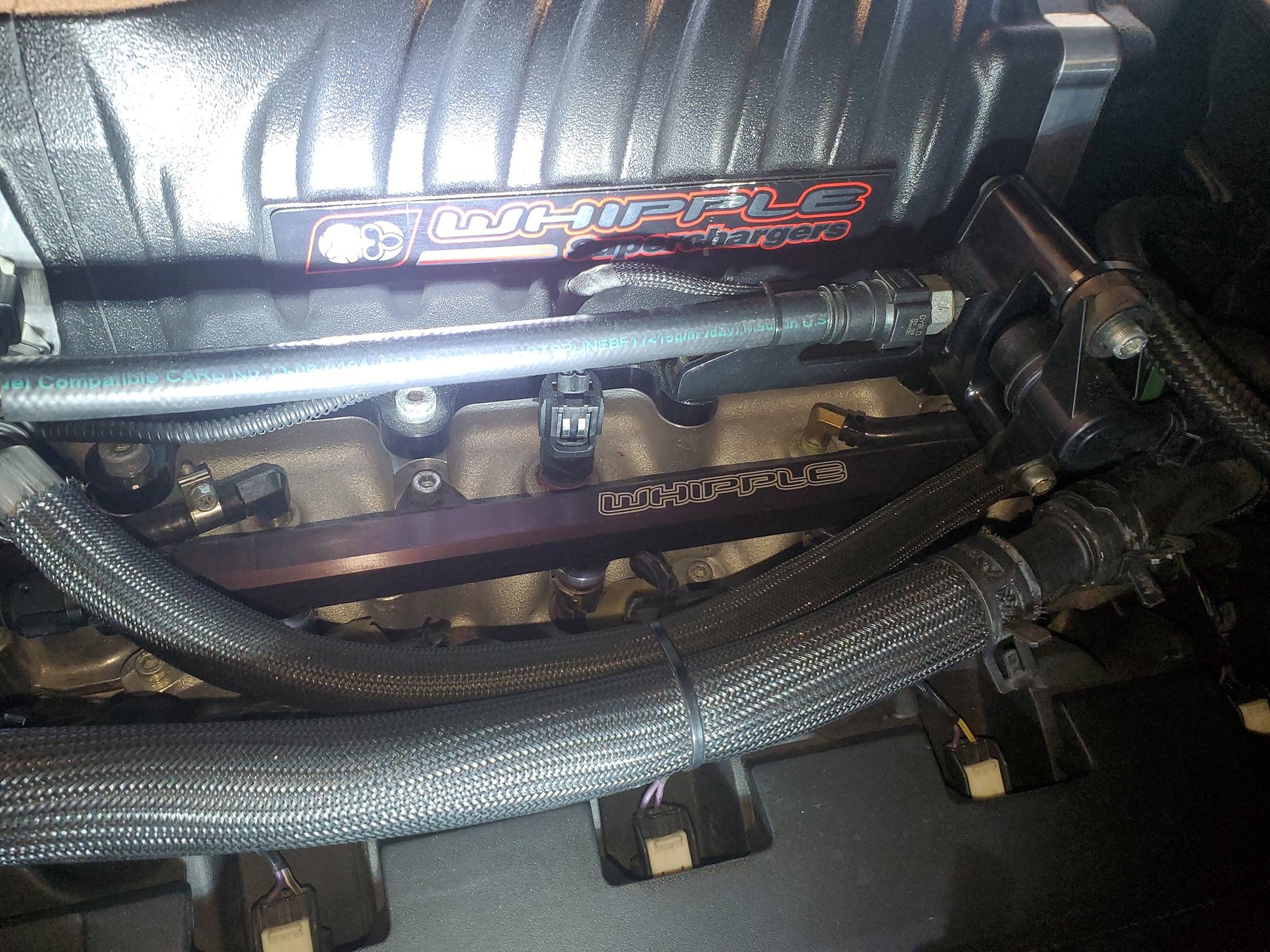

Good call I just let it idle for about 7 mins temps just continued to climb to 207. Then I turned if off. Low speed fan never came on once. There is an IAT2 Sensor on the manifold if that's what you meant. Pic
I think the issue here is probably a tuning error. He may have forgotten to set the low speed fan to come on at 190, so you get no fans at all until high comes on at 223. Which isn't necessarily a huge issue or anything, but it's sub optimal. On a stock NA car the low speed doesn't come on until around 212 coolant temp, so it's not too far off the stock behavior.
So it's fine, but personally I'd want to run a whippled car cooler in general to give yourself more margin to play before heat soak sets in.

IAT2 at 107 sitting still is fine. Nothing to worry about. In 100degree heat, you'll see it get up to 130 sometimes while sitting still.
