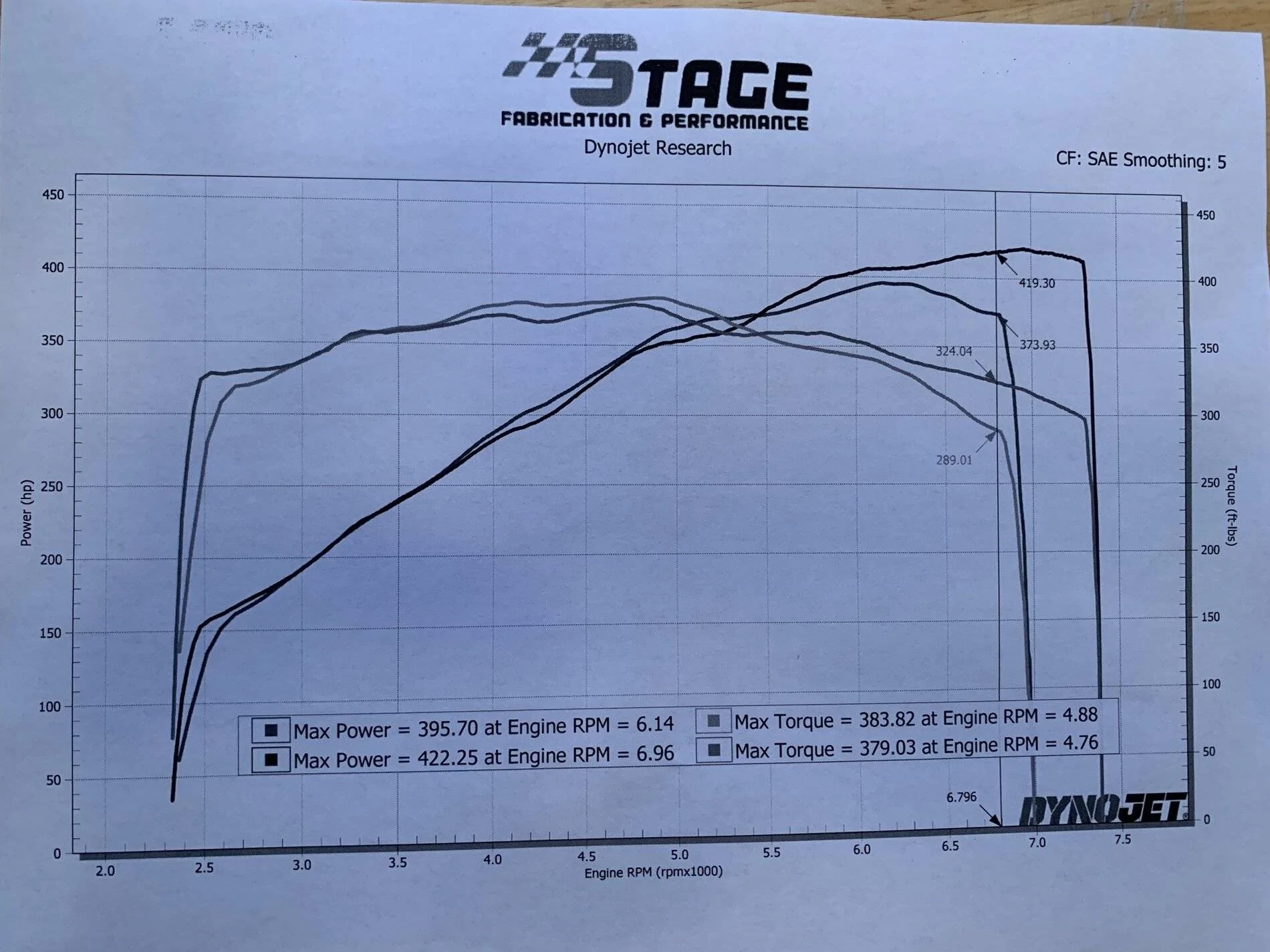

I posted this reply in another thread a couple of days ago.
I’ve just gone down this route.. Had the PP2 install for a few years on my 2015 GT. wanted a bit of extra, especially in the rev range extension.
I installed the GT350 Intake manifold and had a local tuner make a full Dyno with HP tuners tune.
Realized almost 40 HP increase @ 6800 rpm and extended the rev range to 7500.
I haven't taken the car on track yet for a comparison of gear changes and lap times, but I'm expecting to hold gears longer and fuller through sections of the lap.
Dyno runs, before and after below..
Bear in mind, this is going from PP2 install for the curves.
Thread here:
https://www.mustang6g.com/forums/threads/how-to-add-more-power-to-power-pack-2.151588/#post-3096591

Thats a real nice gain and no real loss in torque.
The 18 truck manifold has slightly shorter runners than the 17, it also has more runner volume. I'm close to testing a 18 truck manifold on a 17. I think it will outperform the 17 GT manifold all the way through the RPM range.
My sim program likes it, now to see if the real world agrees.
