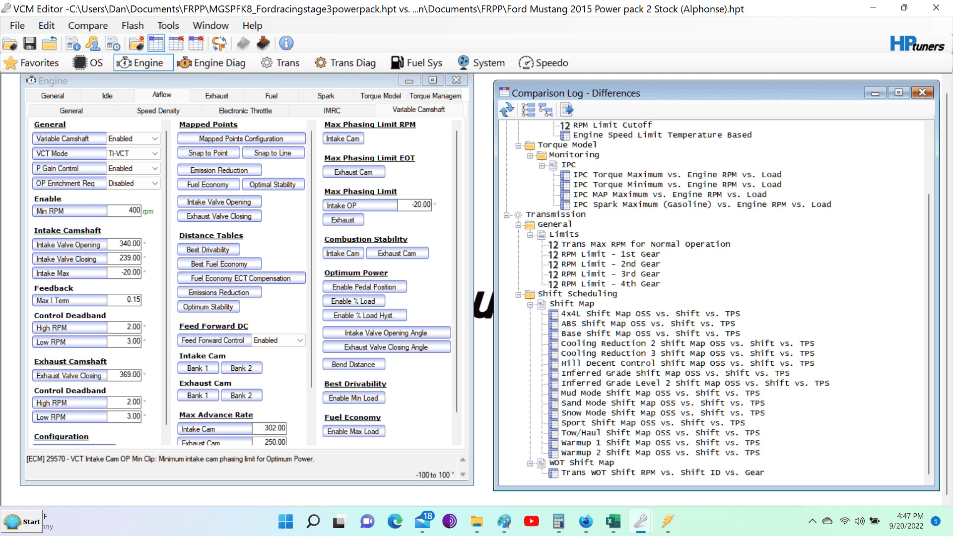

Also there are several differences between the pp2 and pp3 file. Here is a list of some of the differences. This is for the automatic transmission

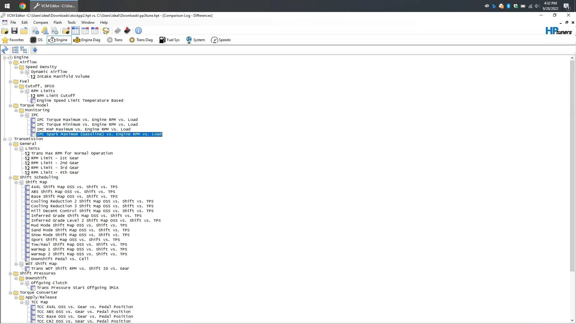

Just pulled up both tunes. The only differences are in SD the manifold volume is changed.
Temperature based RPM limit is changed, some torque limits have been raised and trans RPM limits have been raised.
Nothing critical to the running of the engine.
