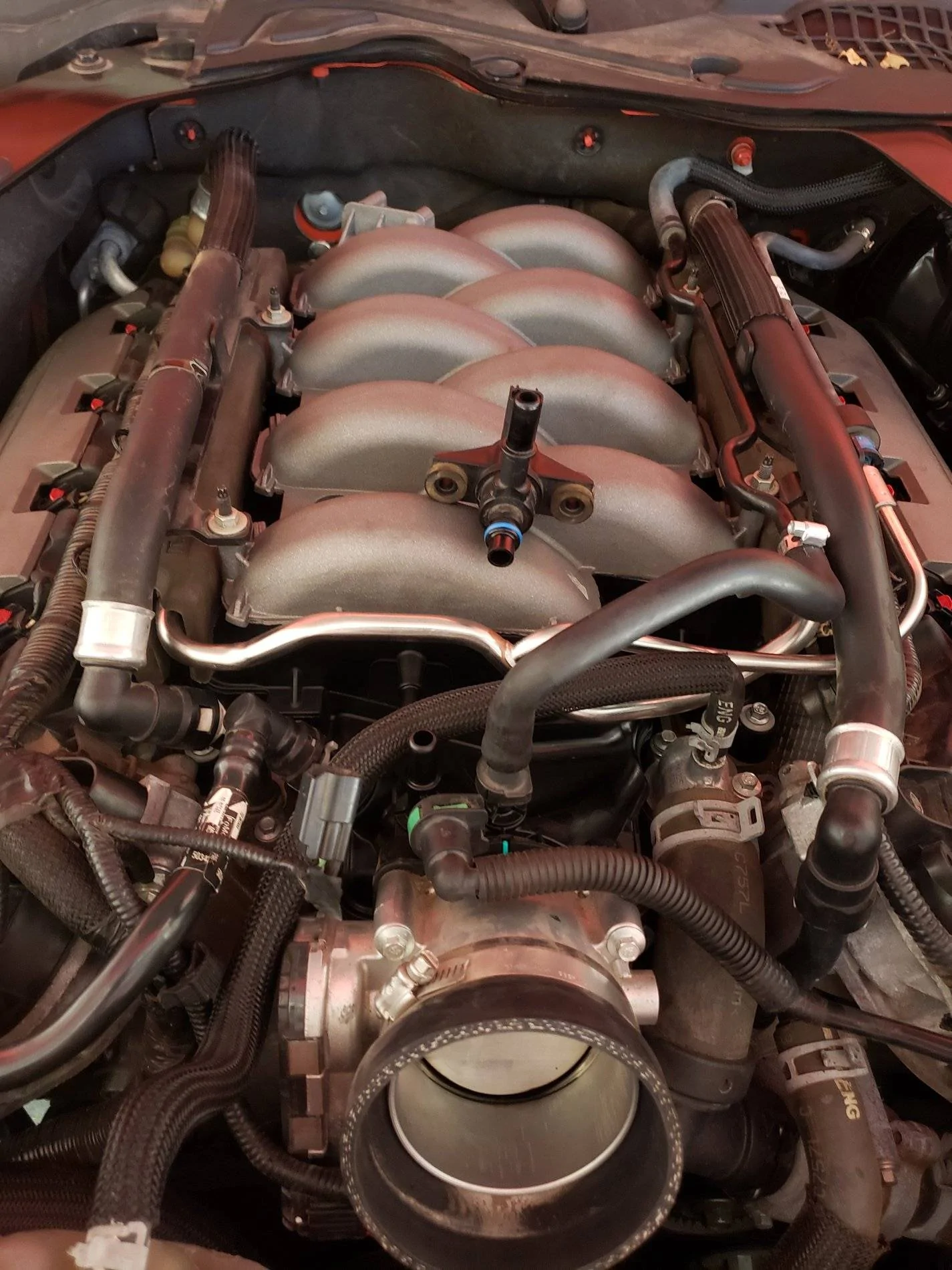

I'm towards the end of this install but I want to make sure that I don't mess up this last part. I have the line with the green button, one nipple on the 18 manifold and the connector with the 2 nipples from the 15 manifold left.

Just hook up that evap and make sure you've capped the other two, assuming you're using lockouts.

I am still a bit confused. Is the evap the one i have connected going to the brake booster?
Are you saying cap off the 2 remaining nipples on the 18 manifold?
Yes i am using lockouts and its a manual if that makes any difference
What happens with the hose with the green button and the electrical connector that i have hanging?

Evap is the thing you have laying on the manifold, not connected in photo. That needs to be fitted to the port right next to the brake booster, then connect the wire clip. The ones to cap are at the rear and front.

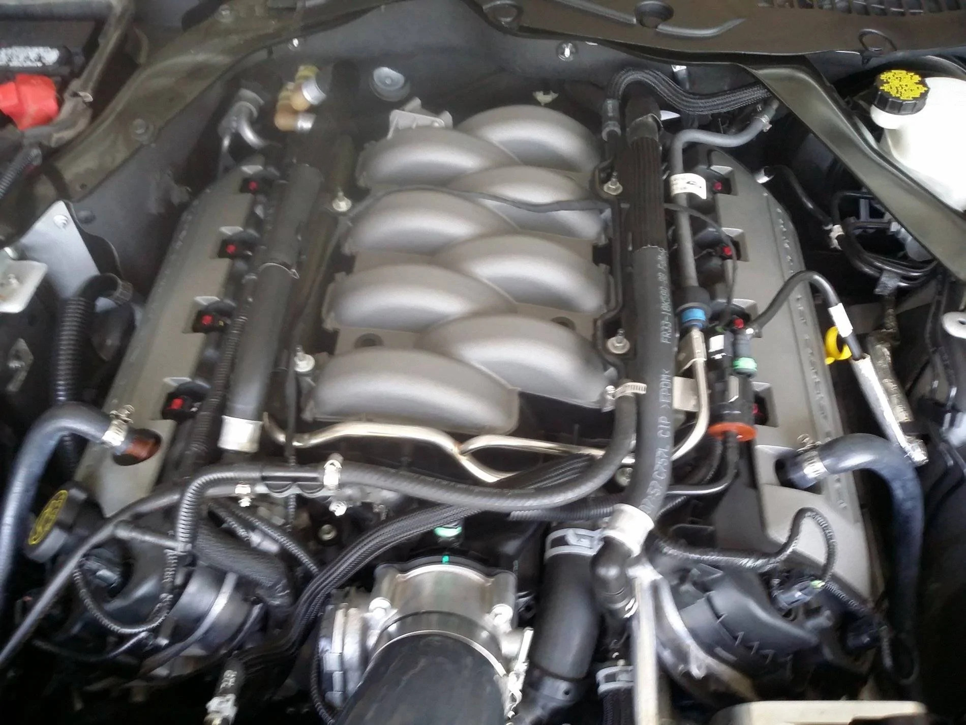

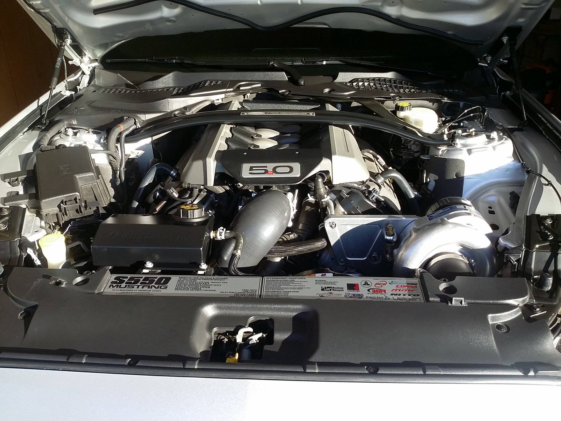

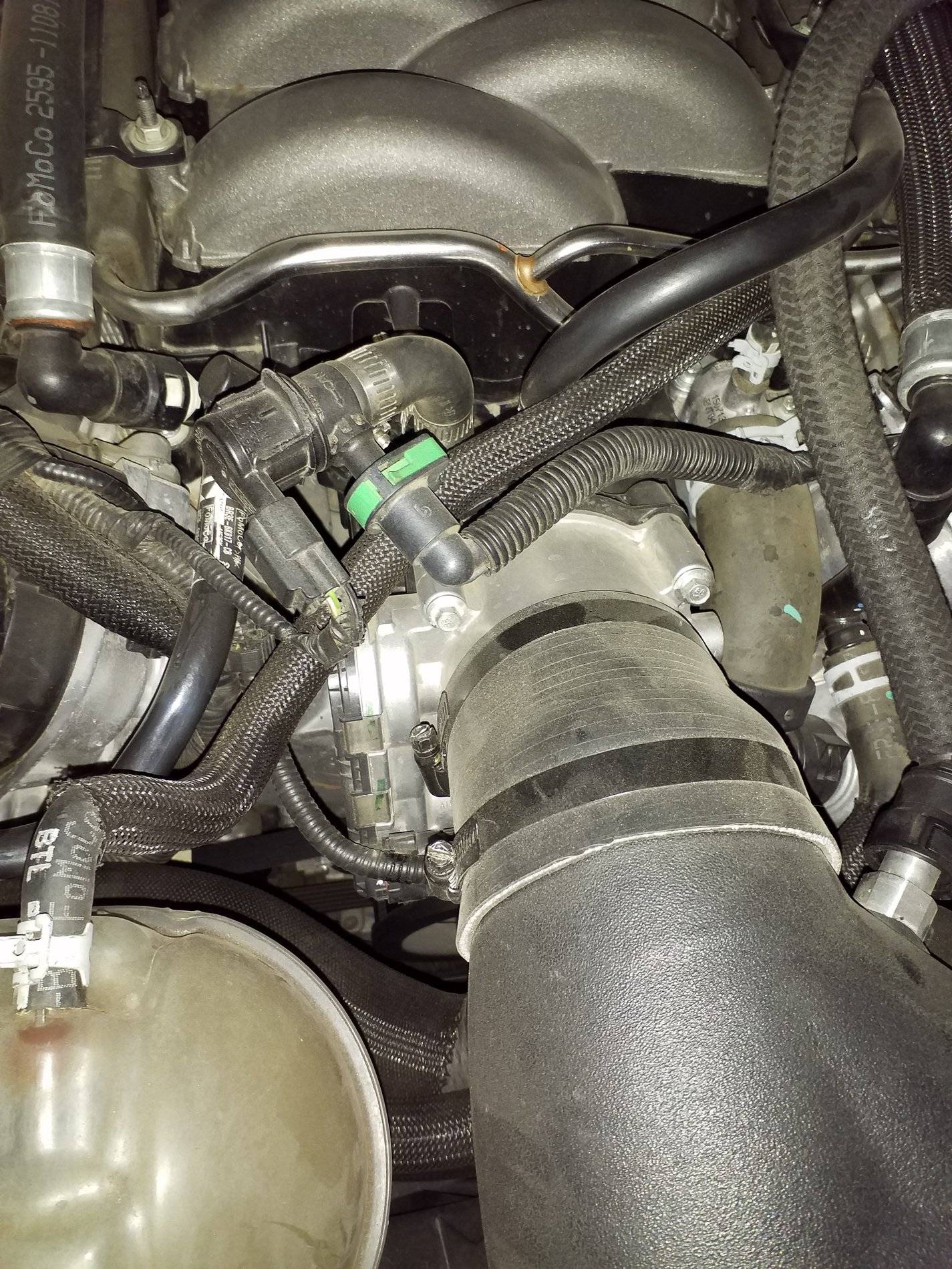

I'm a hour and half north , but if want to get out of the valley come on up . Some pics of how I did mine . Alot different then what most do .
