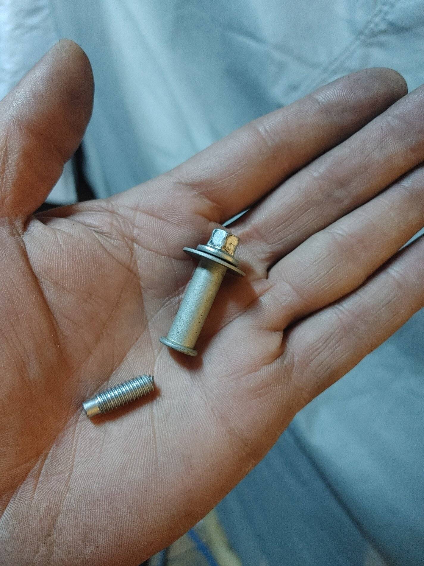

How do you take the intake bolt out of the intake ? Moves freely, but it wont pop out ! Thanks !
Edit they pop out. Anybody know what size bolt extractor to use ?

Got it out. Used a old school trick. And put back together now.

Haha. Went to retorque everything (100 in-lbs + 30* turn which is roughly 125 in-lbs) after a few hundred miles of driving, All went click, and the last to check one spun like it was loose. Then snap. I was like fuck haha. I'm amazed that 4 hours after my initial post, not one comment, or gave some piece of advice, except yours buddy haha.

Hit it with some heat with a propane torch. But not on the broken bolt, on the aluminum around the bolt then blast it with wd40. Then with a small flat blade screwdriver you should be able to unscrew it easily.

I broke mine last week. Soaked the broken stud in pb blaster and used different size screw drivers and slowly came out with patience.
I replaced the screw and spacer with one from the old manifold. All good now

I know how to get the bolt out of the head lol but how did you “pop” out the spacer and fasteners from the intake itself?

Press it out. I used a 6mm deep socket and gentle tapped it out of the intake.

Did the bolt get stuck in the engine and if so how did u get it out here's what I'm working with
