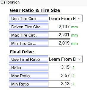

The key to the above is "Learn from" Stock is is set to learn from the BCM so any tire in the min and max range will cause the car to self adjust.
If you want a tire outside of the stock range you will need a tuner to change the min or max setting.

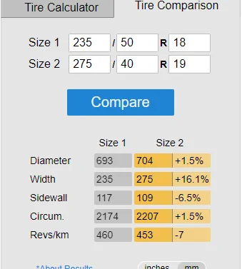

@K4fxd Here is the comparison between my stock size and the 275/40/19 I am considering. Looks like the cc on the 275 is just outside the max range of the tuning software. Is that tuning software you show from FORscan?

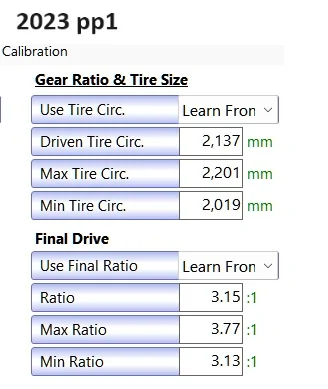

I was wrong.
As long as the switch is learn from BCM it will self adjust. The min and max are only
used if the switch is set to calibration.
I am posting a pic with it set to cal and also a stock 2023 PP1 cal
