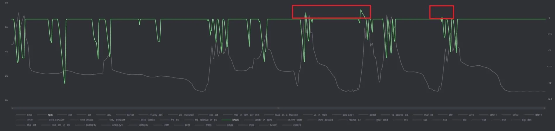

Edit, here’s a log I loaded up in case anyone would like to review it. I would very much appreciate input
https://datazap.me/u/manbearpig/16gt-lth-jlt?log=0&data=1
Had a look at your logs. Here's what I saw:
  • Net fuel trims at WOT are within 4-7% which is fine (combined STFT and LTFT). AFR's are in the 11.9's-12.0's which is fine on E85 which I can see you are running.
  • Overall at WOT, timing builds slowly towards a peak of 31.3, knock is stepwise more negative as RPMs increasing noting timing is being added to meet the targeted total and the saftot (total timing after all corrections) increases smoothly.
  • The only knock really I see is a bit of tip in knock when you go heavy on the throttle suddenly. It resolves quickly and timing is added pretty smoothly up to peak and only drops in between shifts, then grows again. This is healthy.
No concerns really that I see sir. If you "perfect" the LTFTs now, they will just change when the weather gets hotter, or colder. Dont chase an endless race, just make sure they are within 10%, AFRs are healthy and knock is in control and you are golden sir.
Below is a graph showing where any knock (positive numbers for knock counts, nothing more than 1-2 degrees tip in really showing) are occurring, all right at the tip in of throttle and quickly decreasing to negative values (adding timing).
Thanks very much for the review. What makes it look like this is on e85? I’m on 93. I know I see a lot of spark on 93 but assumed that’s just because my pump gas is quite good.
I don’t usualy look at AFR, but monitor lambda, which hovers around 1.0 except for WOT which is .83-.85, which is what is shown on this log. Where are you seeing the AFR’s of 11.9-12.0 at, I can’t even find that parameter here.
I don’t usualy look at AFR, but monitor lambda, which hovers around 1.0 except for WOT which is .83-.85.
Lambda is commanded targets while the AFRs are measured from the O2's. If your AFRs are good and trims combined are less than 10% per bank, you should be fine. Ignore the E85 comment, had a brain fart lol. The AFR multiplied by the stoich of the fuel you are using shows your actual AFR. That doesnt tell me what fuel you're using, my brain is jammed today.
0.85 x 14.1 (pump 93) = 11.985, very safe.
Thanks again. I keep getting hung up on the trims. I guess I hoped to see them within 2-3%, not 5-6%.
Is rescaling the maf as simple as taking 2% fuel out? Maybe there is more to revising the tune to get the trims tighter than I realize.
No prob. Just ignore the trims if they are less than 10%. The OEM tune and codes dont show until you hit 15-20% off anywho. It all varies with temperature, altitude/pressure, humidity, etc. Your logs look good, have fun with it!
