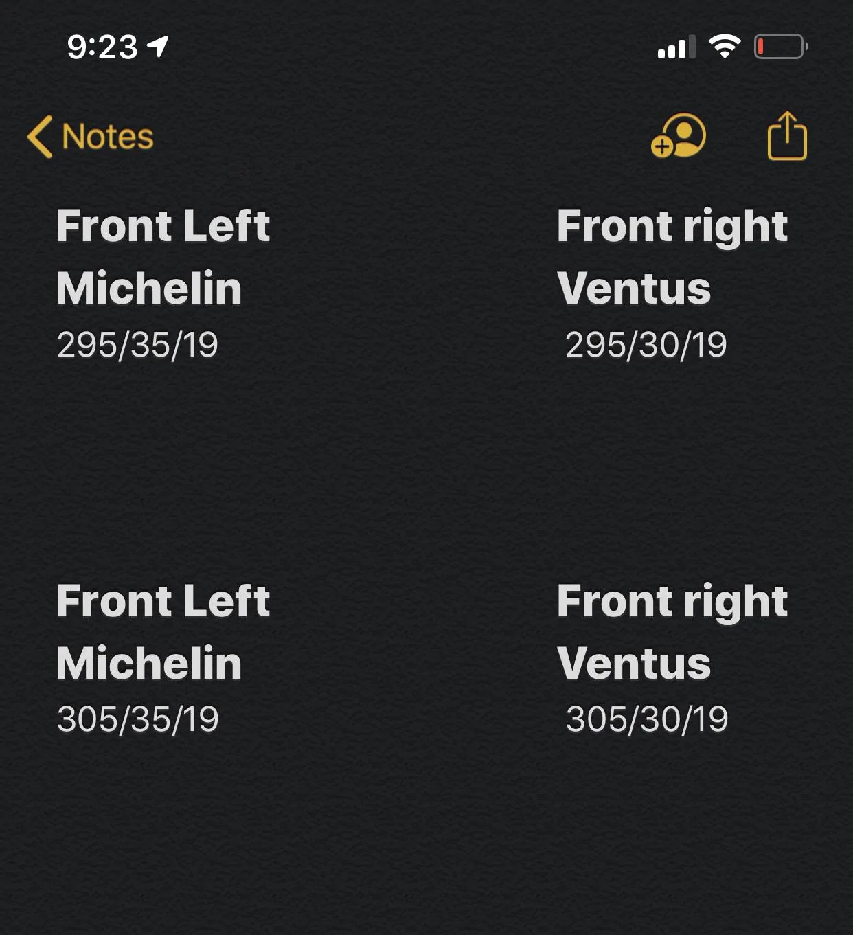

So I bought the gt350 wheels with these tires there from the parts farm they came mismatched before I had the stock mustang gt wheels 235 all around
The 235 all around where not mismatched

Wow what a mess. I just realized these aren't a square setup. How did you end up with this tire setup anyway? Was it part of the "deal"? You can't have different sidewall ratios on opposite wheels like that.
I would see if you can get a deal on tire rack and have a shop mount a new setup on those wheels.

I just realized what it might be the tire ratio is different
Do you really have a 35 profile on the left and a 30 on the right? Absolutely the car will pull right if the right side tires have a smaller diameter and shorter sidewall. A 295/35 tire has a 27.13" diameter, and a 295/30 tire has a 25.97" diameter.

Wow, were those wheels taken from the same car ?
I'd get those wheels refurbished, rebalanced with new tyres and the tracking checked.

Scroll up and see his image. The sidewall ratio is different between the left/right, and he's not square (meaning the tires in the front are narrower than the tires in the rear, which is typical), so this can't be fixed by rotating the tires. I run two different sidewall ratios, but not side-to-side. Only front-to-back.
It should be obvious that alignment can't fix this type of an issue. These wheels need new tires, balanced, etc.

Yeah, he needs 4 new tires I'm afraid before it drives right again. Even he buys only two, the differing wear and tread depth will still cause a pull. 4 new tires, start again.
