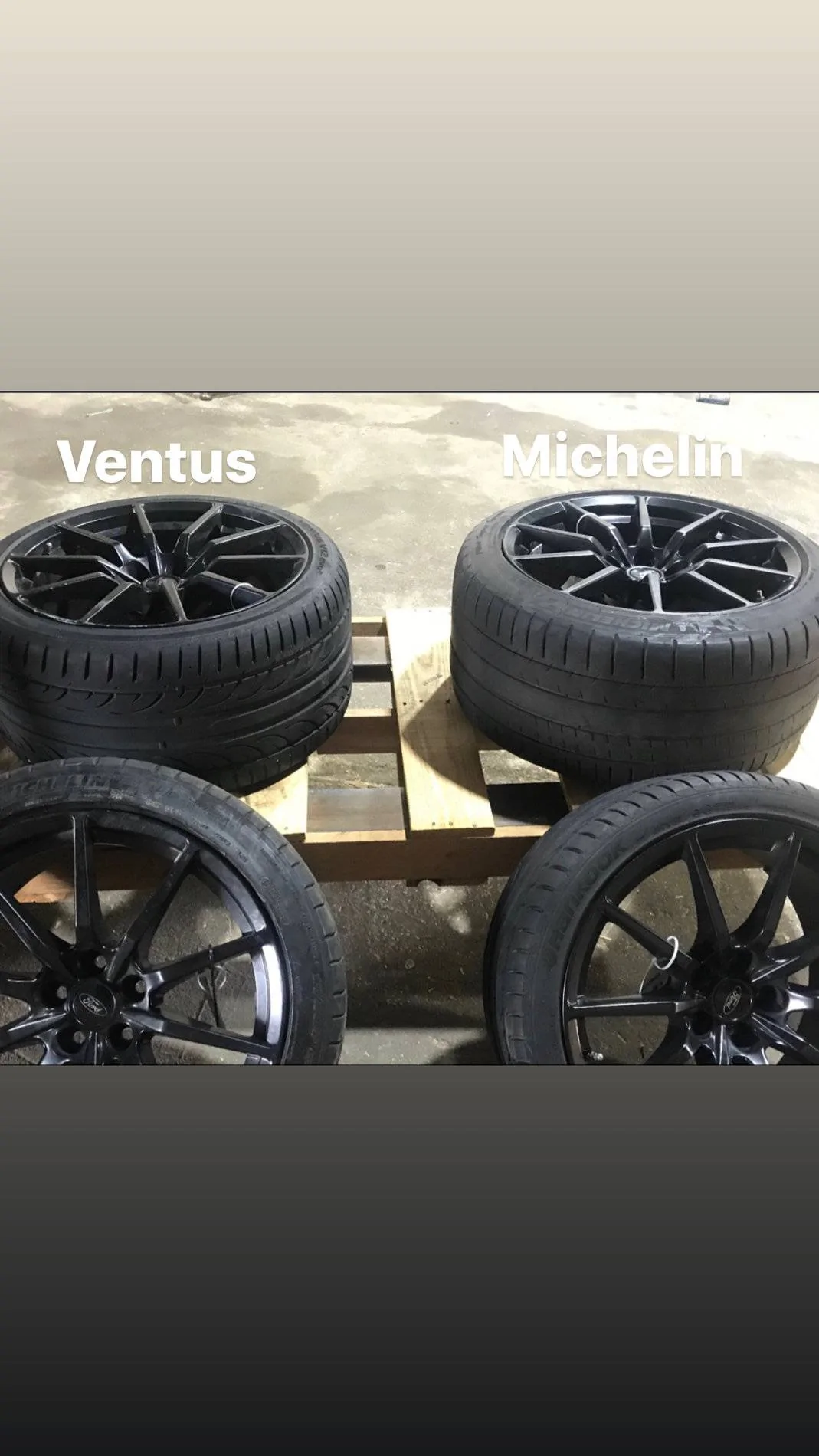

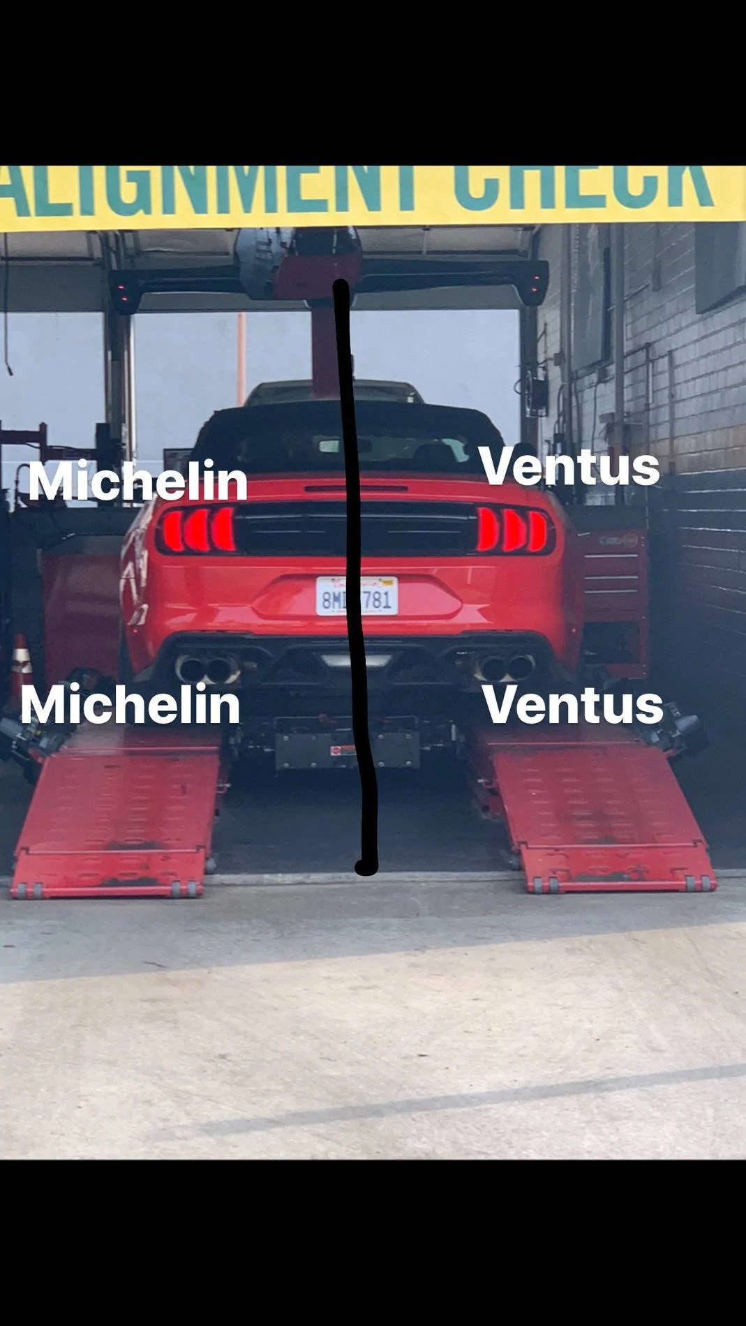

could it because the tires are mismatched on each side? I got 2 Michelin’s on drivers side so front and rear drivers and two Ventus on passenger front and rear they have a different tread pattern
That could definitely happen. If the tires have a different diameter (due to wear or otherwise) or have differing amounts of grip (such as two different model tire) side to side it could cause that.

Were your tires mismatched before? If not, there's your problem. Uneven camber may not induce a pull but it can in some situations.
