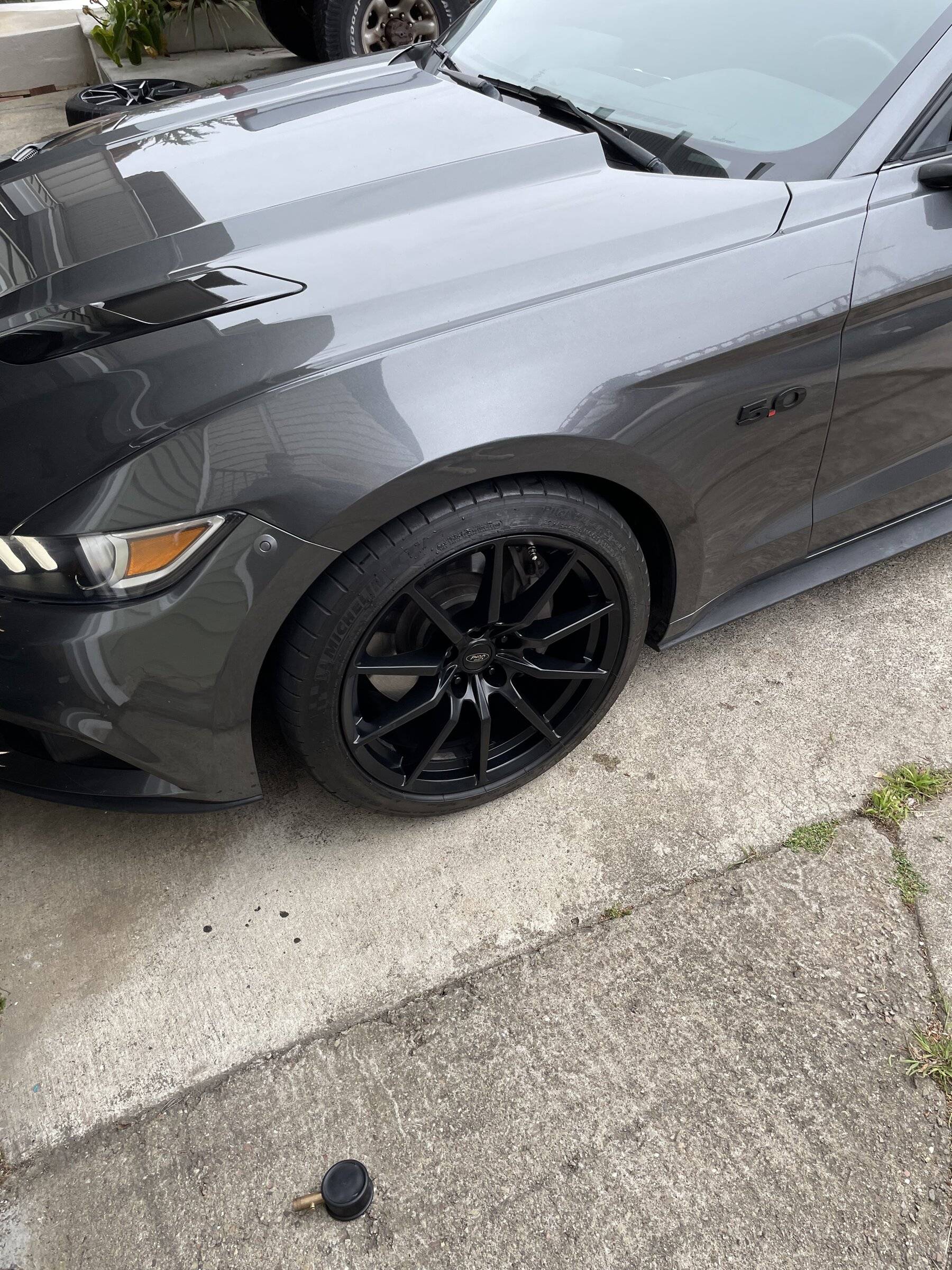

Sure, I’ve only got pics of the rubbing side. Yep, aware of the fenders. I’m just trying to stuff these wheels under my car for aesthetic purposes hah.
I haven’t got rubber for the wheels yet so I’m not completely married to them yet. If I can’t make them work they’ll be sold.
The angle isn’t clear but there is hardly any poke, the very edge of the wheel and stretched sidewall of the 295 PSS are the only things poking.
I’m okay with the poke, as I like the look the GT350 wheels provide. I’m debating on just getting some alignment bits for the front (plates or camber bolts) and going for -1.75 or -2 degrees of camber on both side which should draw it in enough to get it off the inner edge of the fender.
My other concern is the strut - I never considered taking a grinder/hammer to this car but if I need like 2mm of clearance it’s crossing my mind hah.
I don’t have a warranty on this car so I’m open to trying whatever to fit these things before I buy some rubber.

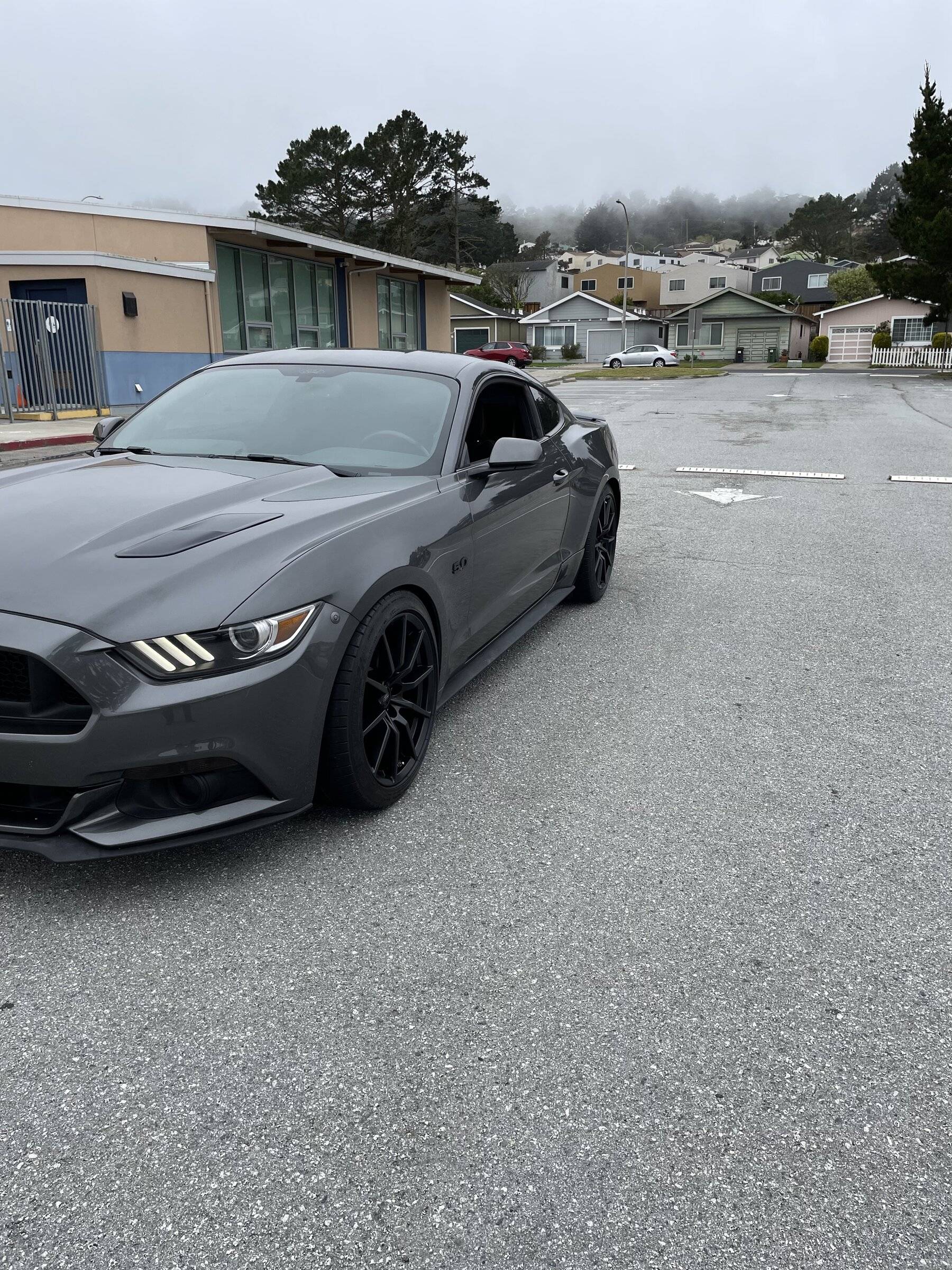

The rears almost look sunken in. Fronts look nice.

They are, I don’t know if my subframe is out of wack or what but my car just swallows the 305s on the 19x11s. I’d have double check my strut clearance but I could honestly go 325 30 19 I think in the rear without thinking twice.
Edit: The fronts look great, looks very trackesque (I made that word up) and beefy without poking too much. Partially why I’m not even bothering with thinking of fender replacements.
