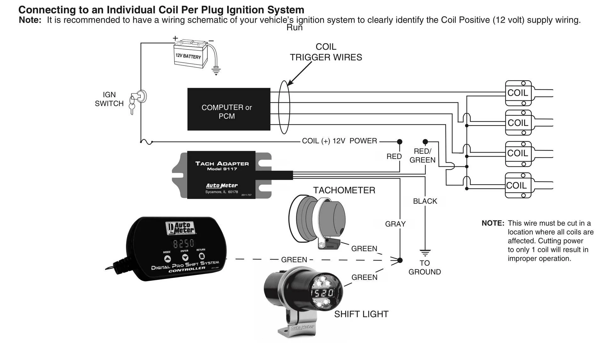

who's put in a real tach into these cars?? do you need a tach adapter or can it wire into the stock harness somehow. if so how? I've got an Autometer sport comp playback tach I want to put in just mainly for the shift light. I can get the playback data off the datalog.
The 9117 worked for my Gen3. It does require you to cut the common coil power wire. I cut it on the supply connector. That way I can swap engines and ECUs without cutting again.
Not a gen3 not a 5.0 not even a v.
I do have the 9117 ordered.

Why didn't you just buy a Holley shifter light ? It plugs directly into the obd2 port.
Data logger plugged in to it. The splitter doesn’t work with it either
