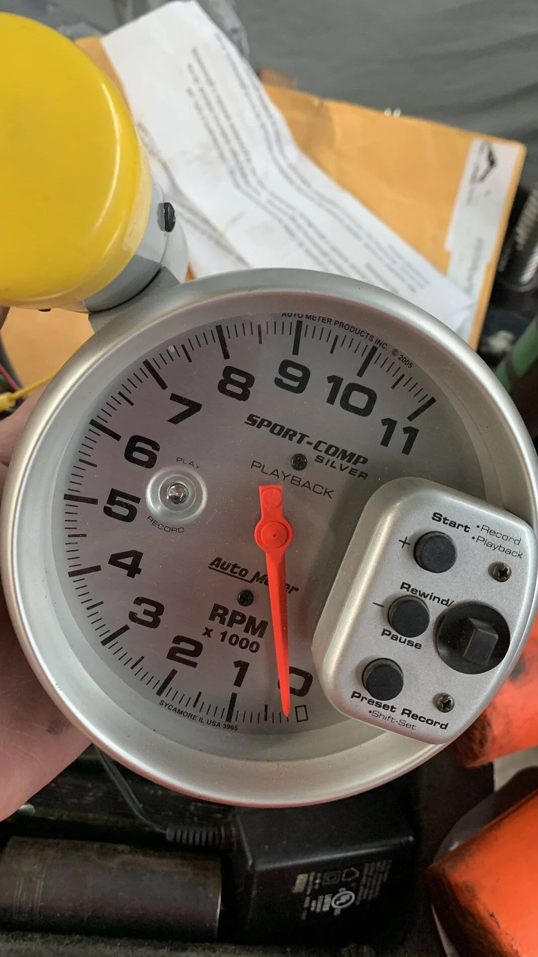

who's put in a real tach into these cars?? do you need a tach adapter or can it wire into the stock harness somehow. if so how? I've got an Autometer sport comp playback tach I want to put in just mainly for the shift light. I can get the playback data off the datalog.

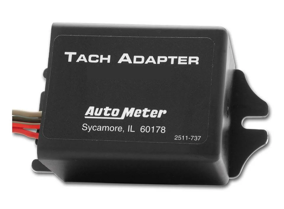

Autometer 9117 should be what you need.
DESCRIPTION:
This fully potted, weatherproof module can be wired into the power supply of a coil per cylinder ignition system, where it senses current and creates a conventional 12V square wave signal output which can be utilized by AutoMeter tachometers and many aftermarket RPM activated devices. Ideal for vehicles with late model engine swaps and applications where conventional tachometer signals are not available.

I installed a Nitrous Outlet progressive controller in my 2019 Bullitt which reads rpm. I didn’t use a tach adapter. I only had to tap into the coil negative wire to get the signal (used the #1 coil negative wire purple/white).

I have but the tach bounces wildly making it unusable.
At speed its even worse. We installed the tach digital adapter kit, also installed the autometer resistor kit as recommended by Auto Meter and made sure all connections were solid.
The tach is connected to the coil wire (we tried both sides) and engine ground....all of the right things yet I still have this bounce.
I'm out of ideas....
EDIT: Although I have an s197 it has a gen 2 Coyote in it so the engine harness is the same as the OP.

I don’t have that issue with bouncing rpm. Mine is smooth and steady. I soldered an extension wire onto the factory coil negative and put a quick connector on the end to plug into my controller.
