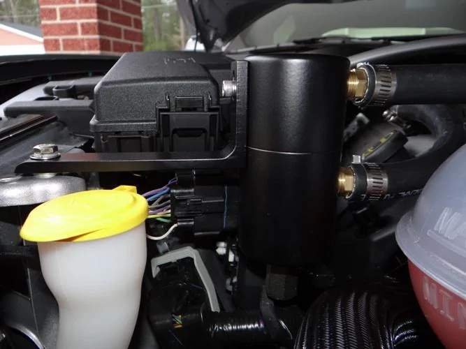

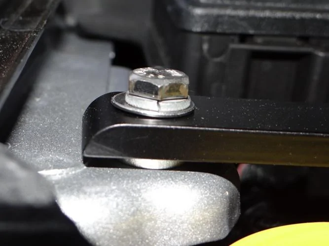

I installed my Bob's Air/Oil Separator as soon as I brought the car home. Customer service was great, the package shipped quickly, it was packaged well, the quality seems to be excellent and it was a pretty simple to install.
I didn't like the location in which it was supposed to be installed so I "moved" it to the passenger side just in front of the fuse box. There was already a hole stamped from the factory so I didn't have to drill any additional holes (bonus). I'm probably over-thinking it but I didn't like how it installed between the ground connection and the body of the car because of any possible grounding/electrical issues.
I also think it actually looks cleaner in this position. The only issue I ran into was getting the bracket to sit level (aesthetics only) so I put a washer under the bracket. I've seen some folks installing their catch cans further forward closer to the front of the car and the radiator to keep it cooler. I may try this if I find the can getting pretty hot. I haven't drained it yet but I plan to after the first 2000 miles which I think Is about the average from what I've read on this forum.

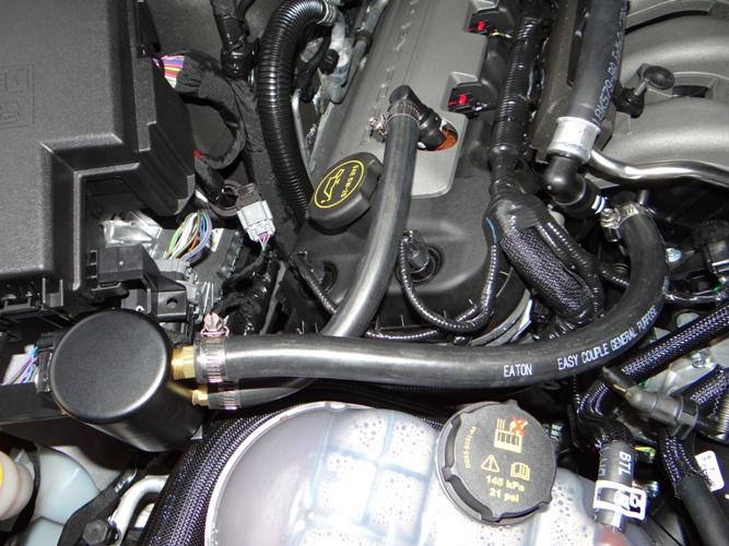

I just reinstalled my Bob's can on the passenger side of my 14 GT. I had been running the Ford Racing one and when I went to drain it today, I checked the line coming out of the can and it had liquid oil in it. My Bob's can has never had liquid oil in the exit line plus it's way easier to drain.
