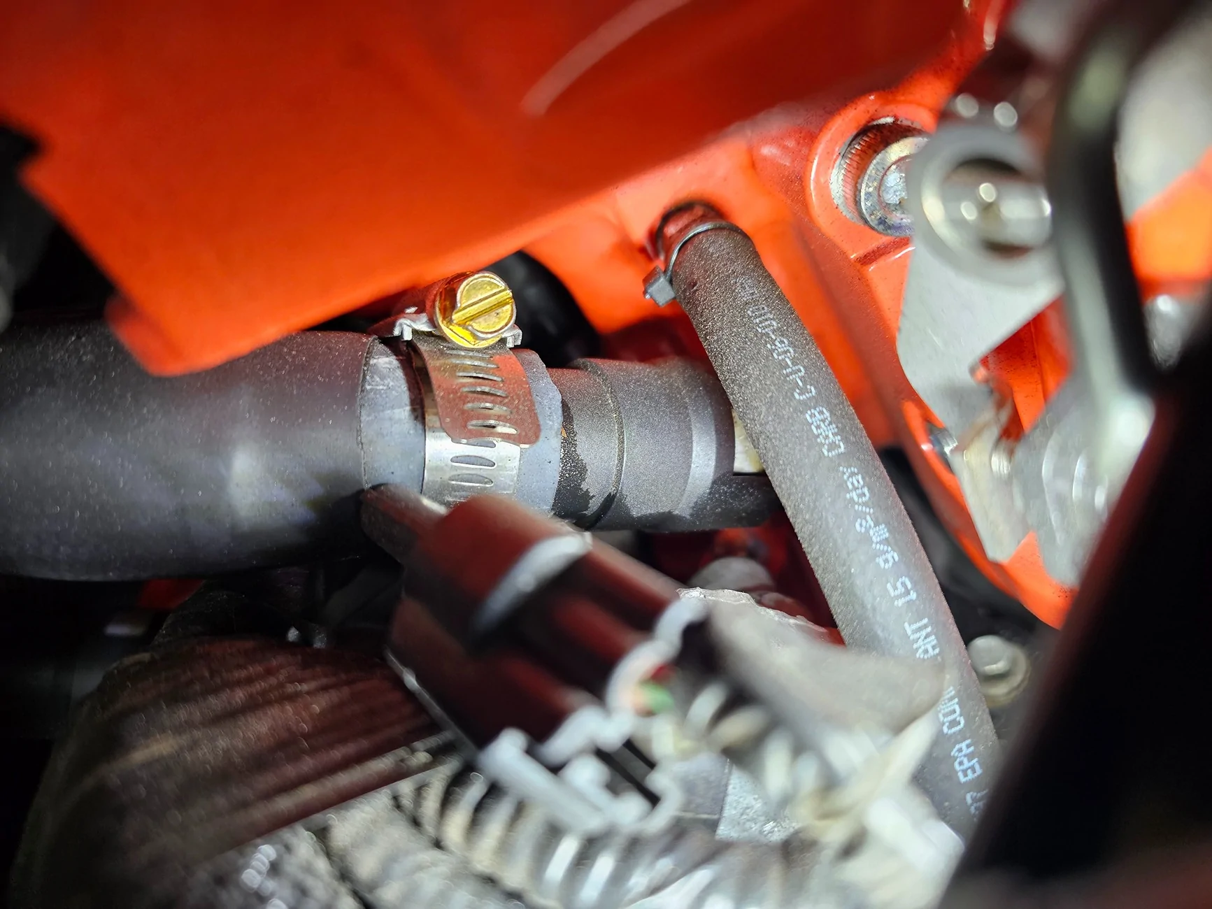

Just a follow-up from my side - I emailed Motion Raceworks and their adapter that replaces that tall coolant pipe on the passenger side is meant to be used if you're bypassing the heater core. The stock hose on that side has a restrictor fitting in it so it lowers pressure as coolant goes to the heater core.
So simply replacing that with some AN hose could risk damaging the heater core... Maybe an AN fitting to a hose barb could work in order to utilize most of the stock hose. Will have to think about it some more.

Whatever came of this?
I was looking at the Motion Raceworks to fix the setup on my whipple from leaking

I outlined what I did in this post here: CLICK ME
Been leak free and no problems at all.

I already have that straight fitting you referenced ( Dorman 800-411 ), it came with the Whipple. If I'm reading your post correctly, where I used the hose clamp in my picture, you used a Gates power grip?

Thanks, sucks I'll have to drain the coolant to fix it, but at least I'll feel more confident than the hose clamp.
