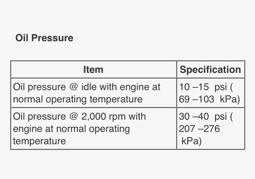

Hi guys,
Ford manual states 10-15 PSI once warmed for a 2018 mustang. I recently over filled my oil by .5 quart and drained some out. Once warmed I idle at 17ish PSI. Is this an issue indicating excess oil in the system and I should drain some more?
Thanks for advice

Oil PSI will change or "peg" based on multiple conditions.
High oil psi upon initial startup is normal in every vehicle. The oil viscosity is thicker due to it sitting and dependent upon exterior seasonal temps (whether in a a garage or not). The colder the engine block, the thicker the oil will be, then as it warms up viscosity changes (thins out).
Oil PSI in ANY engine is always dependent upon operating temps, oil viscosity and RPM.
The oil psi specs below is for a bone stock S550 Coyote 5.0 right from Ford:
That PSI info is also based upon the standard recommended oil for the 5.0 Coyote.
