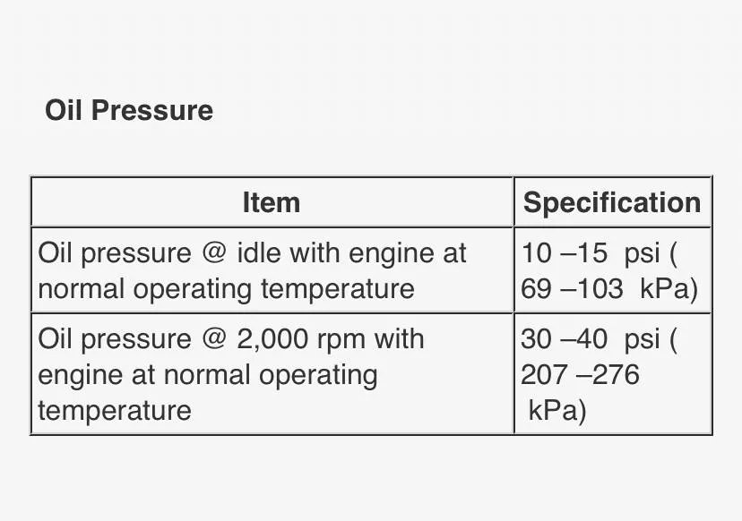

Oil PSI will change or "peg" based on multiple conditions.
High oil psi upon initial startup is normal in every vehicle. The oil viscosity is thicker due to it sitting and dependent upon exterior seasonal temps (whether in a a garage or not). The colder the engine block, the thicker the oil will be, then as it warms up viscosity changes (thins out).
Oil PSI in ANY engine is always dependent upon operating temps, oil viscosity and RPM.
The oil psi specs below is for a bone stock S550 Coyote 5.0 right from Ford:
That PSI info is also based upon the standard recommended oil for the 5.0 Coyote.
Here was an older thread regarding oil psi:
