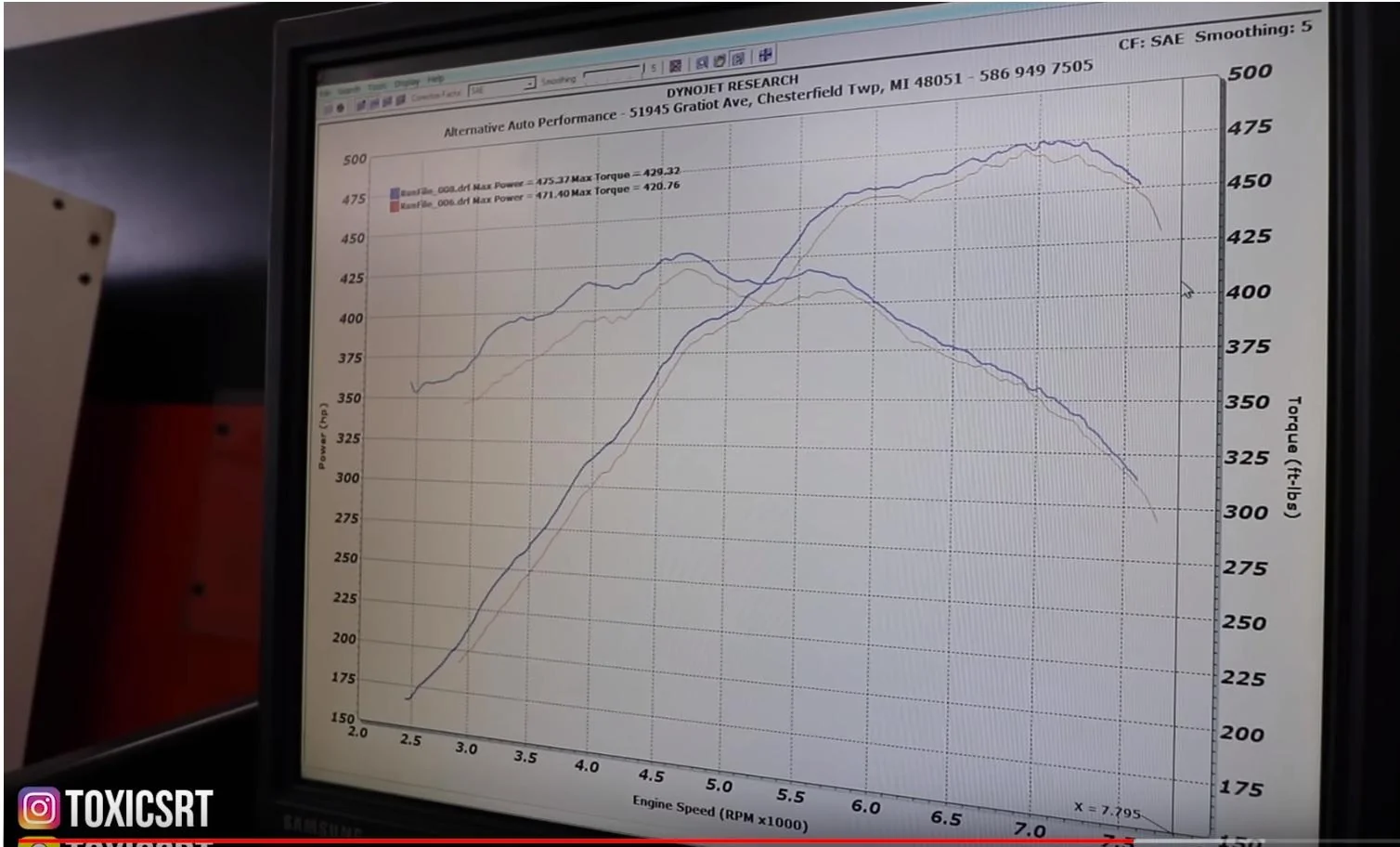

I had a tune that shifted at 7800 which I thought was a bit high since I could feel the power start to fall off near the shift. I have seen many dynographs with similar or the same mods as me (basically just an e85 tune) and it does look like peak power is almost always around 7000 rpm. Heres a pretty typical example.
My question is : using this dynograph what would the ideal shift points for every gear be? I think the ideal shift rpm would be higher in 1st and 2nd gear because they are a bit farther apart and RPM drops off more on the shifts, then lower for 3rd on up since they are closer together and peak power is around 7000 rpm. Is it possible to change shift points for individual gears?
The 10r80 ratios are 4.7, 2.99, 2.15, 1.8, 1.52, 1.28 1, .85, .69 and .64
Right now I am kind of thinking its like 7650 for 1-2 and 2-3 and 7500 or lower for the rest. Depending on how much torque actually helps on the 1-2 and 2-3.

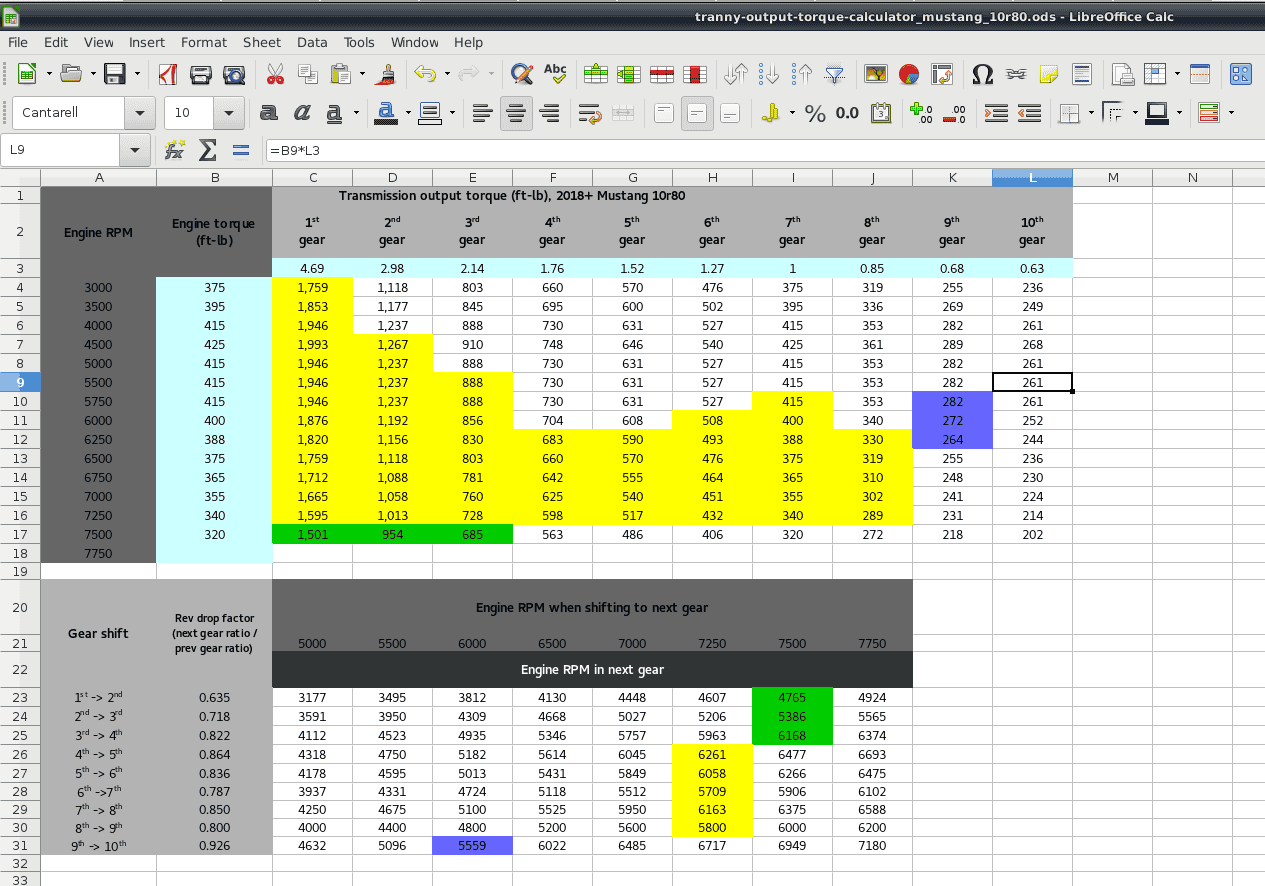

See if you can create a torque thrust graph from your dyno. That will tell you how much torque is being applied by the rear wheels in each gear. You can then tell where your thrust is at the top of your rpms, and where it will be when you shift, etc.

I made a spreadsheet more many, many years ago to showcase this. I'll see if I can find it and plot in the data from the torque curve from OP's post. Tbh, it looks to me as if the torque drops off a little too fast to fully take advantage of the high-revving gen3 engine, but let's see... be back with an update if I manage to find the document...

Here we go...
So the ideal shift point is at 7500ish RPM (maybe higher; can't tell from the blue RunFile) for 1st, 2nd and 3rd. 7250ish RPM after that because the torque drops off a tad too fast to make it worthwhile to wait till 7500. Then of course there's the 9th-10th shift but not really relevant...
