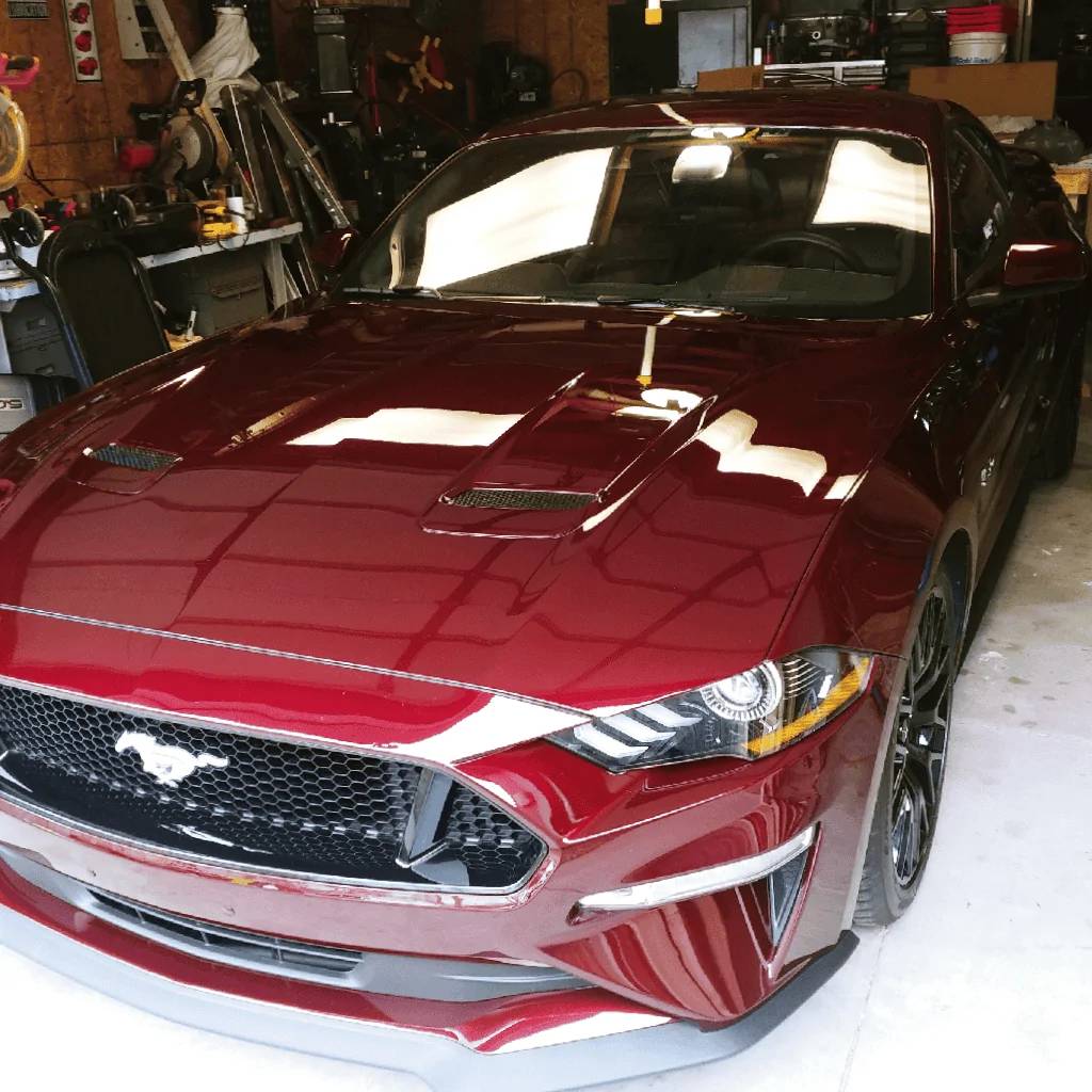

I need new ceramic coating.

Ok, sorry to you to. I guess it happens. Honestly hard water should not effect a quality ceramic coatings lifespan. Water spotting should also not really be an issue as water should be beading off your car pretty quickly. You should also be drying your car immediately after rinsing.
I would suggest have a pro look at it before adding anything more. Once you know what you have you can move forward.
Also part of the learning curve. Nowhere for shade and in direct sunlight in the heat. Looking at a car port or at least a pop up tent for those sunny days.
This is my first car i can afford to splurge on and is not a daily. Dad at 17 and two sons kept my pockets empty for a number of years. Had nice vehicles for the most part but never really cared outside of basic wash/wax. Now i can have a pleasure car and enjoy playing.
