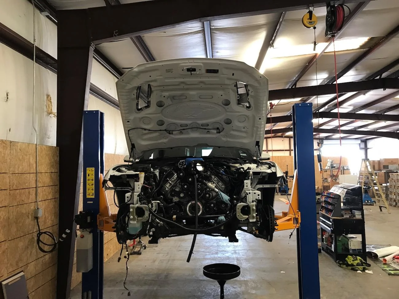

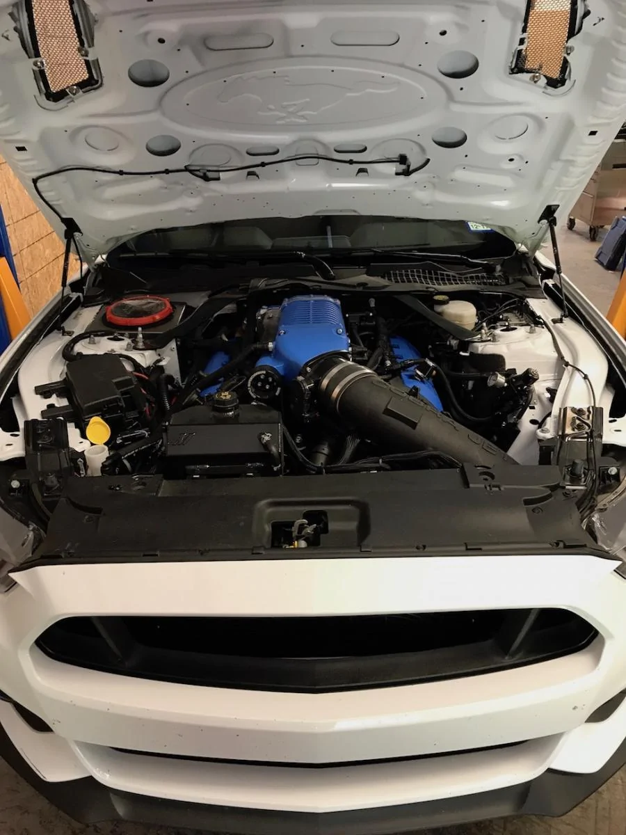

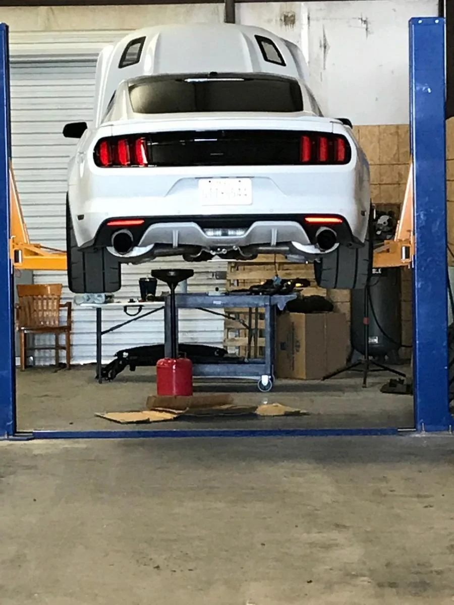

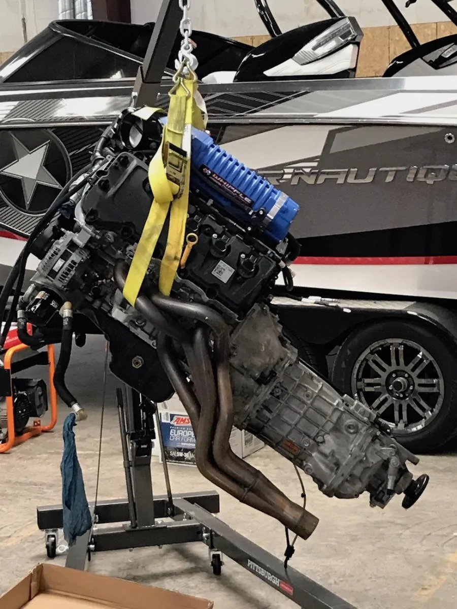

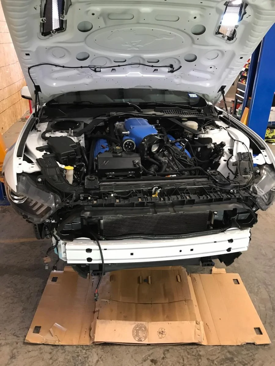

Started the teardown today. Took a few pics for the hell of it.
The oil is coming from the passenger side of the motor. Oil is seeping out for the header corsa connection. More updates tomorrow.

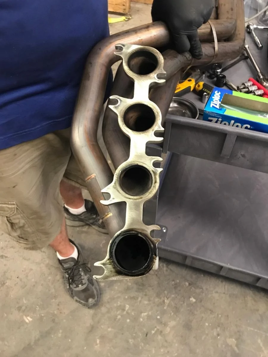

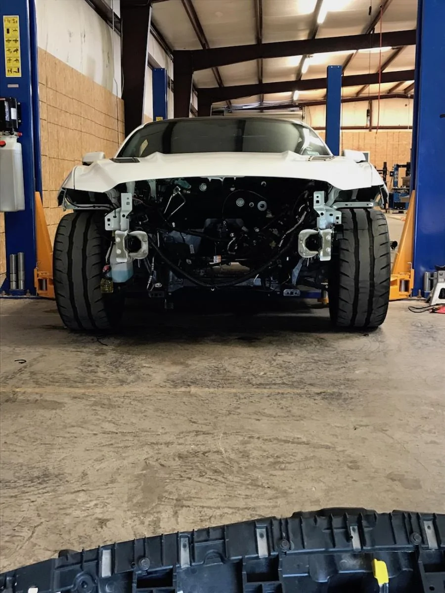

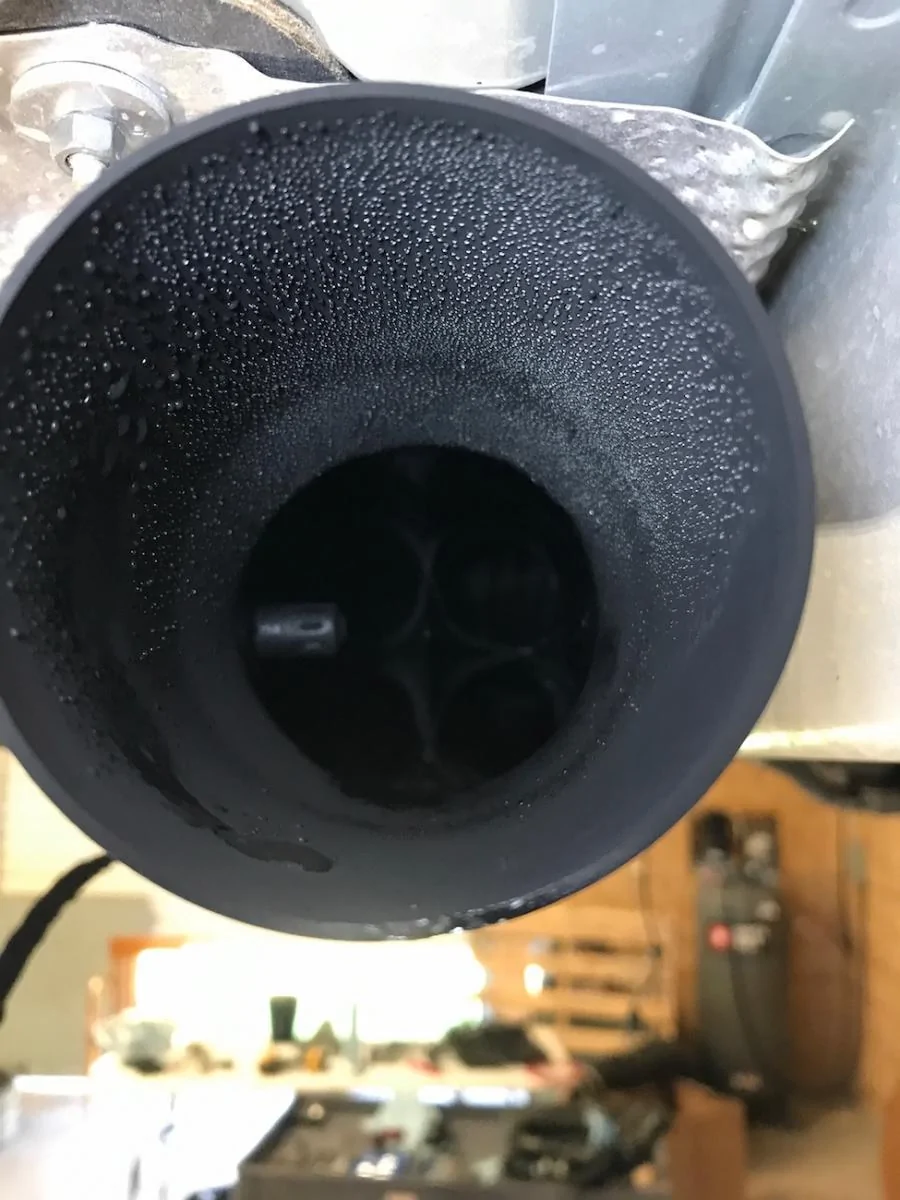

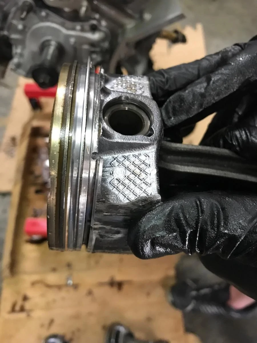

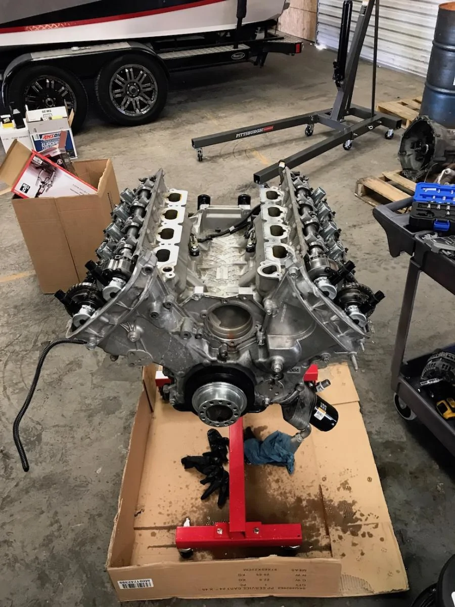

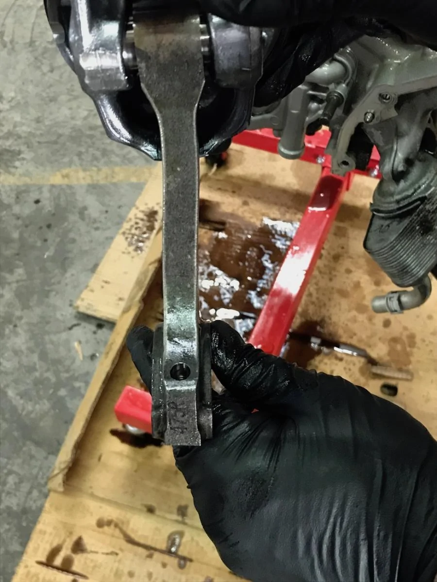

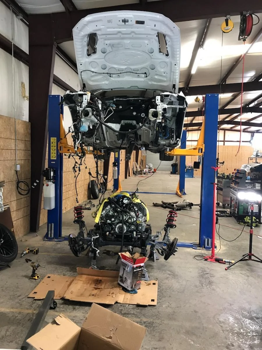

Got it all apart today and back to a rolling chassis. Plenty of pics for you guys. Gist of it is, 4 bent rods and blown out oil ring on number two.
Massive blowby on passenger side of motor.
I found dropping the k member to be the easiest way.
Oil in the header from number 2. First piston on passenger side

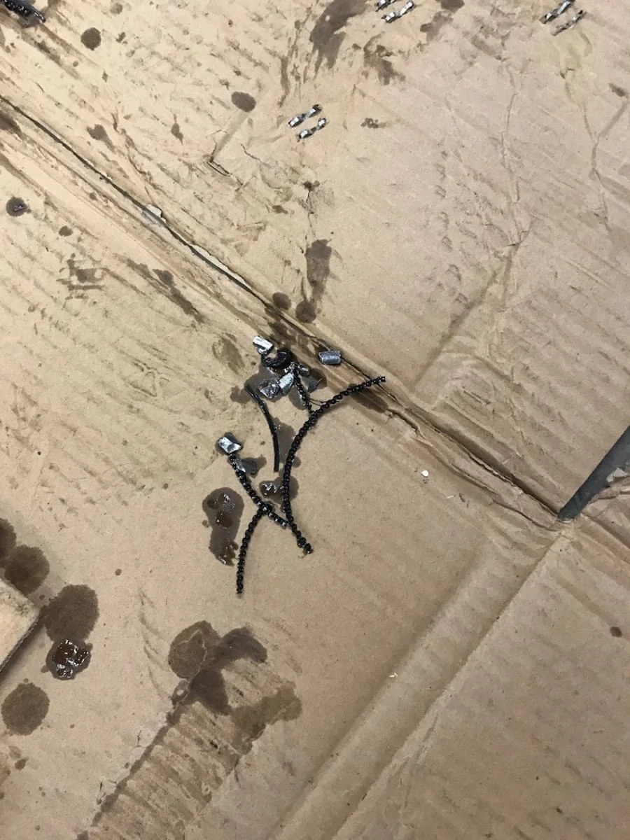

Debris in oil pan. Not as much as i expected.

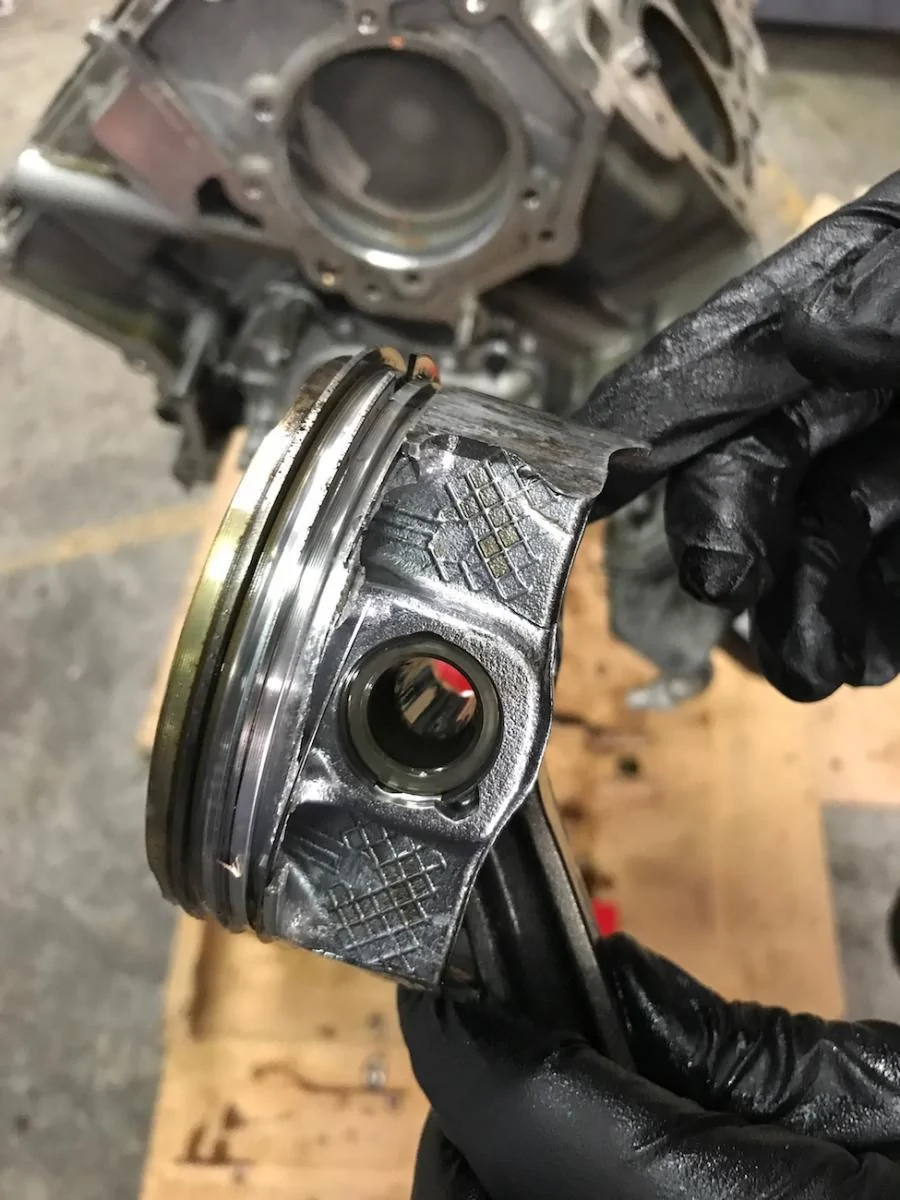

Number two rod
Number 2 piston

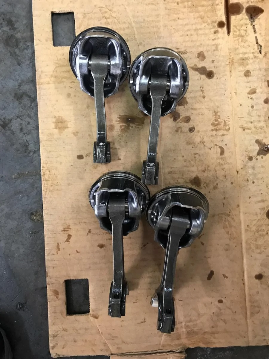

Numbers 1,2,4,8 Rods.
Back on the ground awaiting new build!

was the oil like a milkshake? four bent rods makes me wonder if the head lifted and put coolant in the cylinders?
jhatley7
jhatley7
Dec 18, 2015
1,150
390
2016 White GT PP, 2022 F350
Nope oil was good. No evidence of lifting the heads that i could tell. Hell the head gaskets looked perfect on both sides.
How are the heads
Perfect as far as I can tell. Well valves on number 2 are black lol.
