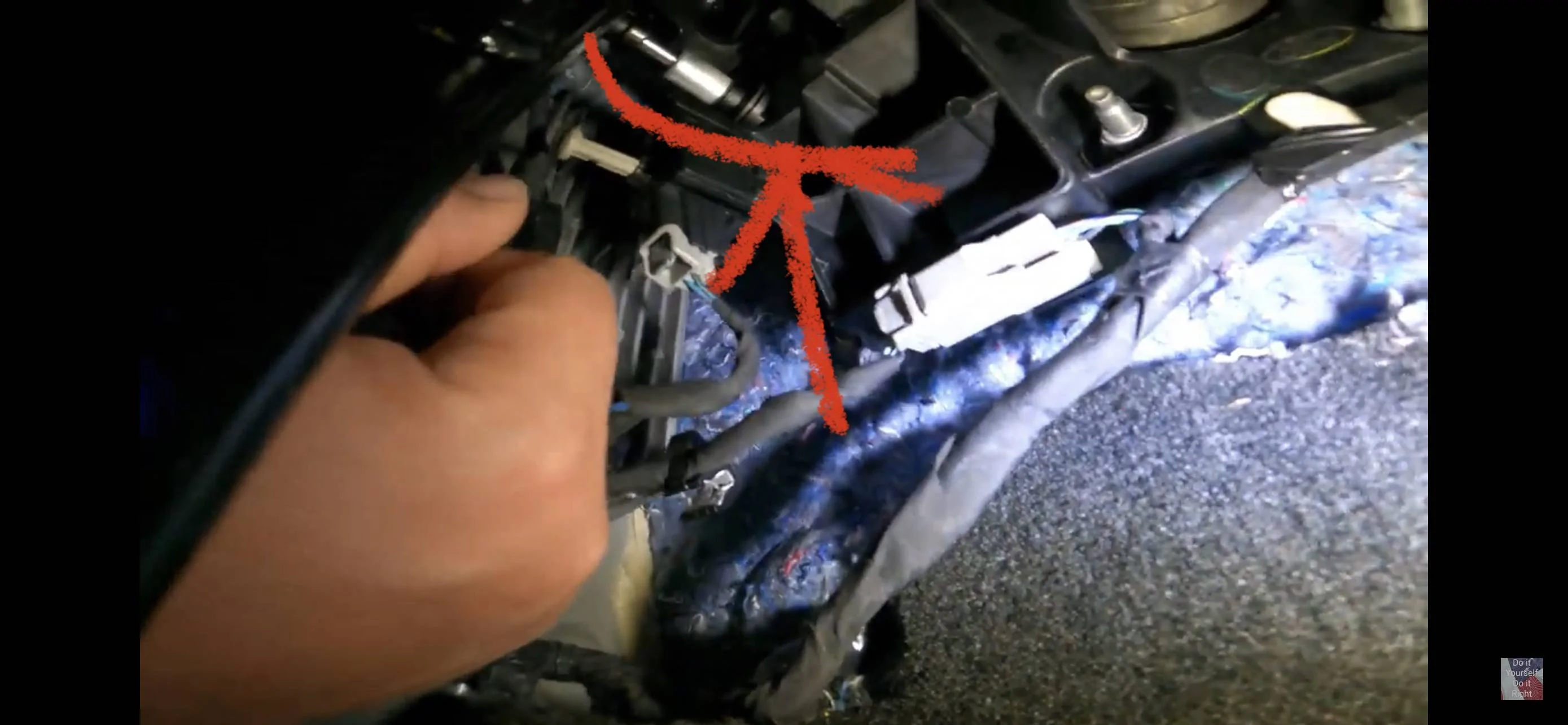

I just looked for how to replace the master on these cars. Yeah Ford has made it a huge PIA to do it. Literally you have to remove the seat and break/clutch pedals wiring pins to remove it. I like working on my cars. If it ever needs one it’s going to be painful 😂

That’s the master literally inside the cabin. Why? 😞

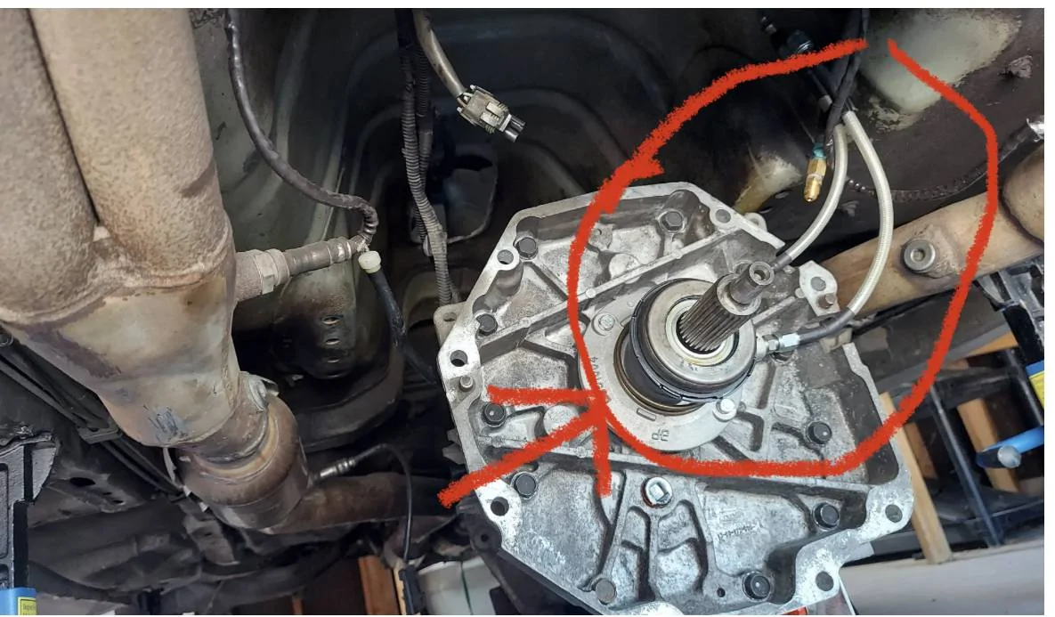

I thought as much. The pressure plate for stockers regardless of make are shitty for pressure. Also a better slave also helps with feels. Especially with bigger gauge braided lines. And a bleeder line which is always a must. This is what I put on my t56 for the GTO when I was putting the trans back on. It’s a doorman piece braided lines all in all a great piece of equipment.
